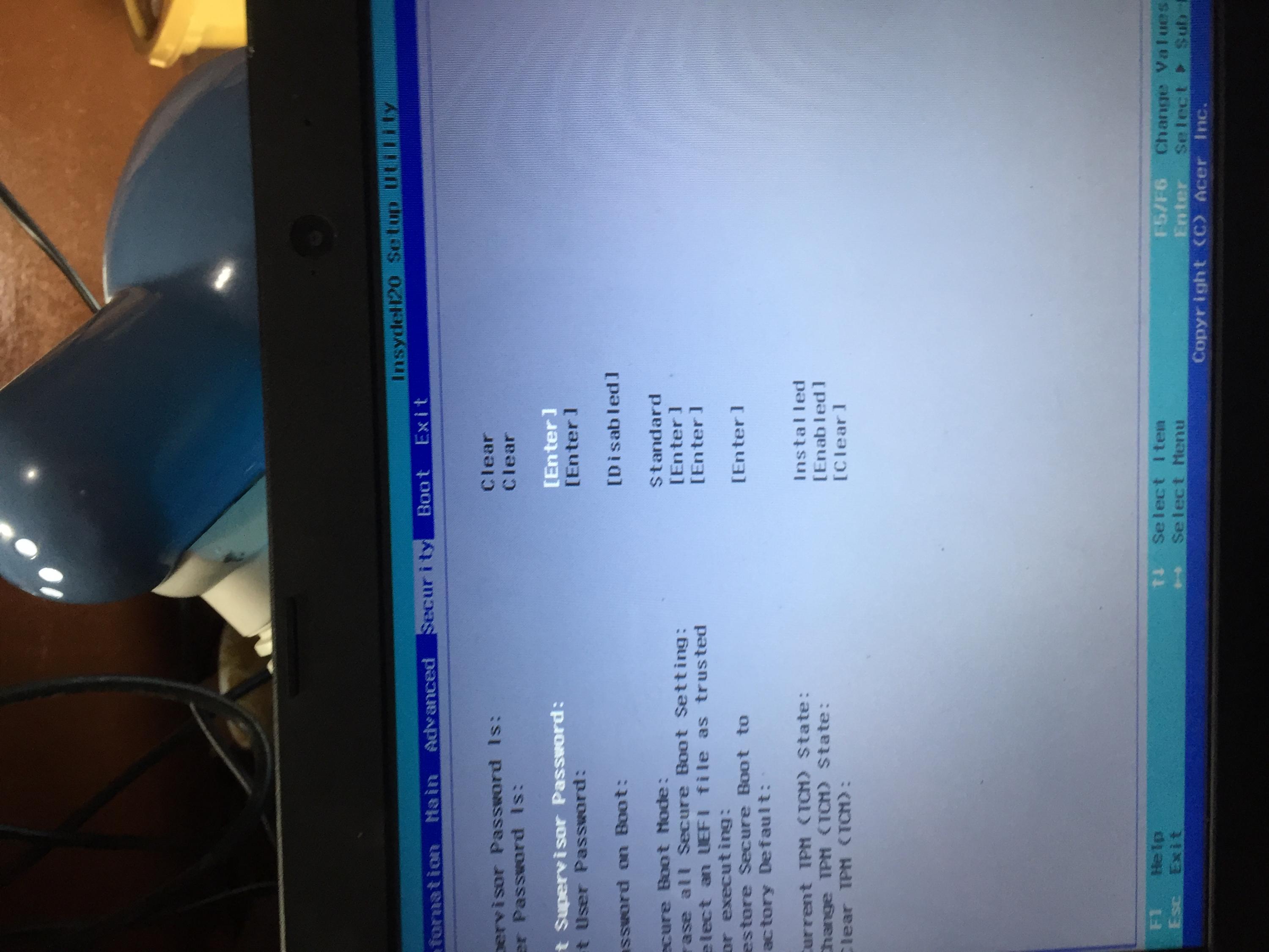

    I need a working bios on ACER A314-32 DA0Z8GMB8D0 REV MODEL: Z8G please! the problem stuck on acer logo then shuts down and restart. go to bios menu there is no option can enable UEFI AND LEGACY option.I have attached the original corrupted bios, can someone fix this please

      @peste i try your bios but still the same issue acer logo shows up then shuts off and restart, when i go to bios menu still no option to change uefi to legacy

            still the same issue secureboot on the bios menu cannot change

              anyone have a working bios on this the problem is turns on boots fine on acer logo then shuts off and restart but when i go to bios menu i cannot change the options on uefi to legacy it just disabled. here it is only showing

                The bios i posted was extracted from acer bios update. There shouldn`t be any problem. Try bios setting with and without the hard drive

                  already tried that without hard drive above picture showing

                      If you want to disable SecureBoot you may need to set a supervisor password and reboot. Or just leave it enabled and boot on an official Windows (7, 8 or 10 64-bit) media in UEFI mode.
                        True, on some Acer models including this one if you want to change SecureBoot option, supervisor password must be enabled first.

                          problem solved burning uefi flash drive thanks all for the help
