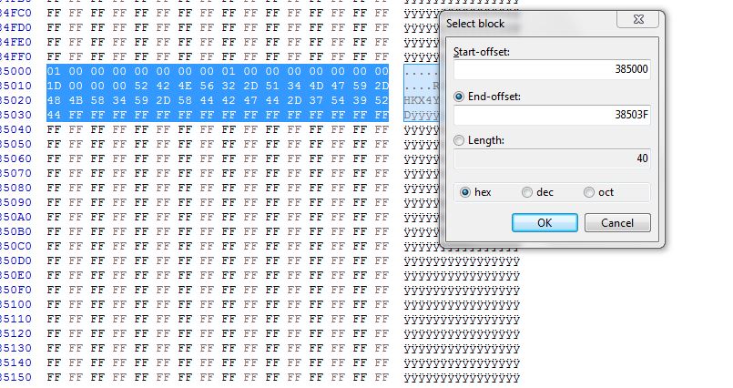

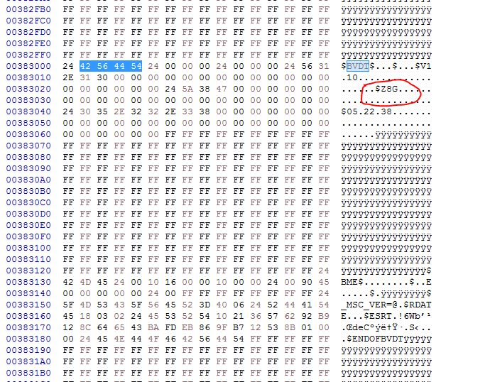

                        acer a314-32 p2qg
                        can someone fix this bios please it has no display taking 0.061amps , i would try bios first
                          • 20888
                          #32
                          Re: ACER A314-32 bios needed
                          Open your bios with a hex editor,search for the text BVDT ,just below you`ll see your bios is
                          Z8G.
                          Use the virgin bios at post #27 . Open the new and old bios in a hex editor,copy the win key from the old to new using the off-sets provided in the picture.
                          Hex Editor https://mh-nexus.de/en/downloads.php?product=HxD20
