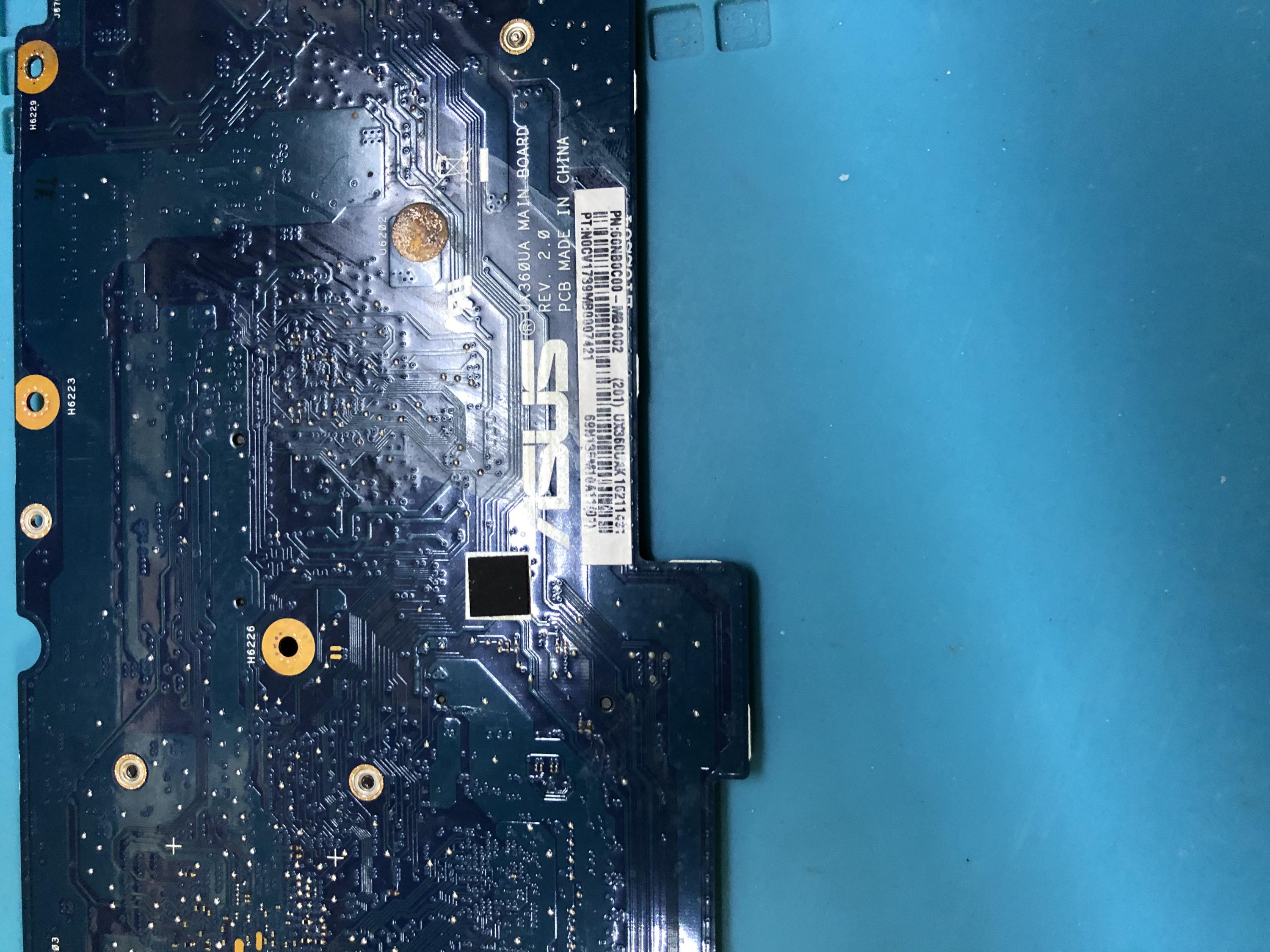

    So I've got this MB which when AC adapter is in, shows the charge and Power LED only, will not POST, no fan spin, nothing on LCD. Only draws 19mA @ 19V in this condition
    I've pulled the BIOS from the 25Q64FVS chip. Can someone take a look at it and see if it looks OK?
    Does anyone have a .bin for this MB (UX360UA Rev 2.0)

    Re: Asus UX360UA Bios
    try...
    https://www.badcaps.net/forum/showthread.php?t=78829
      Working! 10/07/2023
      I flash this BIOS on my Password-Locked Asus UX360U and works flawlessly
