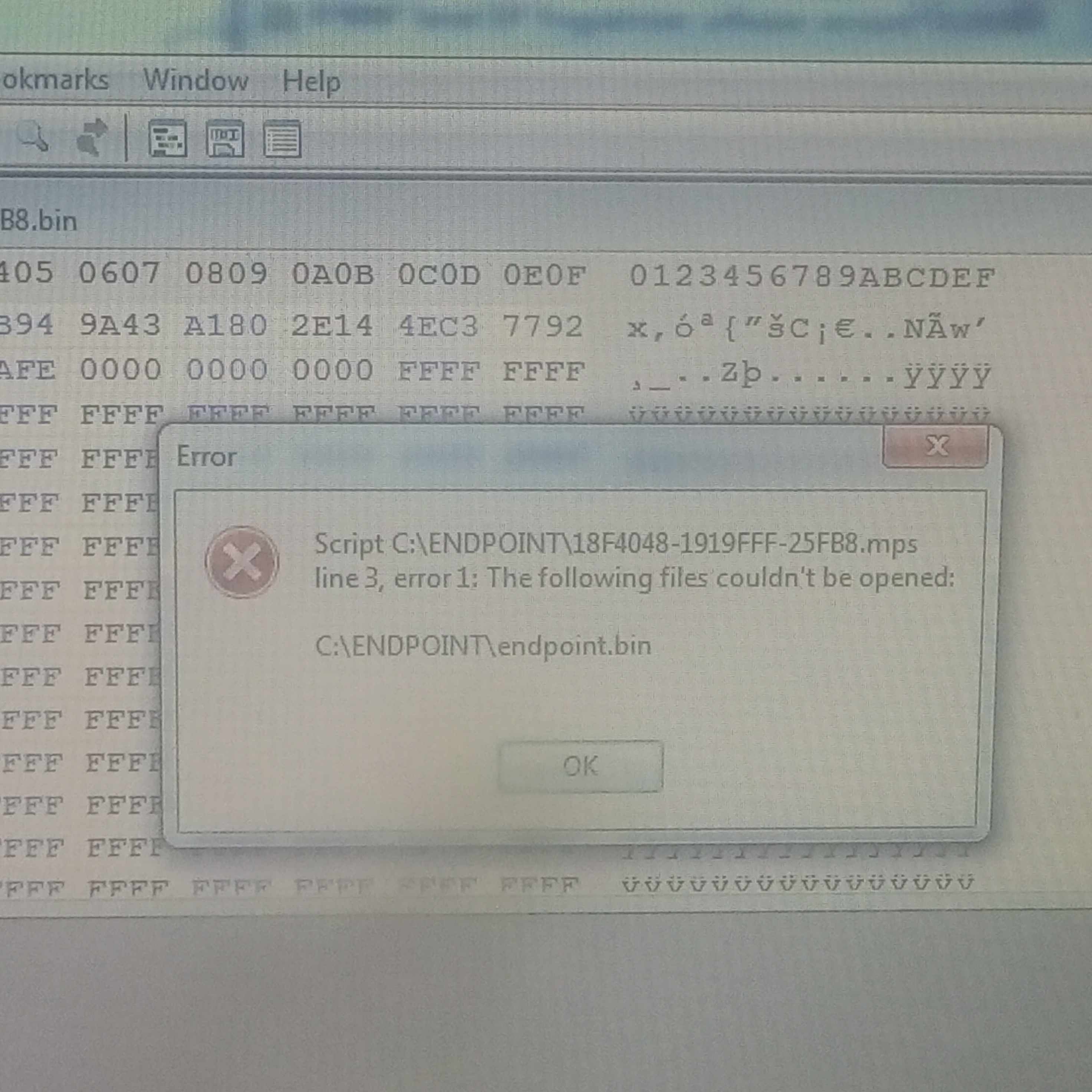

                                  I have another problem with 840 g5
                                  When I received the system there's no sign of power when you press the power button, but when you plug the charger it will flash light on the LED and then off immediately, after checking all the power rails I didn't find any problem, so I decided to program the bios, after programming the main chip the LED light began to blink amber and white steady still no power, then I programmed the EC the system powered and display but there's end point security error message.
                                  I need an assistant to help me clean the original bin and the EC if it's possible i will attach the original bin here
                                  Hp EliteBook 840 G6
                                  S/N 2TK94401G1
                                  P/N 6050A3022501-MB-A01

                                      #640
                                      Hp EliteBook 840 G6
                                      S/N 2TK94401G1
                                      this is error i get when i run script
                                        SMDFlea commented
                                        Editing a comment
                                        it is looking for bios which should be renamed endpoint.bin
