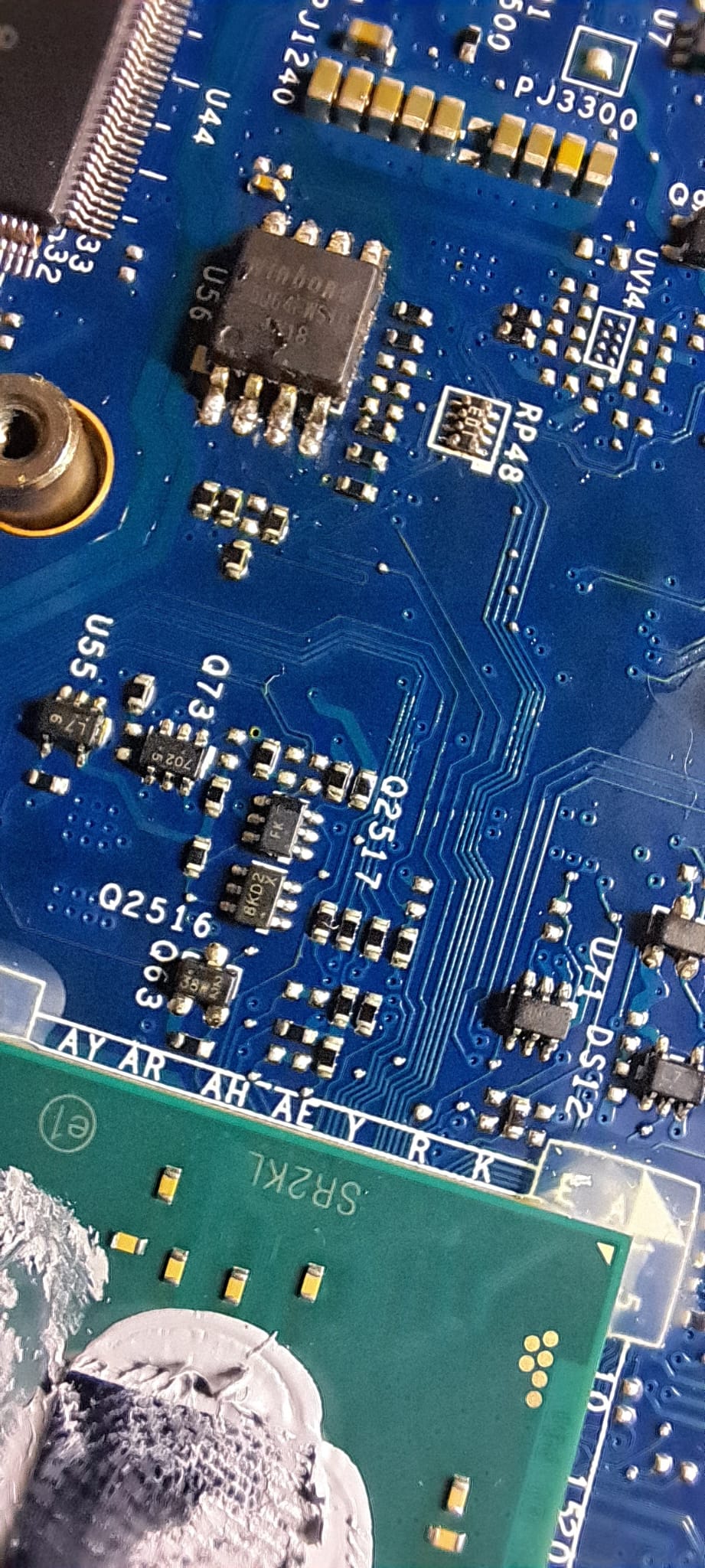

    Hey guys, my friend did a win 10 upgrade today,and laptop restarted and doesn't work anymore...
    So he brought it to me, i tried flashing all the dumps that are here on the forum, like 10 of them..none work, all i get is fan spinning and white led turns on for a few seconds,then goes down and turns back up again...
    Is the KBC dead?I tried different ram,usb gets power for a few seconds too,but doesn't boot with win+b or win+v...i don't have original dump, i forgot to save it
    I measured the voltages, all are present except for GPU,maybe that comes later in the sequence,CPU gets 1.05V,ram 1.35V, 3.3V and 5V are present...
    the model is hp 15-bs038nm,board is LA-E811P.
    WTH is happening with HP and assistant?Why did it brick the laptop??

            #85
            Re: Need bios LA-E811P
            ok, so friend actually was smart enough and saved the original bios, he forgot to mention it to me,i thought that after win update that happened, and he didn't mention that he actually tried to flash the bios via the ch341...but what he had told me is that he used ch341 without 1.8V adapter,and i don't know how did he manage to connect and read the dump... And to make the matter worse,he used a clip and sent 3.3V to 1.8V power line...
            i did measure the chip supply and it still has 1.8V on the motherboard, he fried the chip probably, but i used another chip and still didn't work..
            so here is the original dump after failed win 10 upgrade.
            @lapfix- i unfortunately don't have the EC programmer...they are to expensive for me...

              • huzo
                • Sep 2014
                • 190
                • CROATIA
                #87
                i did try all of them already, but i will try 0832d later when i get home with new chip...the one i used for replacement is winbond 25Q64FWSIG and i do have 1.8V adapter...maybe this one is also faulty since it's from a donor board...
                but it's odd when i flash i always verify the chip and it says chip and memory are the same...i use neo programmer...so if the programmer says it's verified i trust it is...i could read from chip again and save what's in the chip and compare with dump programmed and see if there are any differences..
                • huzo
                  • Sep 2014
                  • 190
                  • CROATIA
                  #88
                  So i got to the cocnlusion that 3.3V went to the processor trough 10K ohm resistor array and something got fried...
                  I tried 3 different chips, it doesn't work, i started the laptop without the chip it acts the same, so it doesn't recognize the chip...
                  Data lines go directly from chip to the processors and the board became a donor...
