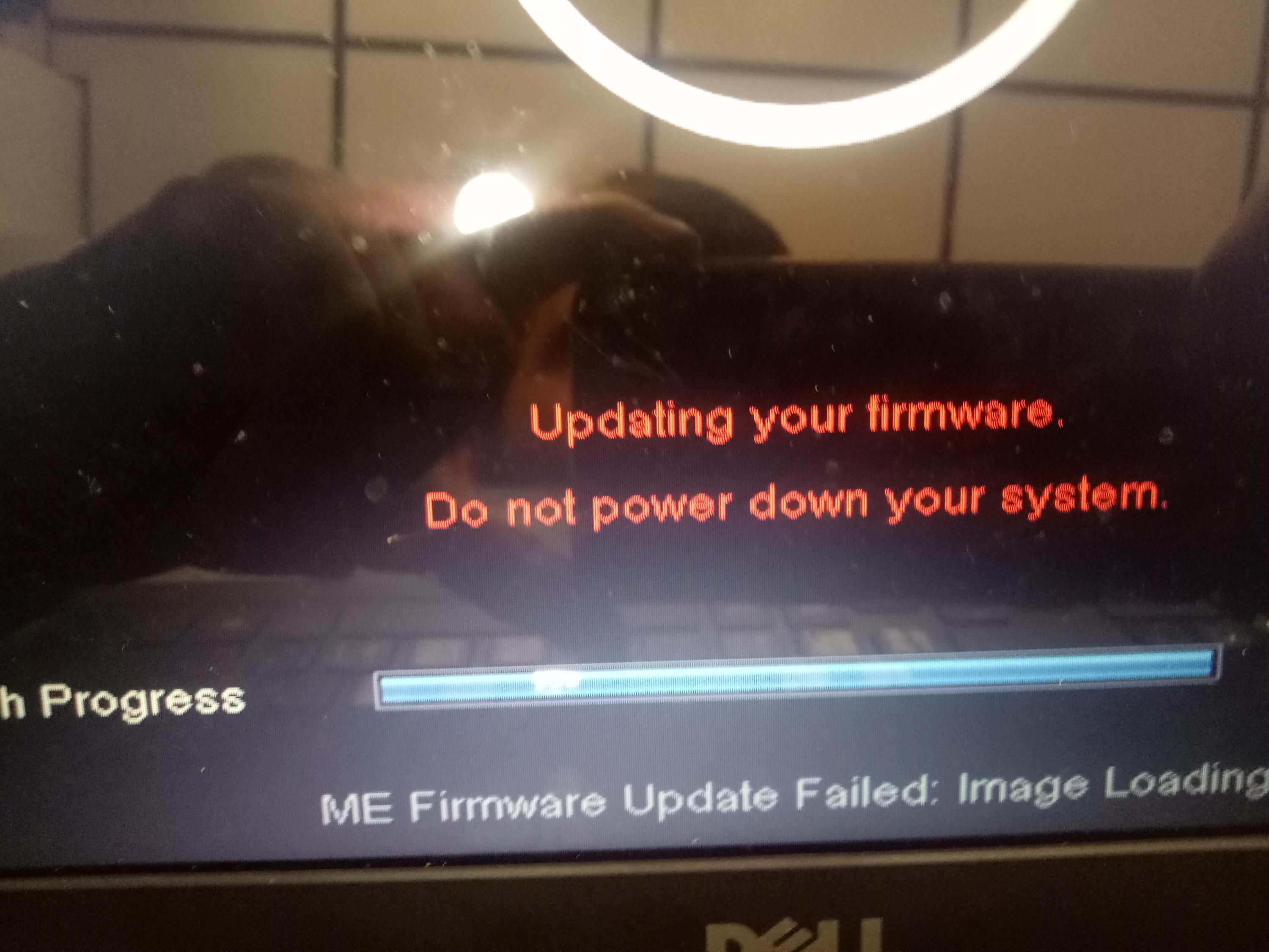

I believe that the problem is ME FIREMWARE, it dONT want to update
I wanted to update the bios under windows and I received the message "ME firemware update failed"
Any solution?

What is your service tag number .

My original tag is:
4PLW2F2
Now i have an other is:
10S2ZD2

Try my file its work 100%.....

This one is latest clean ME firmware and bios ver 2.10.0 .This has no AMT the same as your service tag config.The bios by @imranromi has AMT enabled.

Thank you my Dear
it's work 100%
