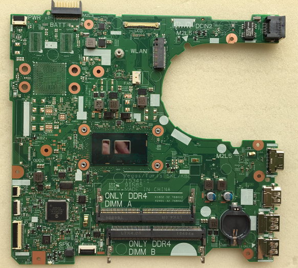

          Dell inspiron 15-3567 mec1404-nu kbc dump
          Friends, i need kbc dump. Please upload if anyone one of you have it.
          MB: Vegas/Turis Skl/KBL 15341-1
          KBC:MEC1404-NU
          I have 3/5v alw. There is 3v on power switch also but its not even switching. I hace tried CMOS reset and flashing main bios-16mb. Want to try KBC dump.

                Thanks for responding. I've tried 16mb dumps from many forums but it doesnt worked. battery charging led also comes on-so its not a failure on very early stage. Thats why i wanted to flash kbc.

                    Imranromi, Have a look at the backup i got from kbc mec1404. It shows 192kb. On internet , i searched alot as well going thruough the datasheet of mec1404-i dont think so there is anything to flash on this kbc(thanks smdflea for pointers to a particular forum). This is what is written in datasheet---
                    MICROCHIP says that in mec1404 there is no FLASH memory.
                    When the signal is removed, the bootloader is started and the code is drawn into the SRAM (RAM)
                    There is nothing to stitch in it. Look for the problem on the spot. Another cartoon can be stupidly removed and dead.
                    Soldering ...
                    1.1 Boot ROM The
                    following is the release of the EC_PROC_RESET # signal, the processor will start executing code in the Boot ROM. The
                    Boot ROM executes the SPI Flash Loader, which downloads User Code from an external SPI
                    . Upon completion, the Boot ROM jumps into the User Code and starts executing.
                    Internal Memory:
                    Boot Rom
                    32kb data optimized Sram
                    Code optimised SRAM options from 96kb to 160kb
                    64bytes battery powered SRAM
                    So i too think there is nothing to flash. Its all about bootloader. I dont know how to fix that.
                    • Sojke
                      • Apr 2017
                      • 131
                      • Serbia
                      Re: Dell inspiron 15-3567 mec1404-nu kbc dump
                      Did you check power good signals?

                                  Dell Vegas/Turis SKL/KBL 15341-1/91N85 Bios
                                  Hy all friend ....I have this motherboard, (Dell /7th Generation) ddr 4 ram.
                                  Problem : no power
                                  When I plugged in adapter its led glow white color in 2 second....then nothing happens ....all on voltage are present :- switch 3.3v, 3.3v/5v always / 1.0volt/ 1.8volt.
                                  its have 3.3v rtc/rtcrst voltage. no short on coil ...
                                  its not have crystal frequency.....I checked with oscilloscope
                                  I flashed bios from another site then its power on 1 time
                                  I upload original bios.............can any one help me
