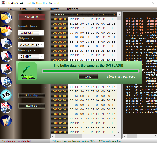

        I have now flashed this bios file.
        It does not turn on, but now it power cycles having on periode for 3 seconds.
        Before this is power cycled a very short on periode every 5 secs.
        If I upload my bios dump, could anybody help me fixing the flash bin?

                    I flashed this "last one":
                    Stil power cycling. And it does not react on power button. Cannot turn it off.
                    If you can do the same thing with this bios:
                    W25Q64_20161231_45833.BIN.zip
                    https://www.badcaps.net/forum/attach...5&d=1569420055
                    Maybe it could kick it to run.

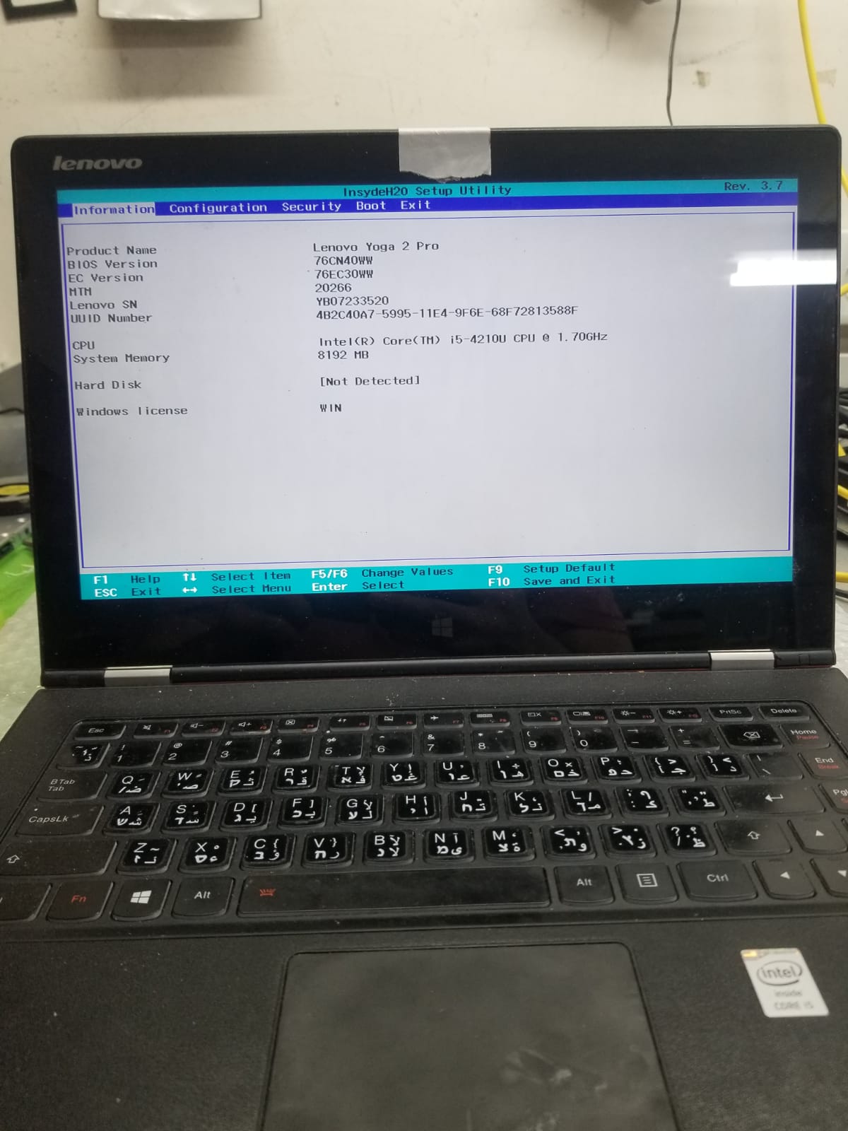

                        Hi
                        I can confirm that this bios is working fine.
                        Thank you for sharing

                              Re: Need BIOS - Lenovo Yoga 2 Pro 20266 EBKN7
                              Originally posted by peste
                              try..
                              Thank you Bro , Success
                              Attached

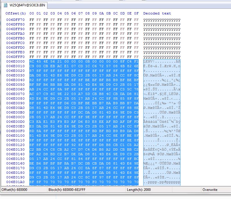

                                      The DMI is encrypted.You can copy it from your old bios to the new one with a hex editor.Search for the word LENV
                                      The offsets are 6E0000 - 6E1FFF (length 2000) .Copy it,and add it to the new bios using the same offsets (there are 2 LENV areas,both are empty in the virgin bios)
                                      If you don`t know how to use a hex editor theres a guide you can get some practice with - https://www.badcaps.net/forum/showthread.php?t=98038
