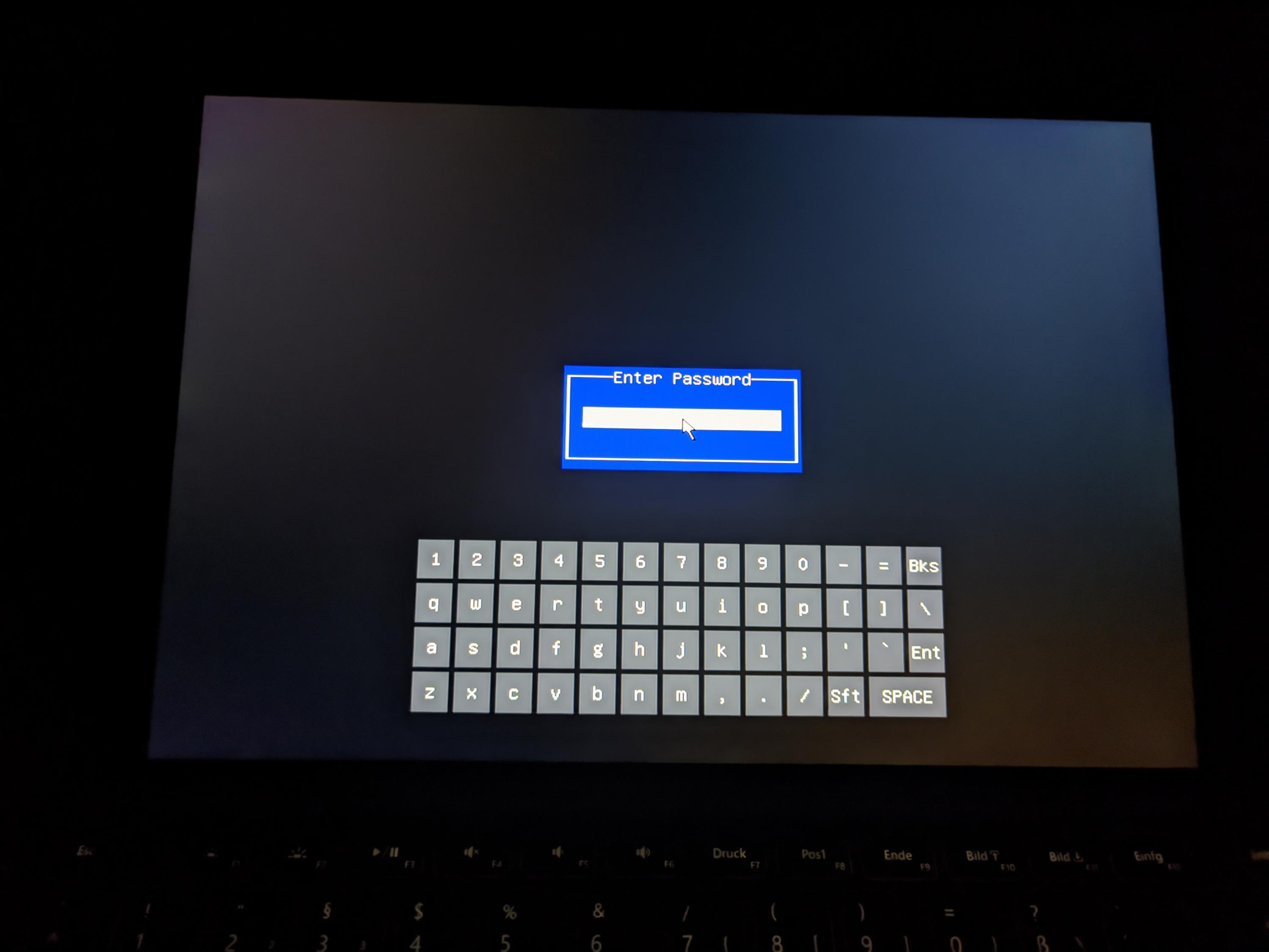

                        Hey Guys!
                        I have forgotten my UEFI Password on my Surface 3 Pro too and have often tried to recover or bypass it but always failed.
                        I have set the booting order to SSD only and have locked the Bios with an Administrator Password which I can't remember.
                        Now it seems as you have found a method to get it working!
                        Could you please help me?
                        I have some understanding of Computers and if you can give me a step by step explanation what I have to do I can upload the UEFI bin file and you can extract the password out of that? or what can I do?
                        thank you very much in advance.
                        greetings from Germany
                        Flo

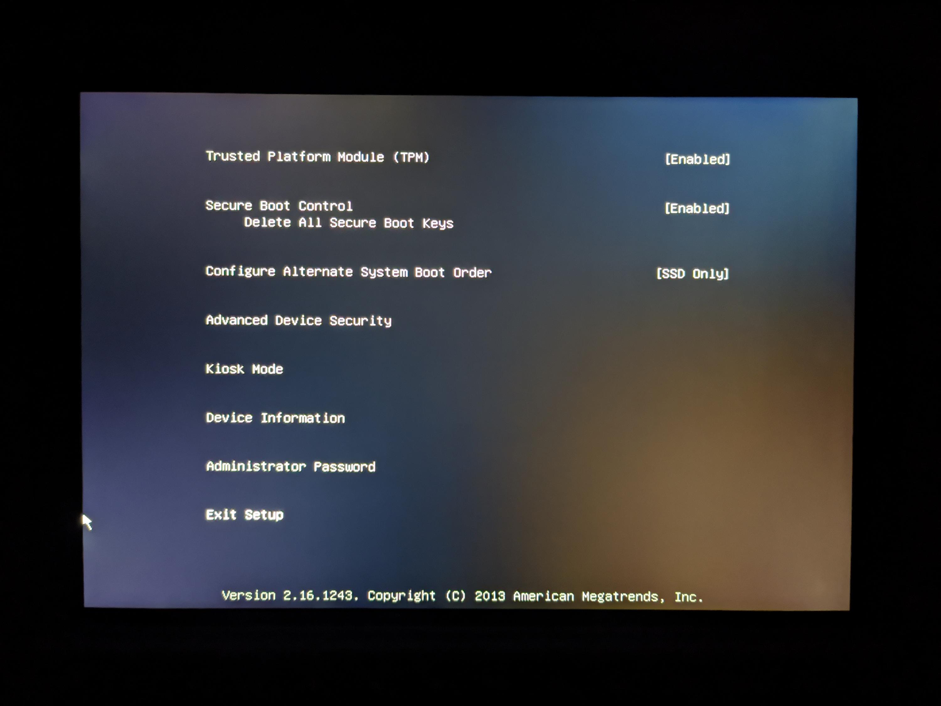

                            #33
                            Re: Microsoft Surface Pro 3 UEFI password
                            When I enter the Bios (by pressing and holding volume down when starting the surface) I am prompted to enter the admin pass(which I don't remember). When I hit enter without typing anything I can see the Bios (but can't change anything) and at the bottom it reads:
                            Version 2.6.1243. Copyright (C) 2013 American Megatrends, Inc.
                            for further Infos See the pictures
                            I hope that was what you asked for
