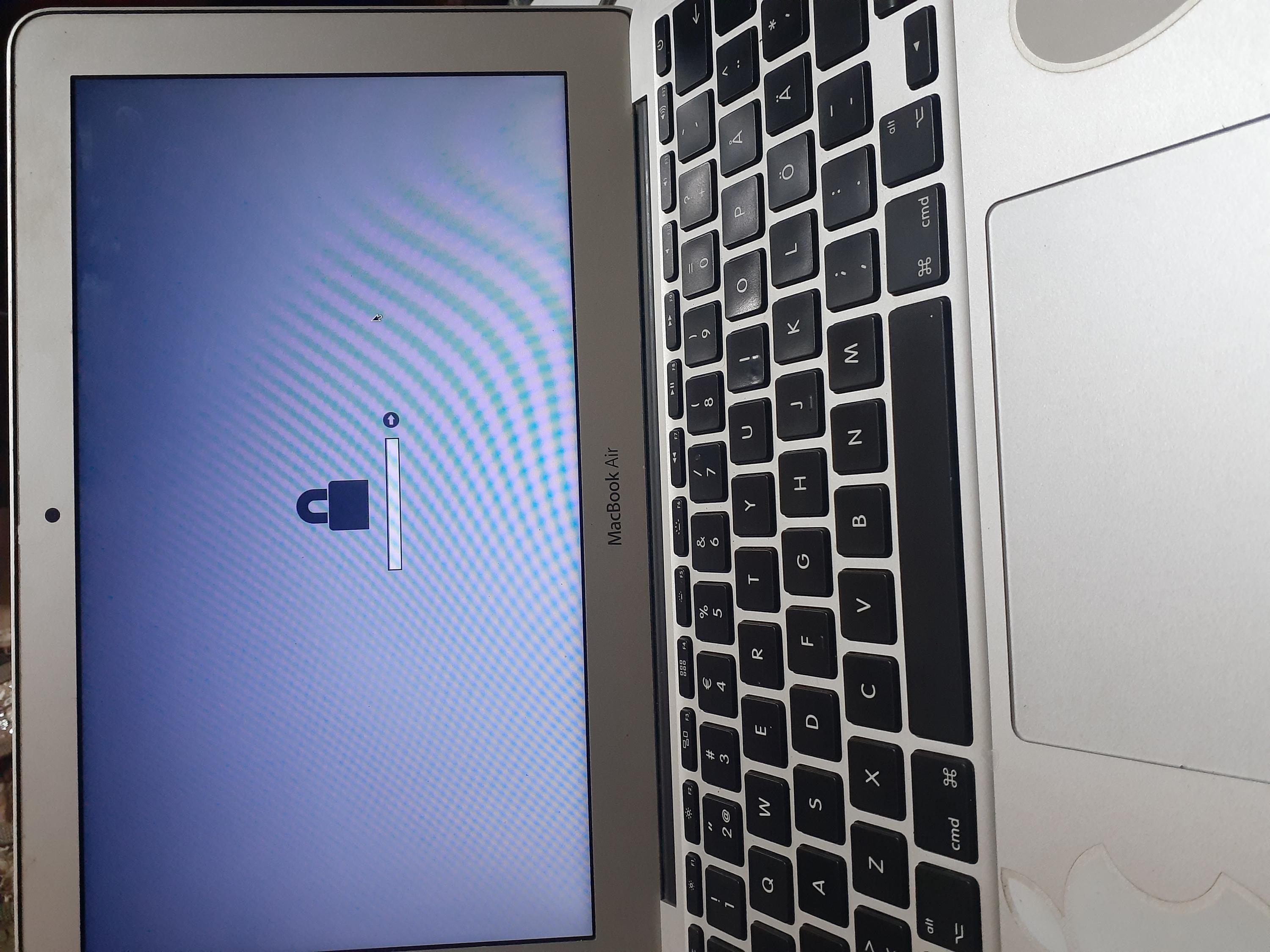

            AFTER pressing cod+r this comes up
              Re: macbook air user password
              hi there as the picture its not a user password its firmware password
              so you can remove it if you have a spi flash programmer and skill for some editing binary

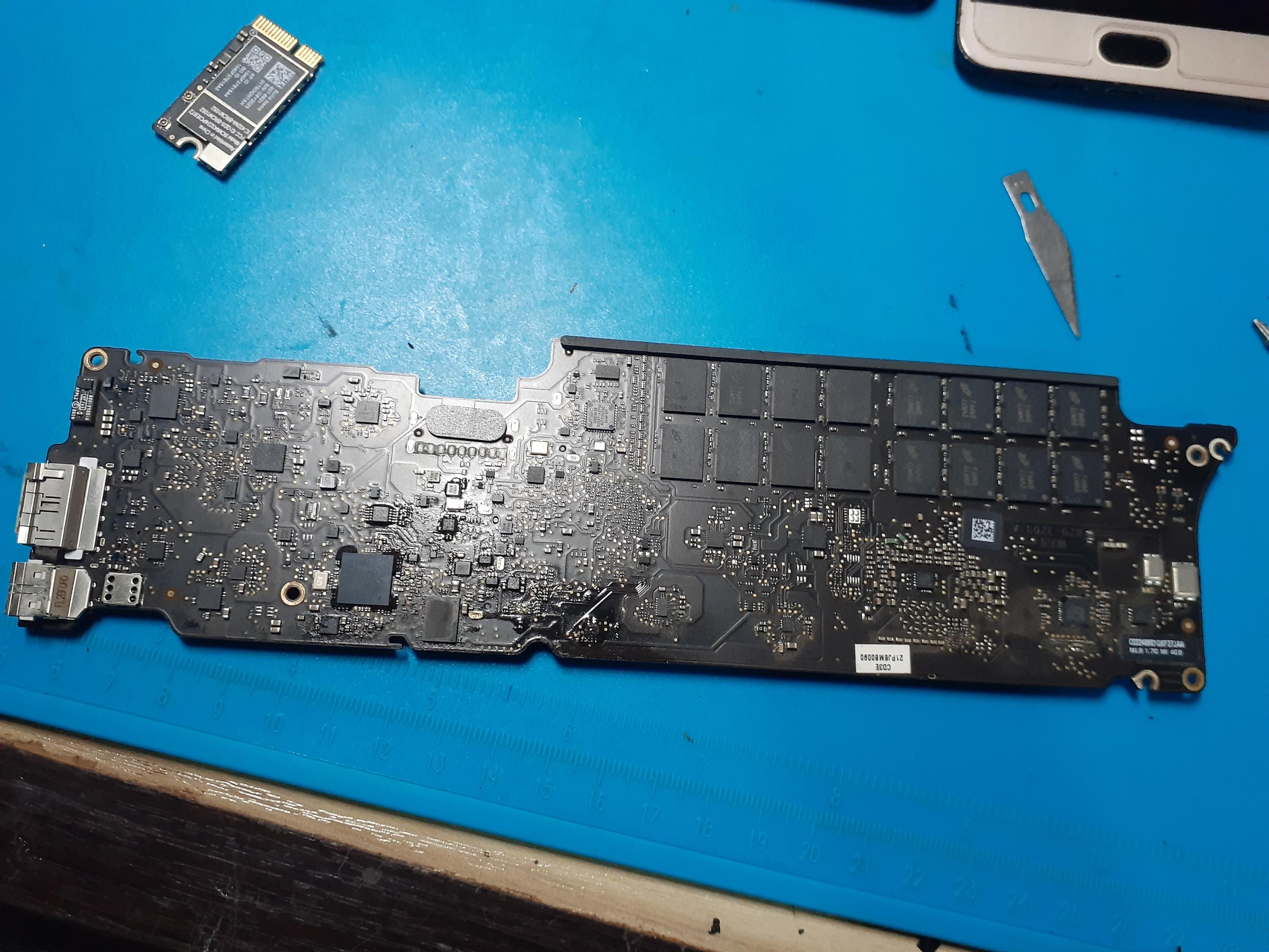

                    this is pix of the macbook air with me , plz i need to remove bios code

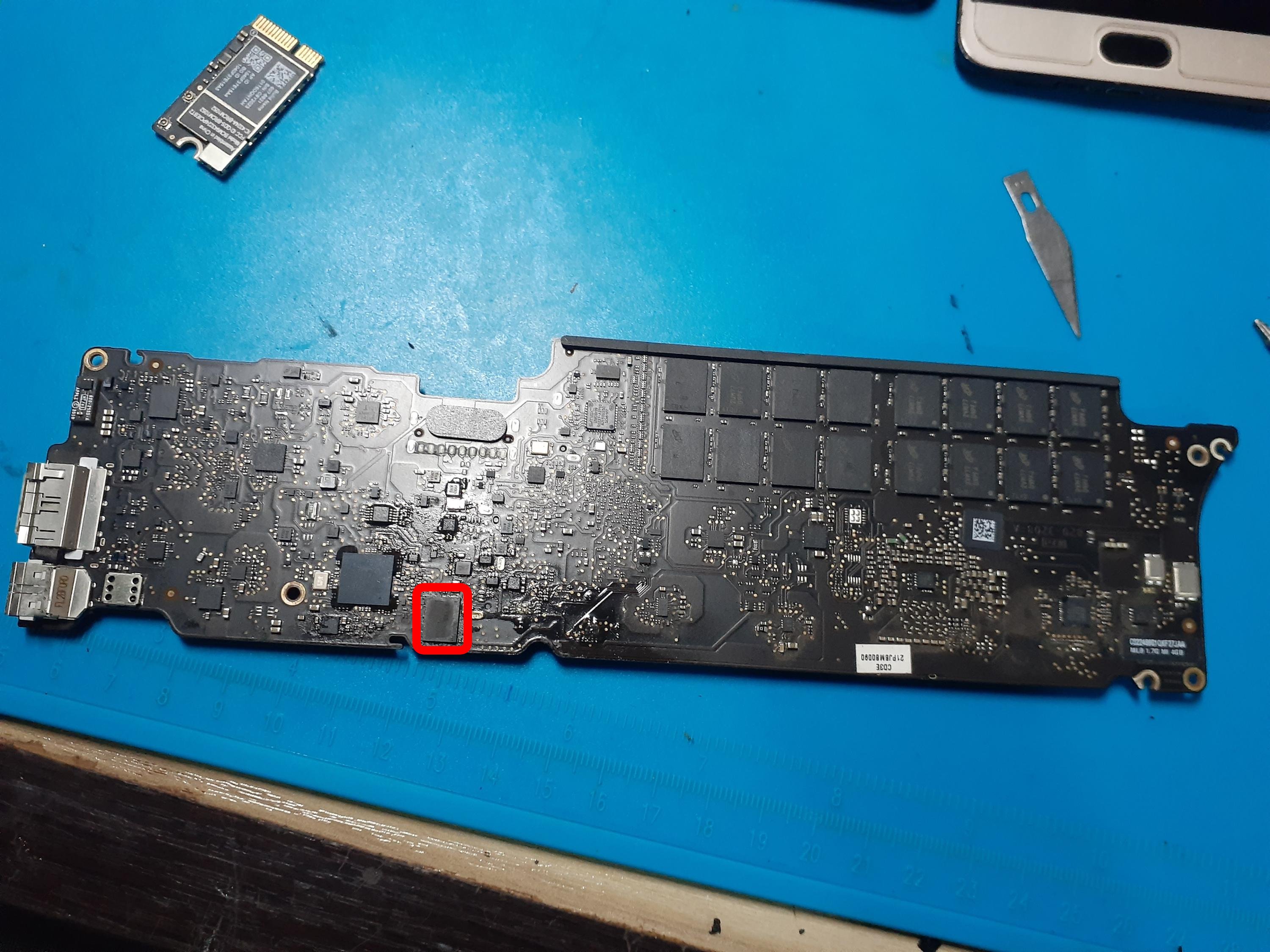

                      So it's an 820-3208. Please answer the question properly next time, it'll save everyone's time.
                      See attached picture for SPI ROM location.

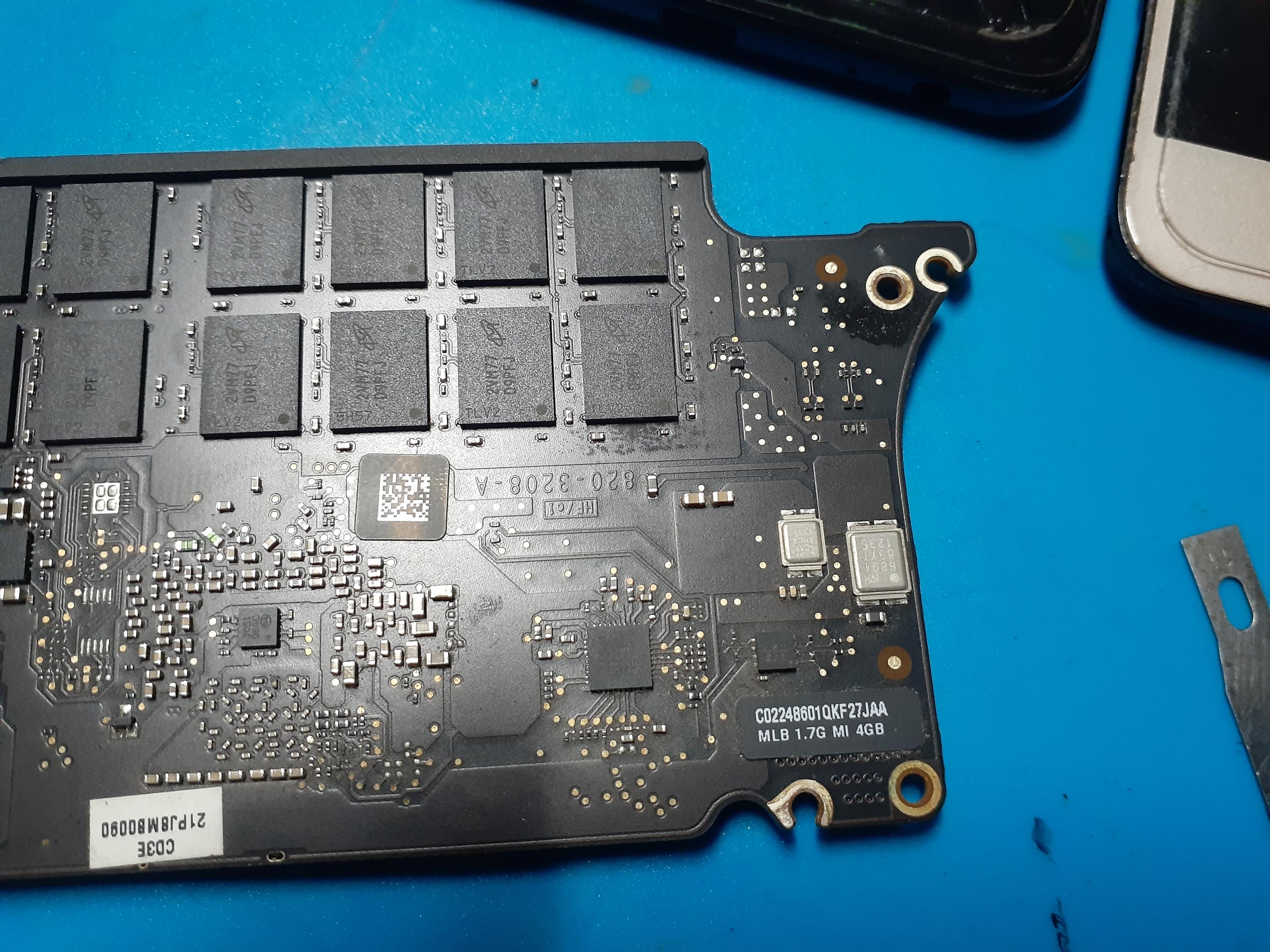

                        This is my BACKUP PLZ

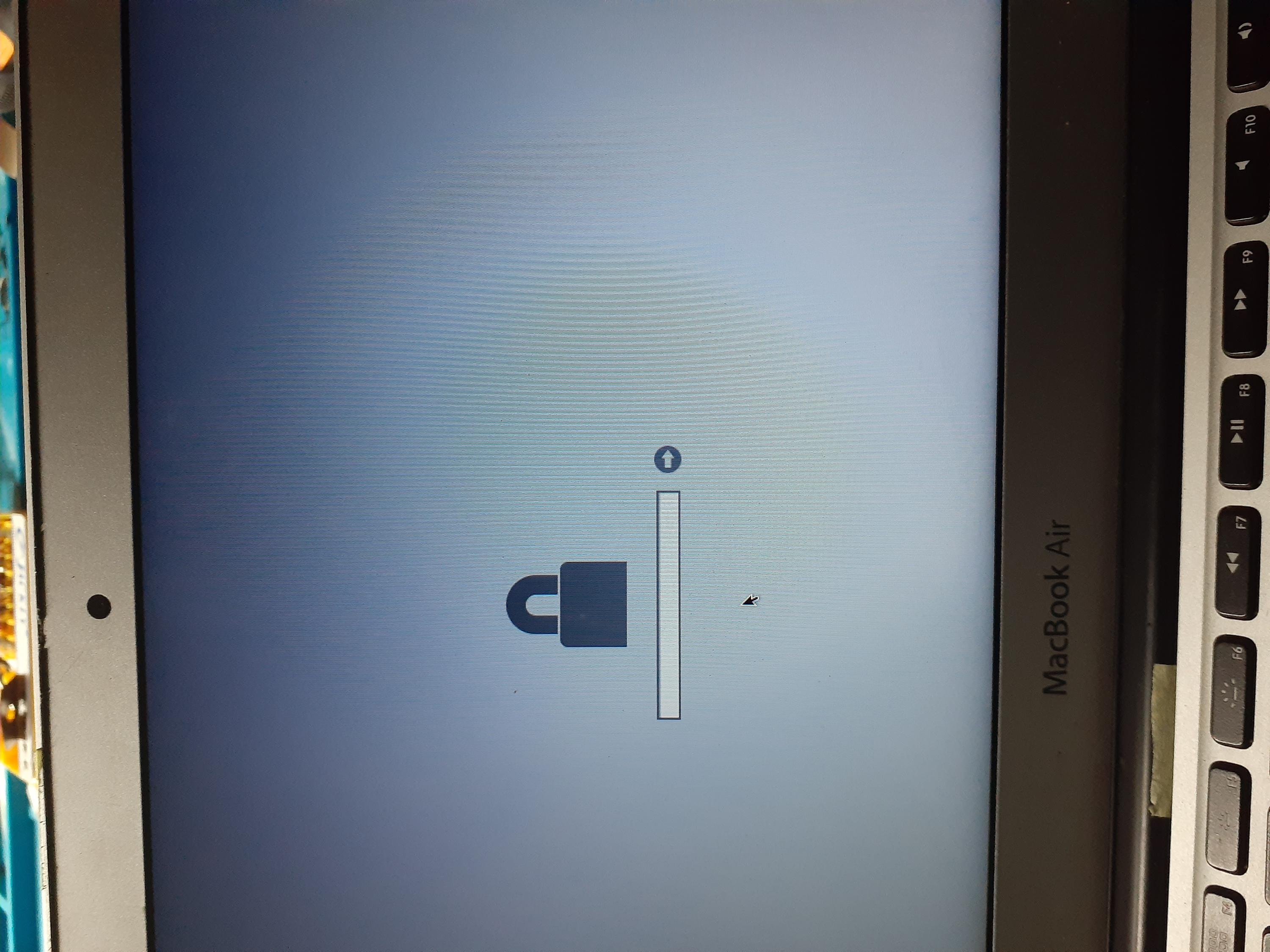

                              Still locked , not cleared
