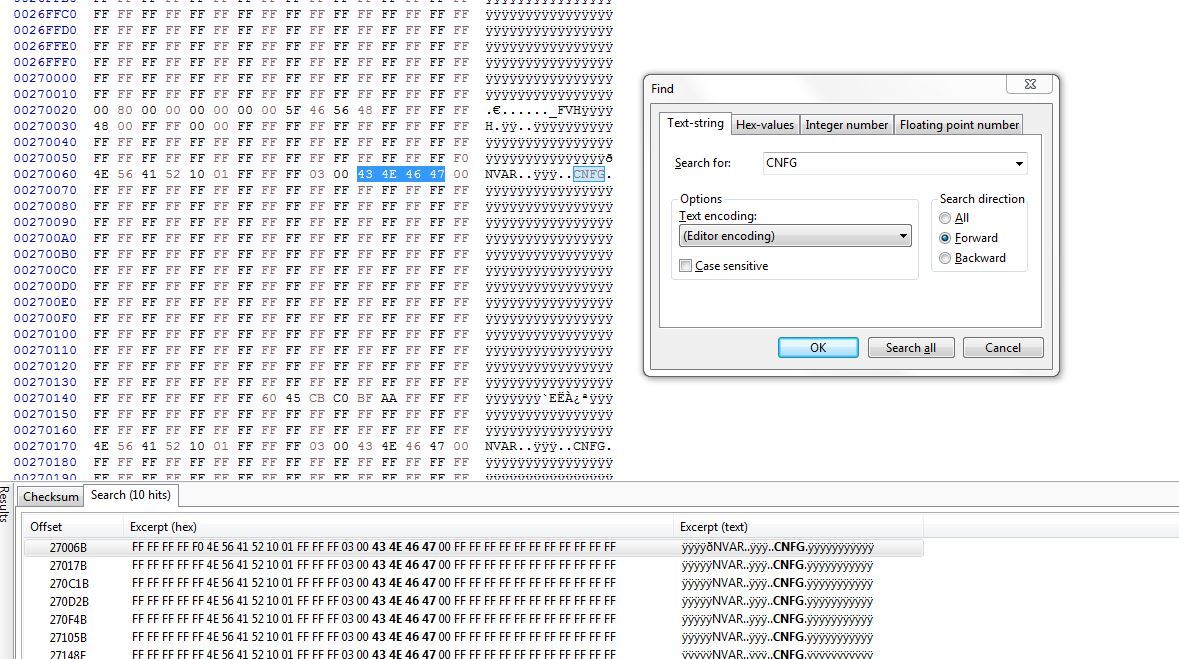

                  #88
                  Hello. Asus GL553VD-FY009, bios busted after bios windows update failed
                  Now notebook is starting, but no picture on screen
                  SN H2N0CV179585084
                  Can you guys make me an revive? Thank you very much.
                    • 22276
                    #89
                    SN H2N0CV179585084
                    What model number does it say on the barcode sticker - https://www.badcaps.net/forum/troubl...10#post3307010
                    • c.daniel
                      • Mar 2017
                      • 108
                      • Romania
                      #90
                      Mate, it not say anything, because i did NOT take out mainboard, notebook has to be resolved low on money, like nothing...
                      So. i search on this 5 pages of bios, and search inside file for therms "GL553VD" and i picked file named "Asus Rog GL553VD-F1 Rog GL553VD-F1_bios-version-302"
                      Write it, it's working perfect.
                      But, this file has SN named generaly "SSN1234567890123456", and because i did NOT know at what adress i find DMI, i proceed like this:
                      - i search in my messed up bios for original SN "H2N0CV179585084" and i find it from 2706D0 - 271D00
                      - i decided that DMI region is from 270100 - 271FF0, copy it in the new working bios, write it, BUT, in bios SN is still show the general one "H2N0CV179585084"
                      Please tell me how to find in future where is located DMI in a bin file.
                      Thank you.
                        • 22276
                        #91
                        Thank you.
                        Search for CNFG (and/or GPNV) and find the start offset 270000 .The length is 10000 ,the end offset is 27FFFF. With some of the newer asus models the DMI the length is 8000
                        • c.daniel
                          • Mar 2017
                          • 108
                          • Romania
                          #92
                          Thank you very much SMDFlea
