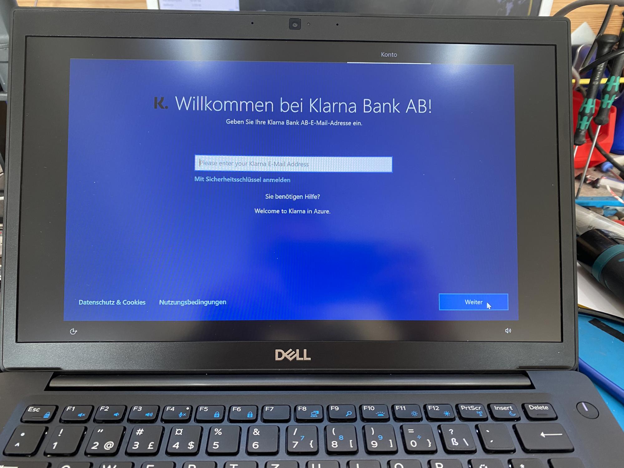

      I have an automatic lockout when installing Windows 10/11. No way to create an offline account (remote lockout). How can this be removed? The equipment is post-leasing, sometimes it has several of these, but the problem remains.

            I changed the service tag but the problem remains. I think it is about MDM (Mobile device management). Is it possible to remove windows 10 key from BIOS?
              create USB install disk with rufus, check boxes as they show on the website and at installation click "I don't have internet" and setup an user offline.
