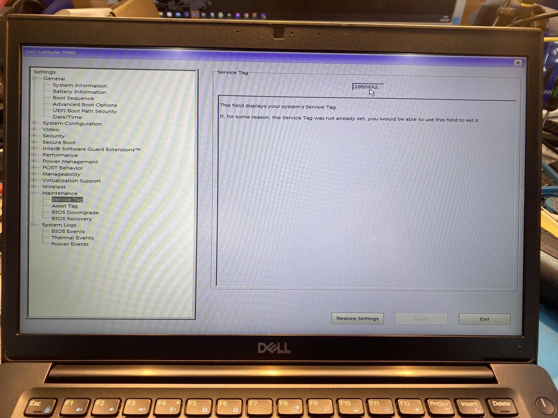

                              i have Dell Latitude 7490 with computrace active
                              motherboard : DAZ40 LA-F321P Rev 1.0 (A00)
                              can anyone help me remove this?

                                Use the dump at post #111
                                Your Service Tag is FTCYNQ2, input the ST at first boot, disable Computrace, then save and restart. Alt+F to exit MPM at second boot.

                                  #116
                                  Re: Dell latitude 7490 bios Computrace
                                  Before I make a bios change (new bin), do I clear ME first?

                                    #117
                                    No use the file as is, it's already has clean ME firmware.

                                      #118
                                      I can't change the ST? After the first start I pressed F2

                                        #119
                                        I don't know what you did but first tell me about the Computrace, if it's disabled now I'll suggest you to leave it this way.

                                          #120
                                          I can set only Disabled. I can't set Permanently Disabled
