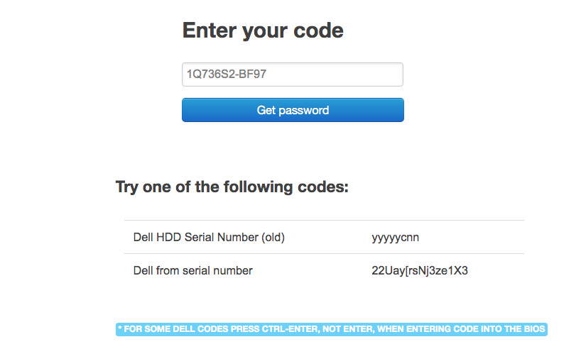

      Hello, i have a Dell Latidude 7490
      with Service Tag 1Q736S2-BF97
      with no Access to Bios
      Can Someonbe help me?
        use https://beta.bios-pw.org/ Click image for larger version
Name:	Screen Shot 2024-08-06 at 23.29.45.png

          i have tried this moretimes, but doesnt work, yet it show me the Dell Security Manager.
            use external USB US keyboard

              use external USB US Keyboard
              ohhh my goood, i try it everytime with the German Layout, thanks a lot It works
