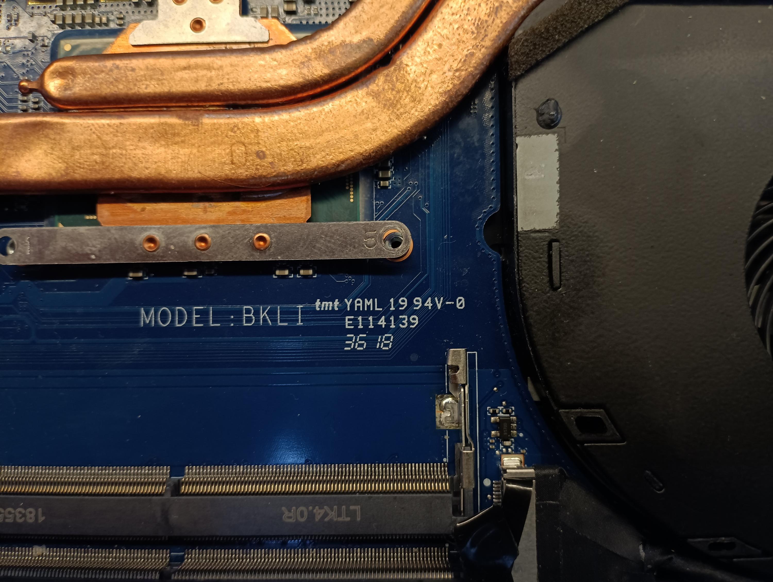

    Hi everyone!
    I'm in trouble, I need an ASUS ROG FX504GM dump bios (16Mb)
    Motherboard is DABKLIMBAB0 Rev.B
    I was not able to cut it from factory bios ...

    The bios from asus is a bios update,not the full bios.Post your bios backup .

      Yes, I know, but my original has corrupted/incomplete, because of failed bios update! So I need a complete dump in this case, I think!
      But here it is, if you can use it anyhow:

        Try this bios .There`s no DMI included.

          You are very kind! Thanx! Will try

              I report that is working perfect, SMDFlea; thank you very much.
