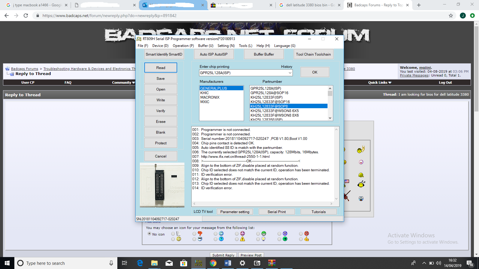

      i am having trouble saving the old bios because it is The currently selected:GPR25L128A(ISP), capacity: 128Mbits, 16Mbytes. see also picture
      the laptop seems to have corrupted bios as i am having flashing light and fans spins than nothing than i get flashin lights between red and white

        You not need to select manually auto select chip this programmer.Id verification error

          this is the first chip that i haven not been able to read it
          022: >------------------------------------OK---------------------------------------<
          023: Using Mode-A to scan VGA port...
          024: Mode-A cannot identified the circuit board, change line sequence to Mode-D and continue to identifying...
          025: Mode-D cannot identified the circuit board, change line sequence to Mode-B and continue to identifying...
          026: Mode-B cannot identified the circuit board, change line sequence to Mode-C and continue to identifying...
          027: Scan SPI extension interface...
          028: Boot error, please check whether the EC chip is supplied voltage and ISP cable is connected properly or not. The ISP cable should not exceed 10cm in length.
          029: Chip is not recognized, please check whether the circuit board is powered on and ISP cable is connected properly or not. If all ok, it maybe the chip is damage.

              i don't know how to write this chip, i am trying all the ones on the right as per my previous picture none will have it, all give error, does anyone know which one of the part number on this chip will take the bios, i also tried with a winbond chip but with that fan constantly on and high speed no dispaly

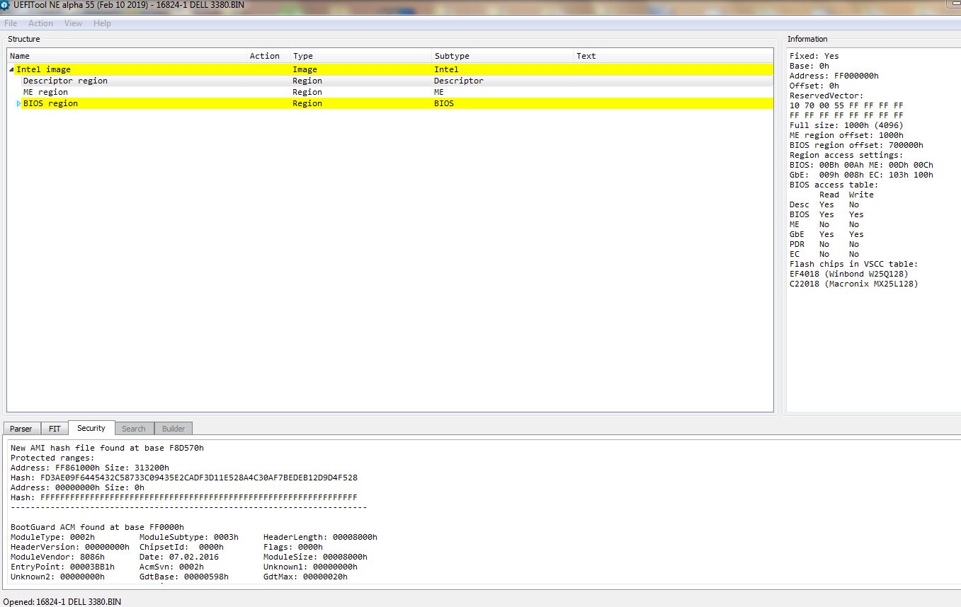

                If you open the bios from imranromi with UEFITool there`s 2 supported bios chips in the descriptor region.
                Flash chips in VSCC table:
                EF4018 (Winbond W25Q128)
                C22018 (Macronix MX25L128)
                EF4018 and C22018 are the JDEC id`s,you can google them.
                Winbond W25Q128FV , Macronix MX25L12805/12835/12845

                  hi, i just tried with winbond 25q128fvsg but nothing light on, i press the power button light on for 20 seconds no fan spin no getting warm processor, than light goes off
