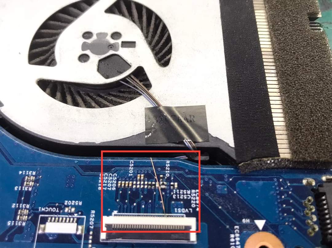

                  Aspire E1-472G Need clean ME BIOS
                  Need Acer Aspire E1-472G EA40-HW MB 12243-248 BIOS dump or clean ME my BIOS.
                  Problem is blank display every enter bios.
                  Here is bakcup BIOS.

                        • cygron
                          • Oct 2017
                          • 25
                          • Myanmar

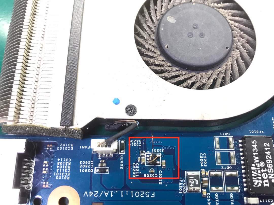

                          Re: Need bios Acer E1-472G or clean ME my bios
                          Originally posted by pctronics
                          Did you solve this sir? I have the same problem
                          If BIOS flashing can't solve your problem, try this way.
                          • jhomhar08@gmail.com
                            • Jul 2018
                            • 6
                            • philippines
                            this works pin 22 on lvds1
                            u5201 pin3and 5
