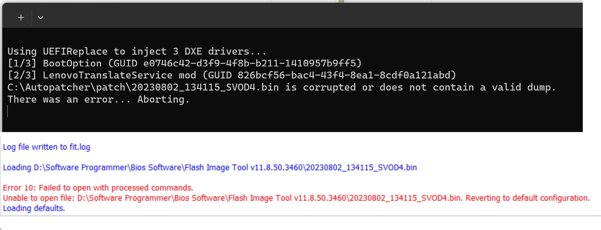

                              Re: Lenovo ThinkPad 13 gen 2 - BIOS Request
                              Hello, Can anyone tell me if Lenovo Autopatcher v0.2 works
                              for this model ? I have done a few readings with two different programmers
                              the files are identical, Lenovo Autopatcher is telling the file is corrupted.
                              And is the password on the main bios or EC.
                              Lenovo ThinkPad 13 Gen 2, Type 20J1, 20J2. Thanks.
                                  Thanks Vesko356, Could someone please have a look in to
                                  my this bios to see if it can be fixed.
                                  Sure its a corrupted bios, Thanks so much.
                                  • Dan20701
                                    • Sep 2020
                                    • 204
                                    • United Kingdom
                                    Hello again, Related to my last post, Is there nothing that can be done?.
                                    I have tried to reload the ME using fit.exe its not loading the bin file, there
                                    is nothing more that I know I can do. Some help with this would be nice.
                                    Thanks.
