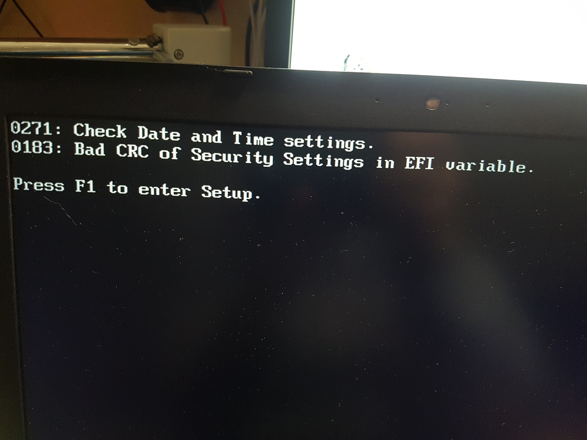

Lenovo L560 - bios PWD
  • mcplslg123
    • Jun 2015
    • 7262
    • india
    Re: Lenovo L560 - bios PWD
    Check for resistance to gnd on 3 and 5v coil to begin with. 0V at kbc means probably your 3v rail is shorted somewhere. Can be 'coz of KBC but there can be "N" number of reasons for 3v rail to pulled down.
    • mcplslg123
      • Jun 2015
      • 7262
      • india
      Re: Lenovo L560 - bios PWD
      Originally posted by magneh
      Do you know where I could by some programmed KBC's for this particular model?
      Once again, thanks for your time!
      Cheers
      I never buyed them online as i have all the tools. So cant say but try searching on ebay.
      • magneh
        • Apr 2014
        • 619
        • Portugal
        Re: Lenovo L560 - bios PWD
        Yes, but the thing here is that the 2 laptops I flashed with the PWD clear dump, they both behave the same way.
        No power at all.
        In one of them I rolled back to original dump, and still the same.
        So its weird as I have the same problem with both. No power after bios programming.
        Im sure the 3v line is not shorted, as the diode mode measurements showed in BIOS chip IC pins.
        I will do some checks when Im at the office.
        • Pferd5
          • Mar 2018
          • 72
          Re: Lenovo L560 - bios PWD
          which programmer do you use?
          Do you use a clip or desolder the chip?
          I made the observation that sometimes (with clip) some bytes aren't written correctly.
          I mainly used SkyPro II ... and from time to time TL866 II (should be better, but can't be used with clip)
          Try desolder the bios chip and check whats happen in this state and repgramm the chip with your old bios dump.
          • drgn997
            Banned
            • Dec 2011
            • 19
            Re: Lenovo L560 - bios PWD
            I may be wrong, but customers have reported that some Lenovo ThinkPad models need bottom cover to be installed, otherwise bios chip won't get +3.3V... worth a try.
            • magneh
              • Apr 2014
              • 619
              • Portugal
              Re: Lenovo L560 - bios PWD
              Originally posted by Pferd5
              which programmer do you use?
              Do you use a clip or desolder the chip?
              I made the observation that sometimes (with clip) some bytes aren't written correctly.
              I mainly used SkyPro II ... and from time to time TL866 II (should be better, but can't be used with clip)
              Try desolder the bios chip and check whats happen in this state and reprogram the chip with your old bios dump.
              Well finally back to these machines.
              I have 2 working L650 with bios locked.
              The 3.3V are not coming up after I de soldered the bios, re programmed with the dump posted here, and soldered it back.
              Since then machine is dead. No reaction at all. I can confirm the 3.3V are not present in pin 8 of the bios.
              I use a SP8-a programmer with the 8 pin adapter for the bios.
              Used directly on the programmer.
              I can confirm there is no damage on the bios pads or surrounding area/components.
              I did the same thing to a second L560. Same result. machine dead since then. Very weird...
              Ive measured the Bios pins in diode mode of a working and a non working L560.
              I can see considerable differences in certain pins.
              pin working L560 L560 KO L560 KO without
              bios chip
              1 .693 .654 .586
              2 .560 .544 .542
              3 .736 .580 .624
              4 0 0 0
              5 .727 .610 .631
              6 .590 .565 .631
              7 .727 .598 .626
              8 .357 .363 .360
              But even seeing this, this wont justify the 3.3V to not be present AFAIK...
              Seeing this, what would you more experienced guys do?
              Thanks for any inputs
              Last edited by magneh; 03-12-2019, 12:58 PM.
              • magneh
                • Apr 2014
                • 619
                • Portugal
                Re: Lenovo L560 - bios PWD
                Originally posted by drgn997
                I may be wrong, but customers have reported that some Lenovo ThinkPad models need bottom cover to be installed, otherwise bios chip won't get +3.3V... worth a try.
                wow
                And they are completely right...theres a little switch on the board that the cover push on when in place... some reset signal that prevents 3.3V on the board.
                So just need to put some tape on it and I have 3.3V on the bios, and both laptops booting up, still with Bios PWD.
                I feel like a donkey right now
                • magneh
                  • Apr 2014
                  • 619
                  • Portugal
                  Re: Lenovo L560 - bios PWD
                  Has anyone been able to unlock/reprogram one L560 with bios PWD
                  Ive reprogrammed BIOS, KBC and still have bios locked
                  When the PC boots up the first time after bios flash I get this error
                  0183: Bad CRC of Security Settings in EFI Variable.
                  Could it be the security chip preventing the unlock??
                  Jeezz what a nightmare
                  Last edited by magneh; 03-13-2019, 04:36 PM.
                  • medinfo
                    • May 2016
                    • 331
                    • Morocco
                    #29
                    Thinkpad L560 Bios Password
                    Thinkpad L560 Bios Password ?!!
                    Possible to unlock it from eeprom ??
                    • digitalpc
                      • Jun 2016
                      • 305
                      • .DLL
                      #30
                      Re: Thinkpad L560 Bios Password
                      SupervisorPassword?
                      I usually use this method in ThinkPad, try it too.
                      https://www.youtube.com/watch?v=FW-RLkzjAS8
                      • foulou0238
                        • Mar 2014
                        • 109
                        • France
                        #31
                        Re: Lenovo L560 - bios PWD
                        hello
                        try flash ur motherboard with this dump and report result please
                        • majkel_27@o2.pl
                          • Sep 2013
                          • 26
                          • konin
                          #32
                          Re: Lenovo L560 - bios PWD
                          Hey, I checked your bios. Unfortunately, fan, high speed and dark screen, I have a clean ec. and factory bios but unfortunately tpm remains MFG mode and error 189 uuid error. at the original bios tpm is normal, so it probably remains to read the original password from the bios file. Any ideas?
                          Last edited by majkel_27@o2.pl; 05-21-2019, 05:38 AM.
                          • majkel_27@o2.pl
                            • Sep 2013
                            • 26
                            • konin
                            #33
                            Re: Lenovo L560 - bios PWD
                            Here is a clean factory ec. and a clean factory bios. and bios with a password can someone help put it together so that it works properly.
                            Last edited by majkel_27@o2.pl; 05-22-2019, 03:13 AM.
                            • imranromi
                              • Jan 2015
                              • 1290
                              • Pakistan
                              #34
                              Re: Lenovo L560 - bios PWD
                              Originally posted by majkel_27@o2.pl
                              Here is a clean factory ec. and a clean factory bios. and bios with a password can someone help put it together so that it works properly.
                              Password not store in bios this Model.Buy patch or if have i/o programm then you can.
                              • majkel_27@o2.pl
                                • Sep 2013
                                • 26
                                • konin
                                #35
                                Re: Lenovo L560 - bios PWD
                                Uploaded clean Bios, clean EC, replaced TPM. There is no password but there are errors and tpm is in MFG mode. I play bios with password, TPM is normal still error 189, but asks for generating uuid, but this I can not do because bios the default is in the uefi mode, do you know where else the password can be stored?you mean Maintenance Diskette
                                Last edited by majkel_27@o2.pl; 05-22-2019, 04:34 AM.
                                • imranromi
                                  • Jan 2015
                                  • 1290
                                  • Pakistan
                                  #36
                                  Re: Lenovo L560 - bios PWD
                                  Password in MEC.../ITE/ENE/Nuvoton Which chip have this board?
                                  • majkel_27@o2.pl
                                    • Sep 2013
                                    • 26
                                    • konin
                                    #37
                                    Re: Lenovo L560 - bios PWD
                                    novoton npce388
                                    the new clean feed is erased and uploaded
                                    Last edited by majkel_27@o2.pl; 05-22-2019, 05:13 AM.
                                    • imranromi
                                      • Jan 2015
                                      • 1290
                                      • Pakistan
                                      #38
                                      Re: Lenovo L560 - bios PWD
                                      Yes use Maintenance Diskette if support your model
                                      • majkel_27@o2.pl
                                        • Sep 2013
                                        • 26
                                        • konin
                                        #39
                                        Re: Lenovo L560 - bios PWD
                                        I've tried unfortunately
                                        • imranromi
                                          • Jan 2015
                                          • 1290
                                          • Pakistan
                                          #40
                                          Re: Lenovo L560 - bios PWD
                                          Try programm back original Ec check what results lock or unlock?
                                          • lucaszmn
                                            Summary of BIOS Whitelist Removal Problem Lenovo Thinkpad T560
                                            by lucaszmn
                                            Summary of BIOS Whitelist Removal Problem
                                            Problem:
                                            I am attempting to remove the WWAN card whitelist from my Lenovo ThinkPad T560.
                                            Initial Findings:
                                            • My current BIOS version is N1KET58W (1.45).
                                            • I have a CH341A programmer and have successfully created two full backups of my BIOS.
                                            • I have the ability to use command-line tools on a Linux machine.
                                            Troubleshooting Steps & Conclusions:
                                            • I attempted to use several automated and manual patching methods on my N1KET58W (1.45) BIOS, including using hex strings. These attempts all failed.
                                            • I concluded that the
                                            08-12-2025, 03:01 PM
                                          • Wahaz
                                            by Wahaz
                                            10-30-2023, 08:42 PM
                                          • grimacelord
                                            Lenovo Legion T5-26AMR5 Desktop - Corrupt BIOS
                                            by grimacelord
                                            Hello there.
                                            I am working on a Lenovo Legion T5-26AMR5 desktop that currently has a corrupt BIOS and I have been unsuccessful thus far in trying to fix it myself.
                                            History:
                                            1. This computer came to me initially with an error message that said "BiInitializeLibrary failed 0xc0000001" or "0135 fan error". It would always be one of the two errors. It should be noted that when it produced the fan error, there was no physical problem with the fans. They were all spinning just fine.
                                            I searched for this error online and discovered...
                                            03-15-2023, 03:29 PM
                                          • to5it0
                                            Need Clean BIOS/EC Bin File for Lenovo ThinkPad Yoga 11e 2H1703-27220F Rev. A Marked as U2501 on the motherboard.
                                            by to5it0
                                            Need Clean BIOS/EC Bin File for Lenovo ThinkPad Yoga 11e - Stuck with 0275 Error CMS
                                            I am attempting a repair on a Lenovo ThinkPad Yoga 11e that is currently stuck at boot with the error: "0275 error CMS" even after setup new bios battery and will not allow me to enter the BIOS/Setup.
                                            This is a critical issue that I believe requires flashing the BIOS chip directly using a programmer (e.g., CH341A/RT809H), as standard software updates or resets are not possible.
                                            I have opened the laptop and identified the main BIOS chip...
                                            10-24-2025, 01:35 AM
                                          • mkdj
                                            Lenovo IdeaPad 3 - Hard Disk not recognized in BIOS
                                            by mkdj
                                            Dear all,
                                            I have recently fixed a Lenovo IdeaPad 3 15 ALC6 that was not booting due to a BIOS issue. After flashing the BIOS, the laptop boots up, but hard disk is not recognized in BIOS. Is says "Hard Disk : Not Installed". I have tried with 2 different drives (one that I know is working on another laptop) but I get the same result. I do not know if disks were recognized before I got the laptop and fix it, but I don't see any reason why not. I can boot on USB though.
                                            Here the steps I have taken to fix the laptop:
                                            - downloaded latest BIOS from Lenovo Website...
                                            10-18-2025, 03:43 AM
