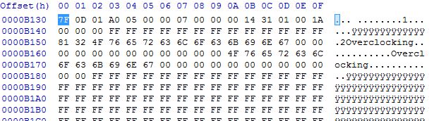

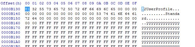

                    As mentioned before ec1,2,3 and 6.bin are not good dumps for sure but I thought it might be useful to post them.
                    I'm a bit confused with what you said, I thought the 2mb chip was the EC and the 4mb the Bios but you said that's not the case.
                    In your opinion do you think the files are corrupt? Now that I think about it, I don't think I'll ever be able to compare it being that this is not a official bios.

                      my opinion the bios region has some error,, you can check using UEFItool and compare with bios from P17xSMA_B0311.zip...
                      try this from downloaded from SMDFlea link (post#4)
                      2mb and 4mb
                      extracted and split from P17xSMA_B0311.zip
                      your logo will change to CLEVO..
                      goodluck
