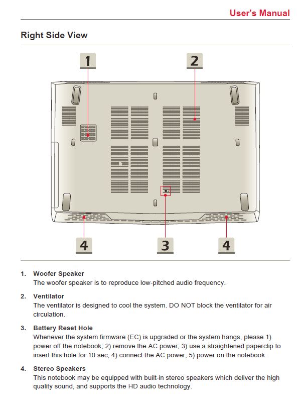

      Hello, sorry, my bad, but the laptop turns on by itself when I plug power adapter, the power button has 1.3V. When it turns off I can't turn it on with power button unless I replug power adapter.
      VREG5 and VREG3 have their own 5V and 3.3V, so I assume LDO IC is good.
      EDIT: I can't trigger power button, but there's a battery reset hole under the laptop (check image), if I press it, the motherboard reboots (led's on and fan spins up again).
