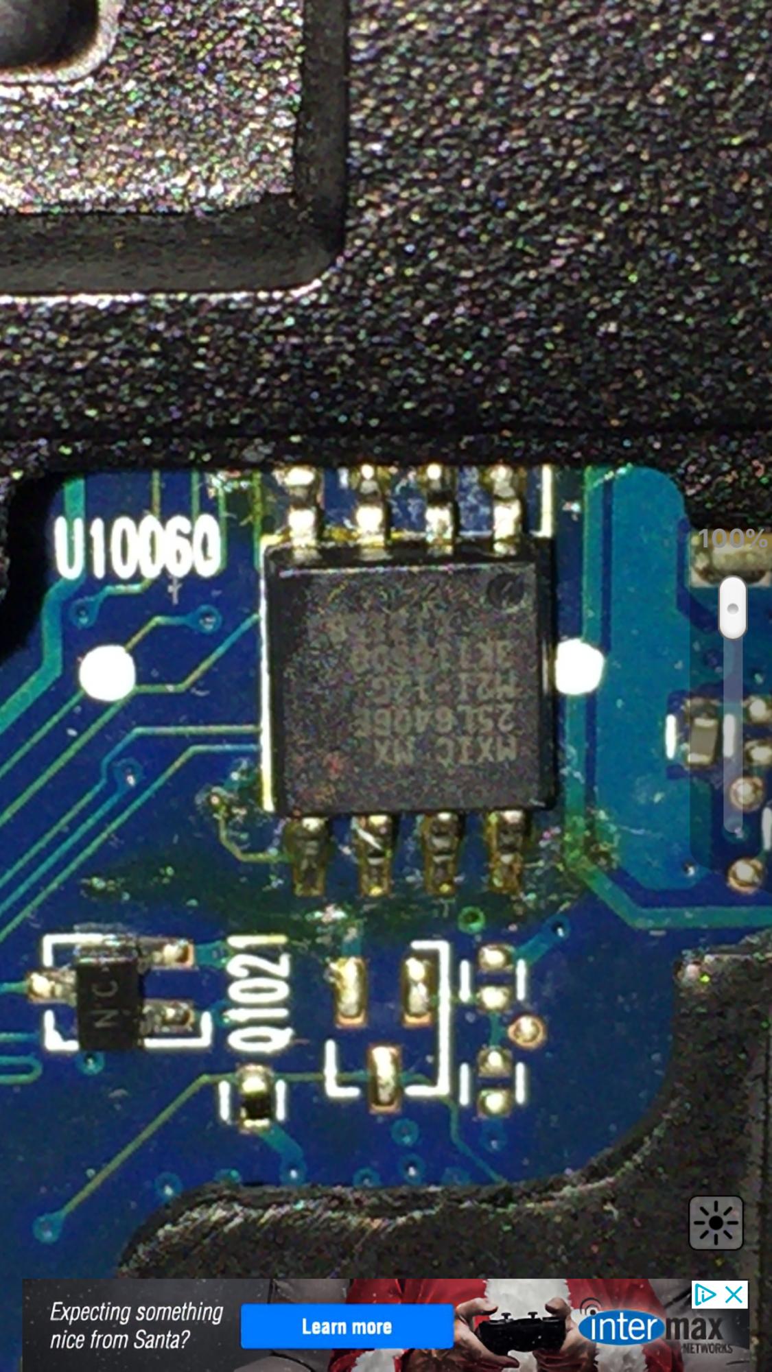

              I recently had a virus that corrupted my BIOS on an HP EliteBook 8760w laptop. I bought a ch341a programmer and flashed the BIOS numerous times. I did not have a clean dump from this machine so I have tried pretty much every dump shared in this forum for this laptop. Some dumps don't allow the laptop to power on at all (charging light just blinks). The last two shared in this thread have "occasionally" allowed me to get into the BIOS setup. Once in the BIOS setup, the laptop soon shuts off on its own and tries to reboot even with no hard drive installed at all. When trying to boot from a known clean drive, it gets part way through the boot process and abruptly shuts off before Windows can fully boot. The weird thing is that after a partially successful attempt to access the BIOS setup is made (followed by the abrupt shut off), the next time I try to power on the laptop, it just power cycles the fan and lights but does not try to boot at all which causes me to have to keep reflashing the chip.
              I can't imagine that the BIOS virus/malware corruption has survived the multiple erasing and flashing attempts so I'm thinking that the BIOS dumps I've tried aren't 100% compatible with my motherboard. Does anyone have idea other ideas to help me get the BIOS to be stable on this machine? I'm at my wit's end. Many thanks to you.

                  can u make a pic around chip
                  i think something around bios chip is touching, can be chip pins check again

                    It doesn't appear to me that anything is touching the chip but I have attached a picture.

                      The small cap above the bios chip looks like its dislodged.Could be track damage too .

                        Attached is a picture of the BIOS chip on a different laptop (exact same model). That cap looks the same on both motherboards. The BIOS on both laptops were affected by the same virus.
