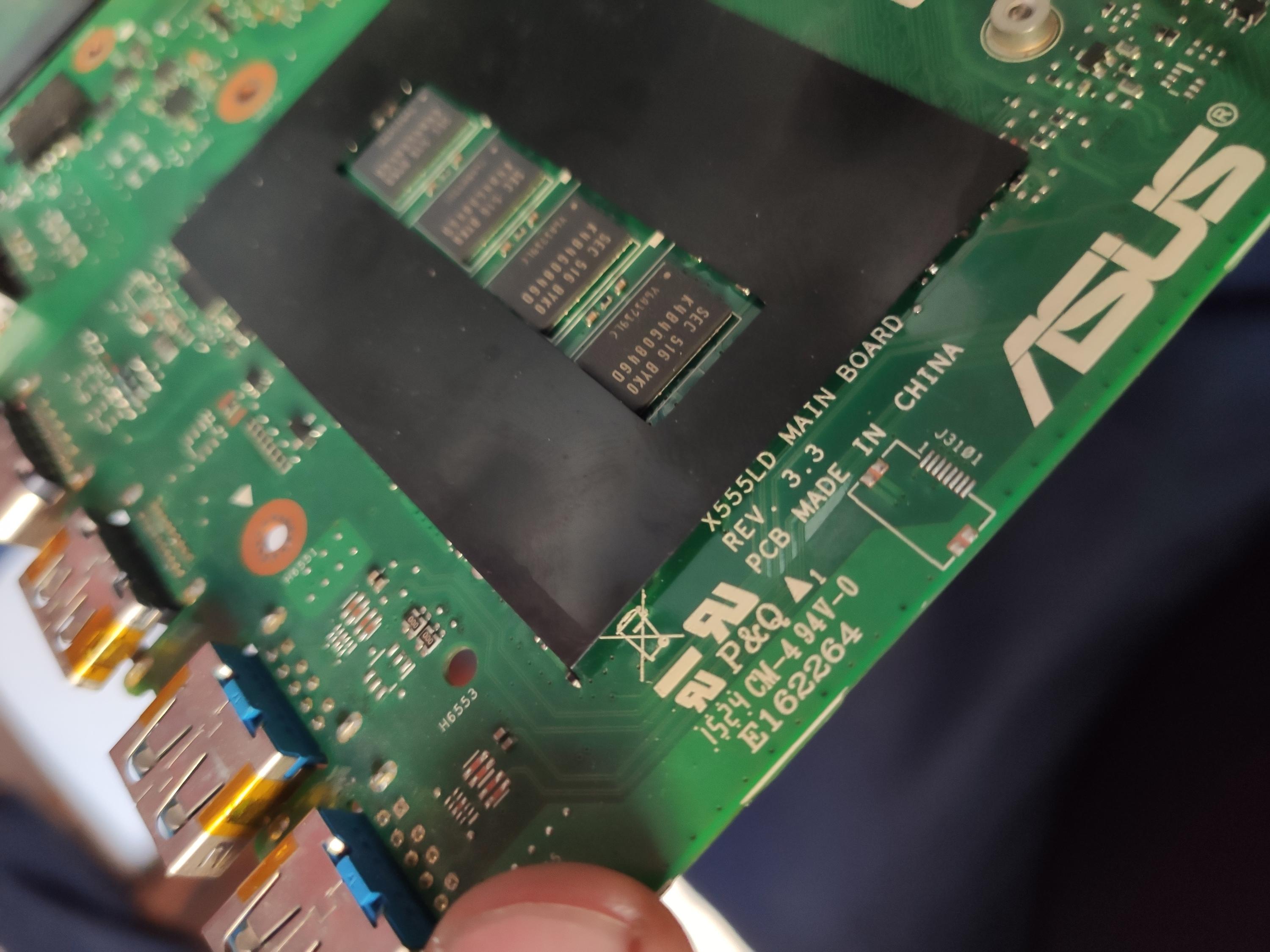

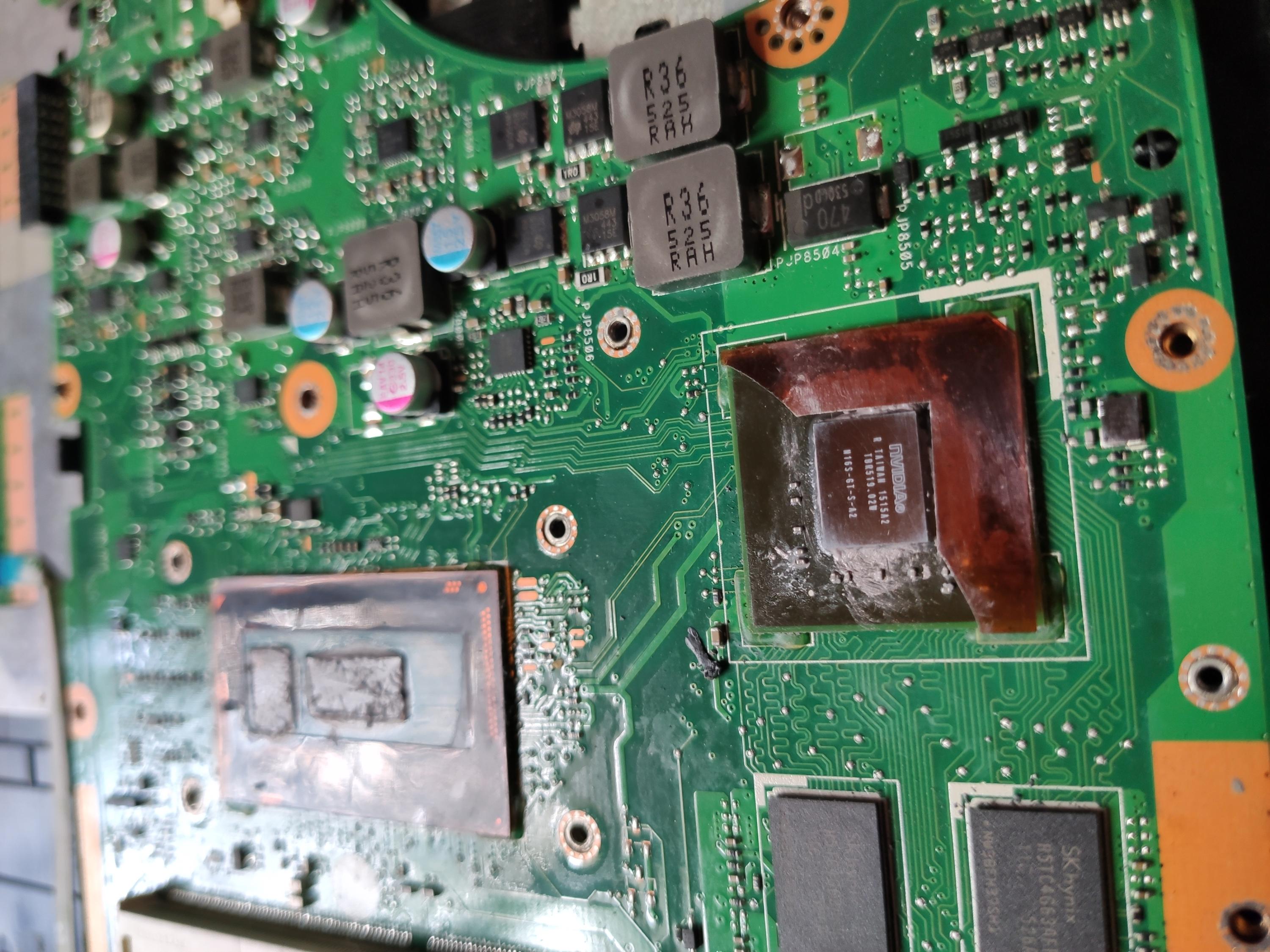

            thank u i will try but not workink.my motherboard x555ld rev 3.3 n16s-gt-s-a2 nvidia cards not working

                hi again i try before this bios but winflash message bios file is not valid.
                this vram chip is n15 but i need n16s please help me

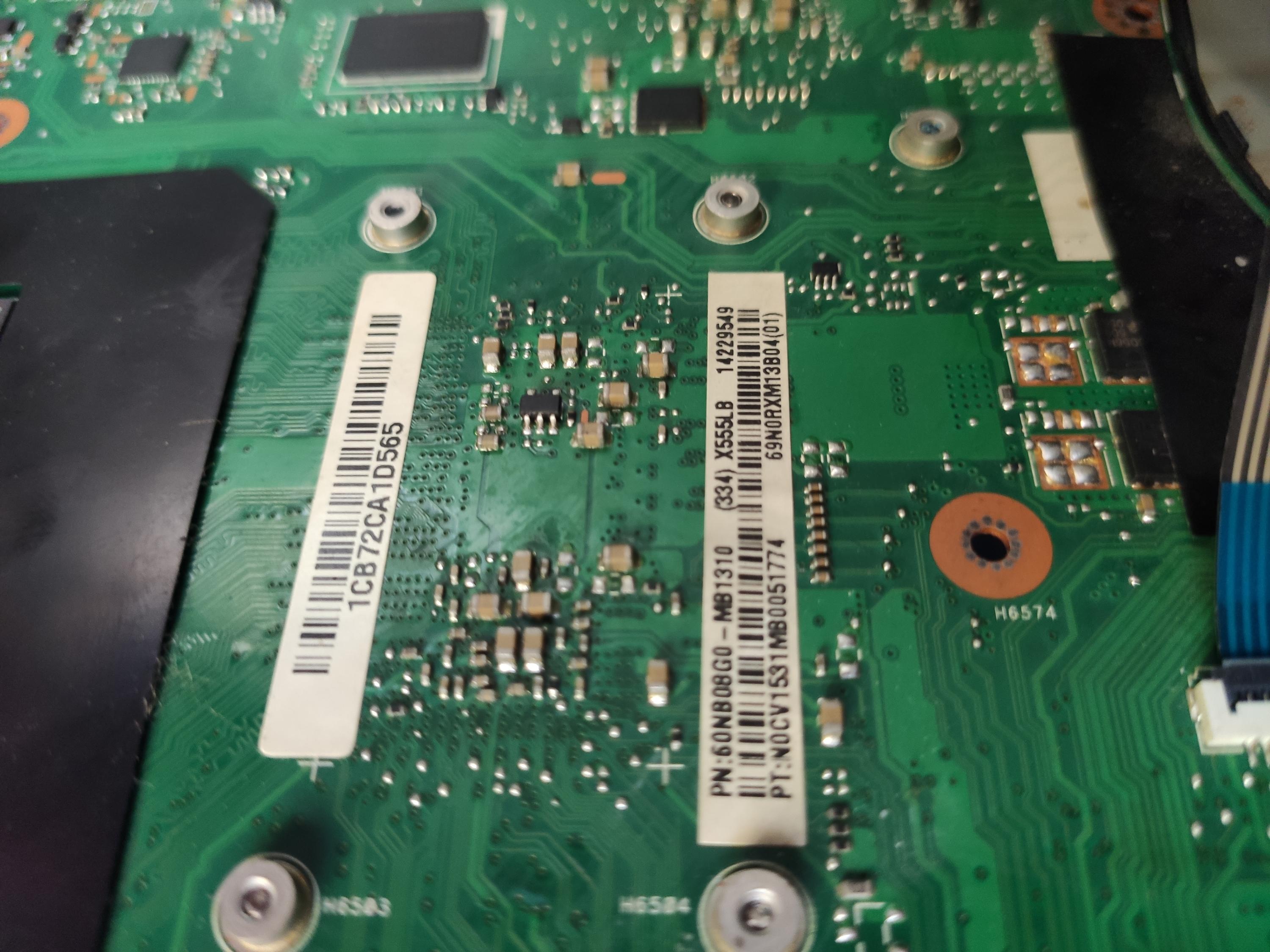

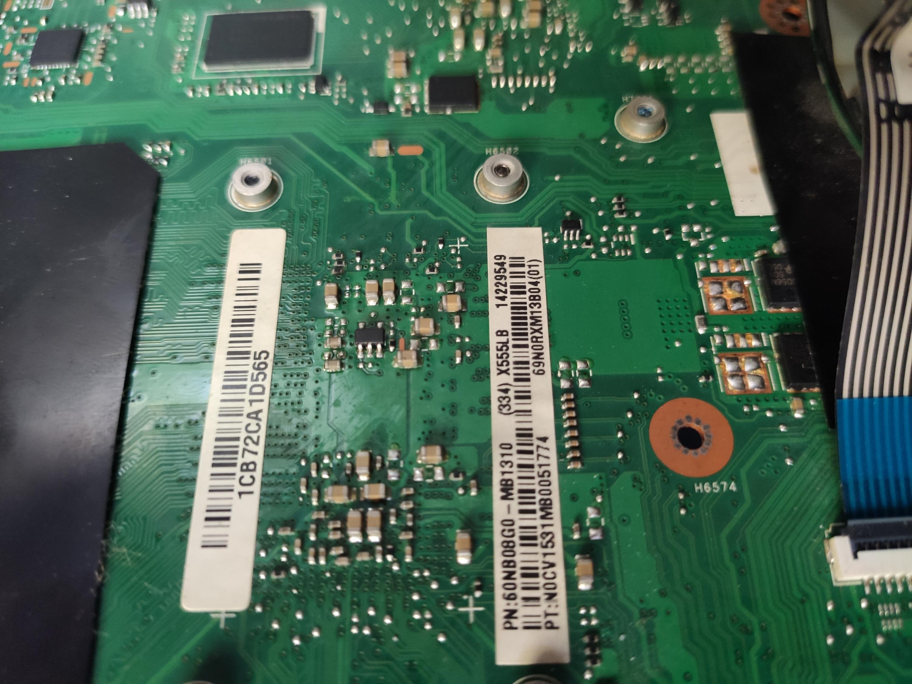

                  Post your original bios backup and post a good readable picture of the white/green sticker with the barcode/QR code on it .Its best to program the bios with an spi programmer if you have one. Winflash does have a force option though .
                  • hallmark1730
                    • Apr 2021
                    • 27
                    Re: X555ld rev 3.3
                    Hello I added photos and bios.This is the bios file that asus accepts and installs with its own program.and i added the latest version 307
                      • 22276
                      Re: X555ld rev 3.3
                      Post YOUR bios backup,the one on the bios chip.Use an SPI programmer to backup, need the whole 8MB ,not updates.

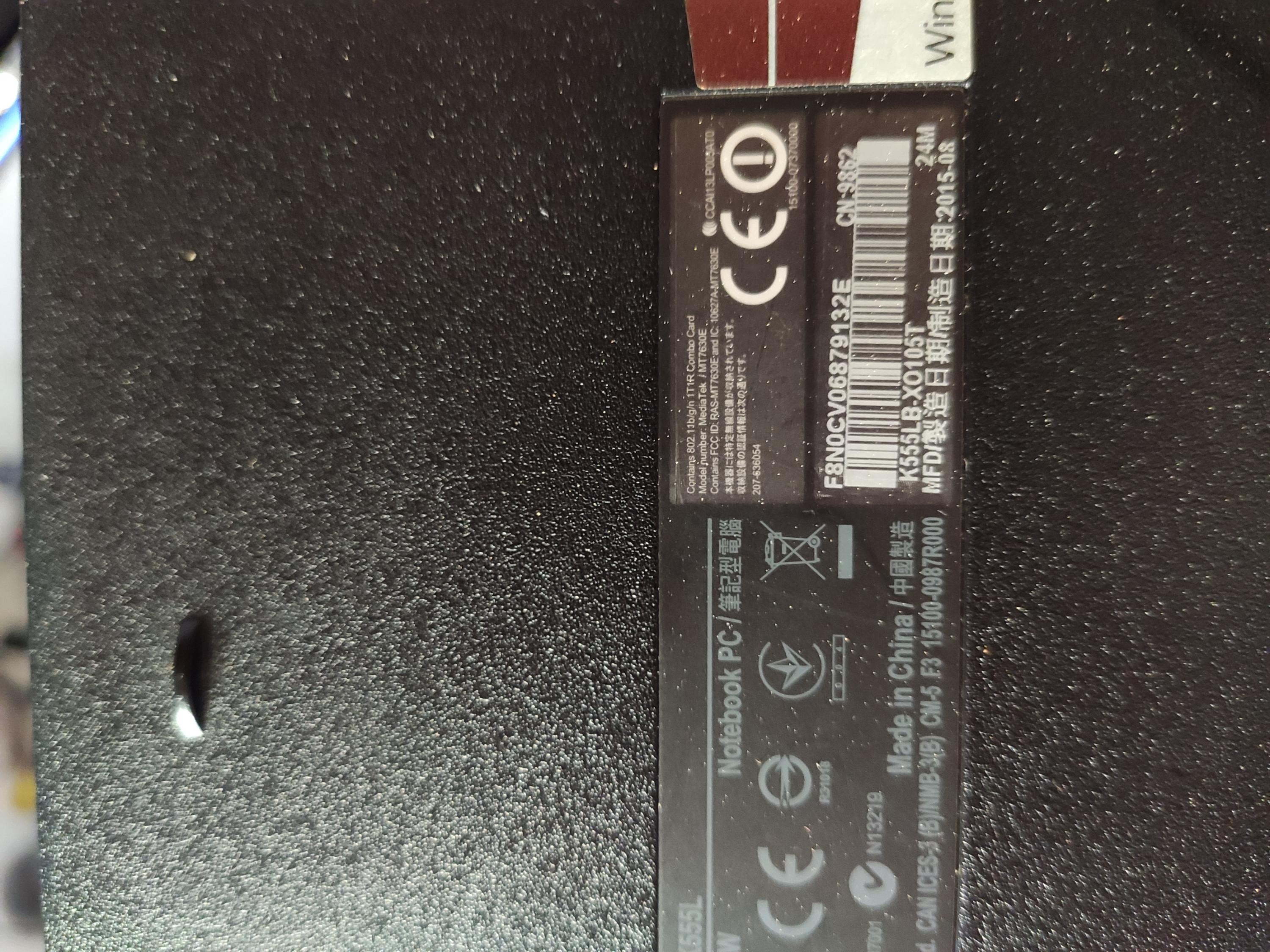

                            asus x555LD rev.3.3(Case code:k555lb)but inside bios x555lbd.307(i think wrong bios)
                            n16s-gt-s-a2 nvidia chip inside.intel gpu work fine but gt940m is code 43 ?
                            please help me

                                (334) X555LB on the white sticker is the bios that the board shipped with. So you need a X555LB bios
