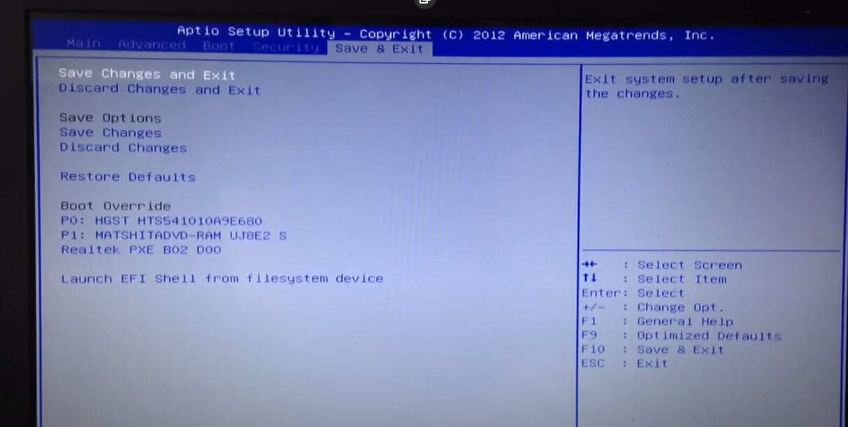

                    The new laptops is not supporting Legacy mode, is not your case.
                    When you powering on the laptop, please make silence and be carrefully to hear that if hdd try to spin his disk/s or making some noise; as i said, i suspect that, even if you have voltage, you do not have sufficient current to power hdd; that's way i ask, if iou can, to check with a ssd.

                      And, make a picture in this stage:

                          Re: X555LD HDD Board change
                          I get an error if I want to Upload the image. Its sayd that file is invalid. If you know why, feel welcome to let me know.
                          So this is what it says at the Save and Exit site of my bios:
                          Save Changes and Exit
                          Discard Changes and Exit
                          Save Options:
                          Save Changes
                          Discard Changes
                          Boot Override:
                          launch EFI Shell from filesystem device

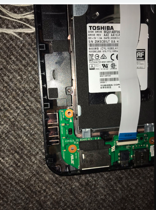

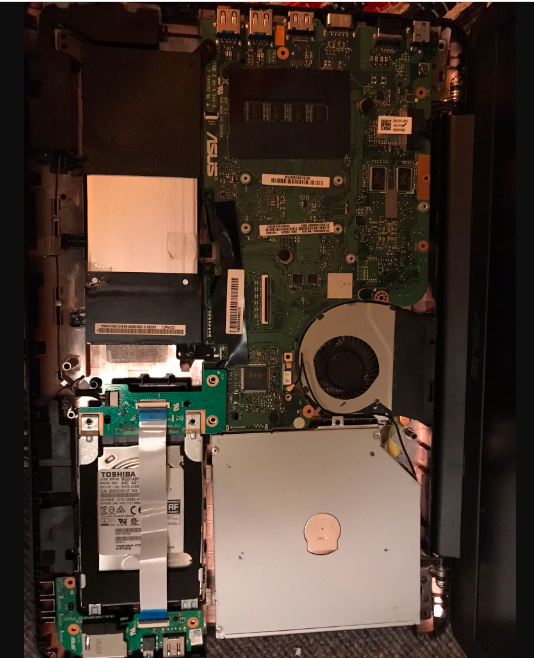

                          • Azhar691
                            • Sep 2021
                            • 10
                            • germany
                            Ok, i have these leds here on the small board and they are not working. So I guess it could be because I havent enough voltage. If someone know how to higher voltage at that point, I wold be thankfull. The LEDS are on the "USB Bord" that I mentioned before. This board is connected through the HDD Board. As you can see on the picture of the whole Comuter.
                            • Azhar691
                              • Sep 2021
                              • 10
                              • germany
                              Ok tanks for all the suport Guys! It works and I am an idiot. I just had to put the screws in.
