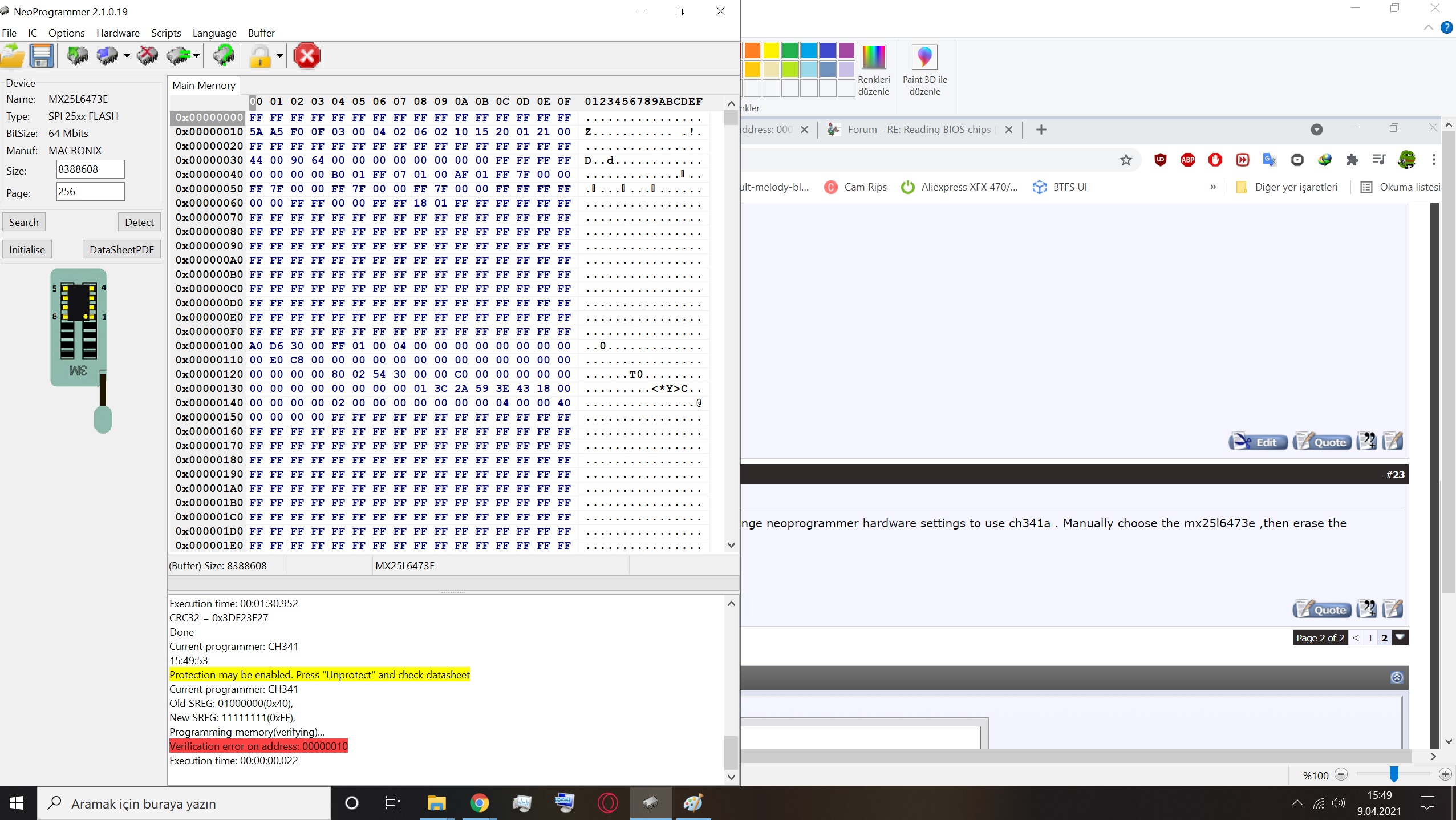

    Thanks neoprogrammer is good list my chip mx25l6473e.Can I write the bios file directly? or do I need to find a dump file.i found a x555lb orijinal dump file Which one should I use
    3.3 volt mode mandatory?

      i try programing but error this
      Protection may be enabled. Press "Unprotect" and check datasheet
      Current programmer: CH341
      Old SREG: 01000000(0x40),
      New SREG: 11111111(0xFF),
      Programming memory(verifying)...
      Verification error on address: 00000005
      Execution time: 00:00:00.048
      SPI ID: 2017C2
      15:07:18
      Old SREG: 11110011(0xF3),
      New SREG: 01000000(0x40),
      Verification error on address: 0000000E
      Execution time: 00:00:00.049
        • 22279
        Re: X555ld rev 3.3

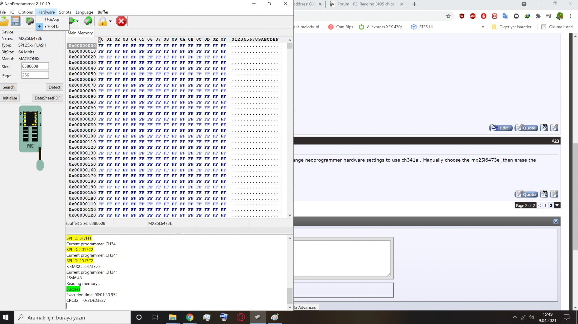

        Use the bios at post #17 ,i told you i added your DMI (serial number etc) and win key to it. Change neoprogrammer hardware settings to use ch341a . Manually choose the mx25l6473e ,then erase the chip,then open the file from post #17 and program
        • hallmark1730
          • Apr 2021
          • 27
          Re: X555ld rev 3.3
          I did the way you say. But I get the same error. please help me
            • 22279
            Re: X555ld rev 3.3
            plug the charger in,and the laptop off and try again

              if plug the charger do not read or write add picture.
              Even when I disconnect the usb, the light is on the programmer
              NEW EDİT:I don't know why, but now he programed it. Windows is opening, I will check if my video card problem is fixed
