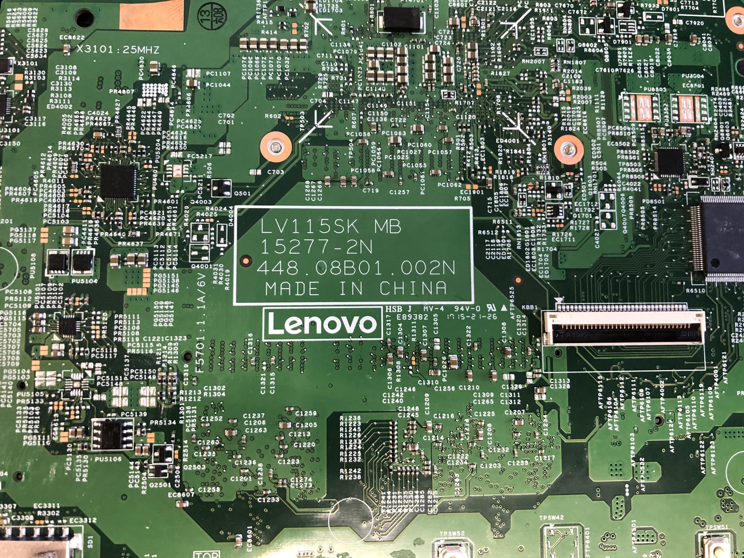

LENOVO V110-15ISK Need Bios
  • toufik sat
    replied
    Re: LENOVO V110-15ISK Need Bios
    thanks
    Leave a comment:
  • REPARACHIP.ES
    replied
    Re: LENOVO V110-15ISK Need Bios
    Originally posted by cezar_emanuel90
    Try this... This is for
    LV115sk MB
    1527-1N
    448.08B01.001N
    Without GPU
    thanks this file work on V110-15ISK 80TL
    Leave a comment:
  • andrew25
    replied
    Re: LENOVO V110-15ISK Need Bios
    here is clear me dump... 100% working
    Leave a comment:
  • peste
    replied
    Re: LENOVO V110-15ISK Need Bios
    Originally posted by huss584
    This my original BIOS Need Help
    try..
    Leave a comment:
  • huss584
    replied
    Re: LENOVO V110-15ISK Need Bios
    This my original BIOS Need Help
    Leave a comment:
    replied
    Re: LENOVO V110-15ISK Need Bios
    Originally posted by recep1982
    hi; pls help me bios and ec dump
    lv115sk mb 15277-2n pls help me
    Post your backups ,and the full laptop model number including machine Type.
    Last edited by SMDFlea; 11-04-2020, 08:28 AM.
    Leave a comment:
  • recep1982
    replied
    Re: LENOVO V110-15ISK Need Bios
    hi; pls help me bios and ec dump
    lv115sk mb 15277-2n pls help me
    Last edited by piernov; 11-04-2020, 07:39 AM. Reason: double post
    Leave a comment:
  • qz4n
    replied
    Re: LENOVO V110-15ISK Need Bios
    Mainah njoroge thank you
    Leave a comment:
    replied
    Re: Need bios bin file for Lenovo V110-15IAP
    Desolder the bios,thats your next step.
    Leave a comment:
  • Antimatt3r
    replied
    Re: Need bios bin file for Lenovo V110-15IAP
    Is there anything I can do about it now, or is the board fried?
    The laptop is completely unresponsive and dead, and the programmers barely read the bios anymore. Reading works sometimes, but the results look like a jumbled mess to me, and every other action (like ERASE, VERIFY, EMPTY ...) don't work.
    Also most of the time when connecting the clip, the PC gives "USB Not Recognized The last USB device you connected to this computer malfunctioned, and Windows does not recognize it" error.
    The programmer connection itself doesn't give that error, neither connecting the programmer with a bios from a different laptop...
    Leave a comment:
  • Antimatt3r
    replied
    Re: Need bios bin file for Lenovo V110-15IAP
    Originally posted by SMDFlea
    Are you using a clip ?
    Yes, this one:
    Leave a comment:
    replied
    Re: Need bios bin file for Lenovo V110-15IAP
    Are you using a clip ?
    Leave a comment:
  • Antimatt3r
    replied
    Re: Need bios bin file for Lenovo V110-15IAP
    Well fuck. I think I just shorted something on the mainboard
    I tested the laptop after the previous flashing, and it didn't work so I wanted to reflash it using AsProgrammer, but like a fucking genius I forgot to unplug the battery this time before connecting the programmer to usb, and now it's unresponsive, not event those 2 led lights blink anymore, and AsProgrammer or CH341A don't detect the bios properly anymore :facepalm
    Is there anything else left to do now?
    Leave a comment:
    replied
    Re: Need bios bin file for Lenovo V110-15IAP
    Try AsProgrammer software,its a good alternative.Choose CH341A in the hardware tab first,then choose the bios chip manually from the list.
    https://www.badcaps.net/forum/showpo...6&postcount=10
    Leave a comment:
  • Antimatt3r
    replied
    Re: Need bios bin file for Lenovo V110-15IAP
    Originally posted by peste
    try...extras site Lenovo
    Thanks, but it gives the same error "file length beyond range will be ignored". In fact, it gives the same message even if I try to flash the backup bios. Am I missing something? I used ERASE>BLANK>WRITE>VERIFY in CH341A Programmer, and everything seemed ok, beside the error message when opening the bios files.
    Anyway, I ignored the message and wrote the bios anyway, but nothing changed. The laptop is still dead. Only LED4 and LED2 are blinking intermittently.
    Maybe an older version of bios would work?
    Last edited by Antimatt3r; 07-10-2020, 04:36 AM.
    Leave a comment:
  • peste
    replied
    Re: Need bios bin file for Lenovo V110-15IAP
    Originally posted by Antimatt3r
    Here is my backup.
    Thanks in advance guys.
    try...extras site Lenovo
    Leave a comment:
  • Antimatt3r
    replied
    Re: Need bios bin file for Lenovo V110-15IAP
    Here is my backup.
    Thanks in advance guys.
    Leave a comment:
  • lapfix
    replied
    Re: Need bios bin file for Lenovo V110-15IAP
    Better is to post your backup dump
    Leave a comment:
  • Antimatt3r
    replied
    Need bios bin file for Lenovo V110-15IAP
    Hey guys.
    I have a major problem with this lenovo laptop. Windows 10 decided to update the bios by itself, but for some reason, after updating the laptop turned off and I haven't been able to turn it on ever since.
    All it does now, is spin the fan for a couple of seconds and then it turns off again. Also the led light is blinking every 2-3 seconds. Sometimes the screen turns on for a second as well, but it's completely grey/white and then it turns off again. If i let the battery connected or the charger plugged in sometimes it looks like it's trying to turn on, repeating the symptoms listed above.
    This behavior even happened a few times with the lid closed...
    Anyway, the weird thing is that I can't even find an older bios for it anymore. On the official Lenovo site there is only 1 bios file, and it's from this year. This is very weird since I know for a fact there was an older bios (maybe even 2) which Lenovo removed from the site for some reason...
    If anyone could help me out with a bios dump for this model it would be very much appreciated. Maybe there still are some older versions of bios for this model...
    I'll post the bios backup tomorrow.
    Leave a comment:
  • hassan.samanchi
    replied
    Re: LENOVO V110-15ISK Need Bios
    thnx working
    Leave a comment:
  • lucaszmn
    Summary of BIOS Whitelist Removal Problem Lenovo Thinkpad T560
    by lucaszmn
    Summary of BIOS Whitelist Removal Problem
    Problem:
    I am attempting to remove the WWAN card whitelist from my Lenovo ThinkPad T560.
    Initial Findings:
    • My current BIOS version is N1KET58W (1.45).
    • I have a CH341A programmer and have successfully created two full backups of my BIOS.
    • I have the ability to use command-line tools on a Linux machine.
    Troubleshooting Steps & Conclusions:
    • I attempted to use several automated and manual patching methods on my N1KET58W (1.45) BIOS, including using hex strings. These attempts all failed.
    • I concluded that the
    08-12-2025, 03:01 PM
  • Wahaz
    by Wahaz
    10-30-2023, 08:42 PM
  • grimacelord
    Lenovo Legion T5-26AMR5 Desktop - Corrupt BIOS
    by grimacelord
    Hello there.
    I am working on a Lenovo Legion T5-26AMR5 desktop that currently has a corrupt BIOS and I have been unsuccessful thus far in trying to fix it myself.
    History:
    1. This computer came to me initially with an error message that said "BiInitializeLibrary failed 0xc0000001" or "0135 fan error". It would always be one of the two errors. It should be noted that when it produced the fan error, there was no physical problem with the fans. They were all spinning just fine.
    I searched for this error online and discovered...
    03-15-2023, 03:29 PM
  • jendkkd jeje
    Lenovo IdeaPad 330 15-AST 81D6 BIOS Recovery
    by jendkkd jeje
    So a couple of years ago i got a bios update through Lenovo Vantage, so i installed it and bricked my whole BIOS, so i couldn't fix it so i put that ideapad in a box, 3 years later i found that one PC and want to recover it to switch from a 2014 hp laptop to this one.
    I found a method to recover the BIOS of many lenovo laptops tha consists in pluging in a USB Flash with the BIOS files and power on the laptop with Fn + R keys pressed until fans go loud and start beeping loud, but nothing worked, so i think filename is wrong, i tried naming the bios file as 07WW.BIN, BIOS.BIN, BIOS.fd,...
    10-11-2024, 03:12 PM
  • 1g0r
    Lenovo ThinkPad L15 G3 Bios 1 IC conductor track
    by 1g0r
    First, the data in brief:
    Manufacturer: Lenovo
    Model: ThinkPad L15 G3 21C3-0016GE
    motherboard: LG4 LT5 ADL RT UMA MB 8L - 448.0PZ26.0011
    IC Bios 1: MX77L25650F
    IC Bios 2​: MX25L25673G
    EC Chip: NPCX997KAABX
    So far I've been a silent reader, but now I need your help
    I bought a laptop. The seller said the bios was locked. I was looking for a way to remove this ban.
    I then got the CH341A and pulled the corresponding files from here https://www.badcaps.net/forum/troubl...evices-and-ele...
    The laptop was brought in with a BIOS problem and a password. After reading the dump, the information was damaged. I ask for help in the BIOS with a clean ME region. Motherboard 213035-1. Serial number: PW+04e998, Type number: 21c3-0016ge
    01-18-2025, 02:39 AM
