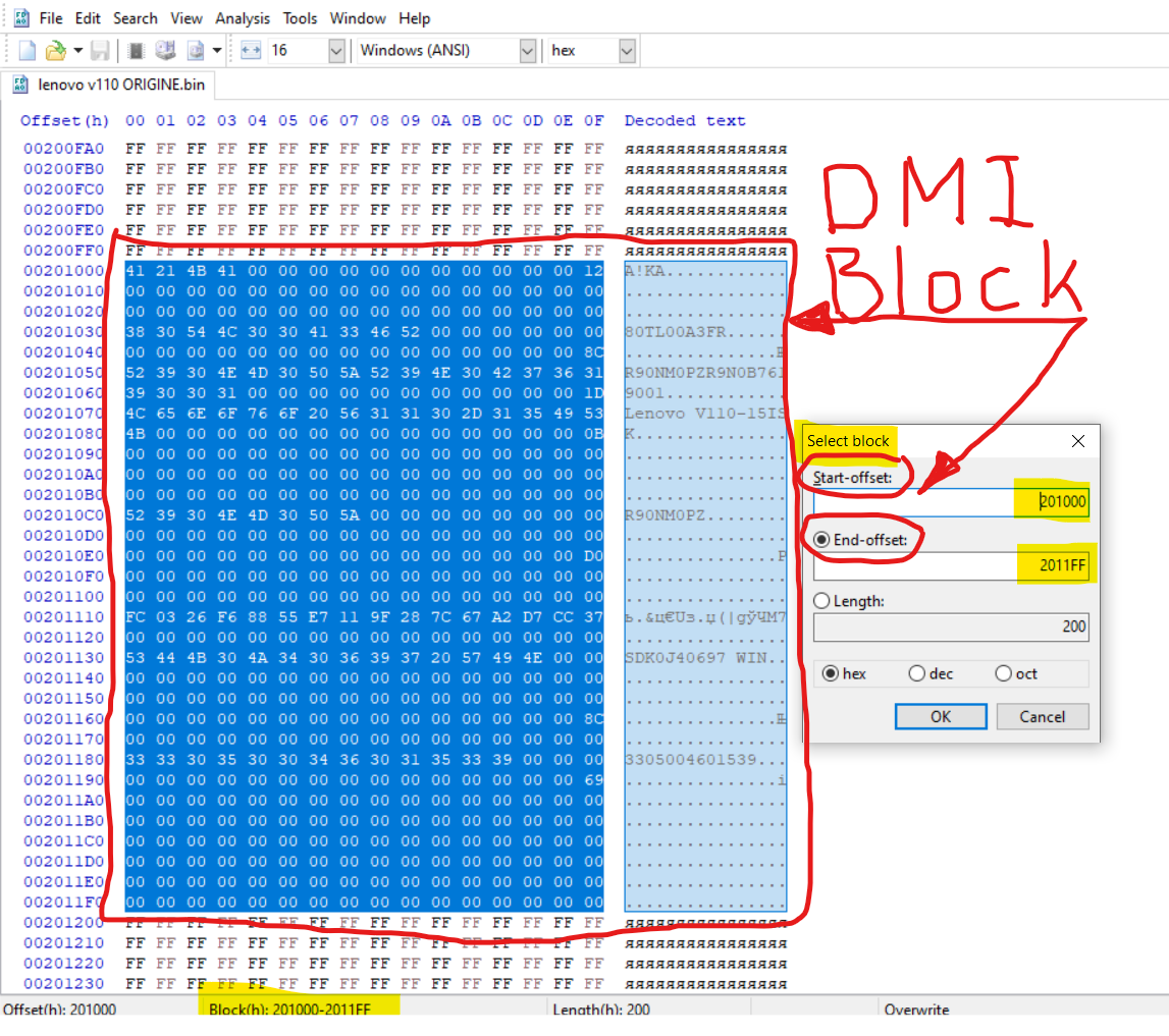

LENOVO V110-15ISK Need Bios
  • Fadda88
    replied
    Re: LENOVO V110-15ISK Need Bios
    [QUOTE=peste;1129574]
    Originally posted by ramrk
    try..
    DMI 201000 - 2011FF
    thanks, works perfectly.
    Leave a comment:
  • bouny56
    replied
    Re: LENOVO V110-15ISK Need Bios
    Thx for your help
    Last edited by SMDFlea; 08-27-2023, 12:54 AM.
    Leave a comment:
  • bouny56
    replied
    Re: lenovo v110-15Isk
    Originally posted by hoaca388
    V110-15ISK Laptop (Lenovo) - Type 80TL
    Serial number : R90Q3GKJ
    Thanks works for me
    Leave a comment:
  • bouny56
    replied
    Re: LENOVO V110-15ISK Need Bios
    Originally posted by Vesko356
    DMI block (this block contain your serial number, laptop model name and so on...) with start and end offsets:
    Another block you must transfer from your original bios backup to the new file is the block containing Windows key, offsets are already mentioned in my previous post.
    Wow thanks for this ! Very interesting
    Leave a comment:
  • Vesko356
    replied
    Re: LENOVO V110-15ISK Need Bios
    Originally posted by bouny56
    I don't understand the "dmi and windows key" but ok i will try the #51 and #60 thx
    DMI block (this block contain your serial number, laptop model name and so on...) with start and end offsets:
    Another block you must transfer from your original bios backup to the new file is the block containing Windows key, offsets are already mentioned in my previous post.
    Leave a comment:
  • bouny56
    replied
    Re: LENOVO V110-15ISK Need Bios
    Originally posted by Vesko356
    Use the bios attached at post #51, #60 etc.
    Offsets for:
    DMI -> 201000 - 2011FF
    Windows key -> 278970 - 2789AF
    I don't understand the "dmi and windows key" but ok i will try the #51 and #60 thx
    Leave a comment:
  • Vesko356
    replied
    Re: LENOVO V110-15ISK Need Bios
    Originally posted by bouny56
    Hello, can you help me please
    Lenovo V110-15ISK
    mb :
    lv1155sk 15277-1n
    Voltages ok on coils , fan ok, hdd start, but no display
    Check cable, screen ok
    Can you check my bios please?
    Use the bios attached at post #51, #60 etc.
    Offsets for:
    DMI -> 201000 - 2011FF
    Windows key -> 278970 - 2789AF
    Leave a comment:
  • bouny56
    replied
    Re: LENOVO V110-15ISK Need Bios
    Hello, can you help me please
    Lenovo V110-15ISK
    mb :
    lv1155sk 15277-1n
    Voltages ok on coils , fan ok, hdd start, but no display
    Check cable, screen ok
    Can you check my bios please?
    Leave a comment:
  • recep1982
    replied
    Re: LENOVO V110-15ISK Need Bios
    thank you bro. test ok.
    Leave a comment:
  • Bonzas
    replied
    Re: LENOVO V110-15ISK Need Bios
    Originally posted by recep1982
    pls help me
    bro help me. orginal bios no booth.thanks
    Try
    Leave a comment:
  • recep1982
    replied
    Re: LENOVO V110-15ISK Need Bios
    pls help me
    bro help me. orginal bios no booth.thanks
    Last edited by Vesko356; 06-16-2023, 09:49 AM. Reason: Posts merged.
    Leave a comment:
  • mohammed mohan
    replied
    Re: LENOVO V110-15ISK Need Bios
    thanks
    Leave a comment:
  • peste
    replied
    Re: LENOVO V110-15ISK Need Bios
    Originally posted by musanide
    i need help with cleaning this bin lenovo v110 LV115SK, the fan just spins a bit the stops and later start to run at full speed with no display
    have you tried a bios from this thread??? see what others have used and said they are OK, depending on your laptop model..
    Leave a comment:
  • musanide
    replied
    Re: LENOVO V110-15ISK Need Bios
    i need help with cleaning this bin lenovo v110 LV115SK, the fan just spins a bit the stops and later start to run at full speed with no display
    Leave a comment:
  • luckyfahad79
    replied
    Re: LENOVO V110-15ISK Need Bios
    Here you go
    Leave a comment:
  • hoaca388
    replied
    Re: LENOVO V110-15ISK Need Bios
    Originally posted by Kesavan
    I need bios for 15277-1N v110-15ISK
    V110-15ISK Laptop (Lenovo) - Type 80TL
    Leave a comment:
  • Kesavan
    replied
    Re: LENOVO V110-15ISK Need Bios
    I need bios for 15277-1N v110-15ISK
    Leave a comment:
  • rbvndonh
    replied
    Re: LENOVO V110-15ISK Need Bios
    Somebody have working bios for 80TL01CVMX (V110-15ISK with embedder 4gb ram)?
    Leave a comment:
  • peste
    replied
    Re: LENOVO V110-15ISK Need Bios
    write back the bios chip with post#36.. see if it charges the battery... it might stop blinking... when the battery is finished charging..
    Last edited by piernov; 08-14-2022, 10:39 AM. Reason: remove full quote of previous post
    Leave a comment:
  • Calgacus
    replied
    Re: LENOVO V110-15ISK Need Bios
    Tried that bios file in post 36, but still same flashing power LED no display. getting fan spin but forgot to say i had that originally anyway
    Edit:Update: i left it for a few mins whilst on the phone, i've came back and it's powered up to windows, but the power LED is still flashing
    Im wondering if this is a hardware fault
    Update:Whilst in windows, Ive downloaded the latest bios file from Lenovo for this laptop and installed this through the .exe for windows. It flashed fine with no errors
    The power LED stays on solid now but i get no display, no backlight either. grrrr
    Any Ideas ?
    Last edited by Calgacus; 08-14-2022, 06:47 AM.
    Leave a comment:
  • lucaszmn
    Summary of BIOS Whitelist Removal Problem Lenovo Thinkpad T560
    by lucaszmn
    Summary of BIOS Whitelist Removal Problem
    Problem:
    I am attempting to remove the WWAN card whitelist from my Lenovo ThinkPad T560.
    Initial Findings:
    • My current BIOS version is N1KET58W (1.45).
    • I have a CH341A programmer and have successfully created two full backups of my BIOS.
    • I have the ability to use command-line tools on a Linux machine.
    Troubleshooting Steps & Conclusions:
    • I attempted to use several automated and manual patching methods on my N1KET58W (1.45) BIOS, including using hex strings. These attempts all failed.
    • I concluded that the
    08-12-2025, 03:01 PM
  • Wahaz
    by Wahaz
    10-30-2023, 08:42 PM
  • gestalt.exe
    Lenovo Legion Y540 – Need help repairing BIOS after bad downgrade
    by gestalt.exe
    Hi everyone,
    My Lenovo Legion Y540 (i7-9750H, RTX 2060) bricked after I downgraded from BHCN44WW to BHCN21WW.
    Laptop stopped booting entirely.
    I used a CH341A programmer to dump the corrupted 16MB BIOS.
    i then attempted the following:
    1. Downloaded stock BIOS BHCN39WW from Lenovo
    2. Trimmed it to 16MB
    3. Extracted the BIOS region from the corrupted dump
    4. Extracted the BIOS region from the stock 39WW
    5. Replaced the corrupted BIOS region with the stock one (within hxd , opened the corrupted dump and replaced its region by the stock)
    6. Injected back my LDGB / DMI
    11-30-2025, 10:38 AM
  • grimacelord
    Lenovo Legion T5-26AMR5 Desktop - Corrupt BIOS
    by grimacelord
    Hello there.
    I am working on a Lenovo Legion T5-26AMR5 desktop that currently has a corrupt BIOS and I have been unsuccessful thus far in trying to fix it myself.
    History:
    1. This computer came to me initially with an error message that said "BiInitializeLibrary failed 0xc0000001" or "0135 fan error". It would always be one of the two errors. It should be noted that when it produced the fan error, there was no physical problem with the fans. They were all spinning just fine.
    I searched for this error online and discovered...
    03-15-2023, 03:29 PM
  • to5it0
    Need Clean BIOS/EC Bin File for Lenovo ThinkPad Yoga 11e 2H1703-27220F Rev. A Marked as U2501 on the motherboard.
    by to5it0
    Need Clean BIOS/EC Bin File for Lenovo ThinkPad Yoga 11e - Stuck with 0275 Error CMS
    I am attempting a repair on a Lenovo ThinkPad Yoga 11e that is currently stuck at boot with the error: "0275 error CMS" even after setup new bios battery and will not allow me to enter the BIOS/Setup.
    This is a critical issue that I believe requires flashing the BIOS chip directly using a programmer (e.g., CH341A/RT809H), as standard software updates or resets are not possible.
    I have opened the laptop and identified the main BIOS chip...
    10-24-2025, 01:35 AM
