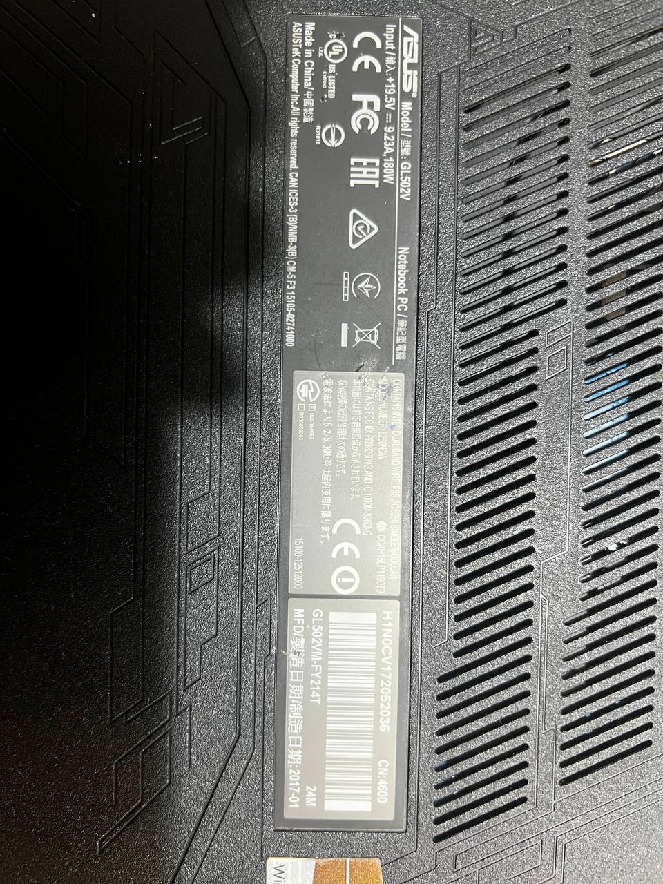

                        hi
                        I need the original bios of this generation, my laptop is gaming, please help and guide, thank you very much
                        gl502vm 2.1
                        GL502VM-FY214T
                        i7 7700hq
                        gtx 1060 6g
                        Model / EH: GL.502V

                        #32
                        Can you help me find the original BIOS or send it to me?
                        H1NOCV172052036
                          • 20643
                          #33
                          Originally posted by mihanbaran
                          hi
                          gl502vm 2.1
                          GL502VM-FY214T
                          i7 7700hq
                          gtx 1060 6g
                          Model / EH: GL.502V
                          The serial number is the long one beginning with H1N . Have you made a bios backup ? ,if you have post it in a zip or rar attached to your post.
