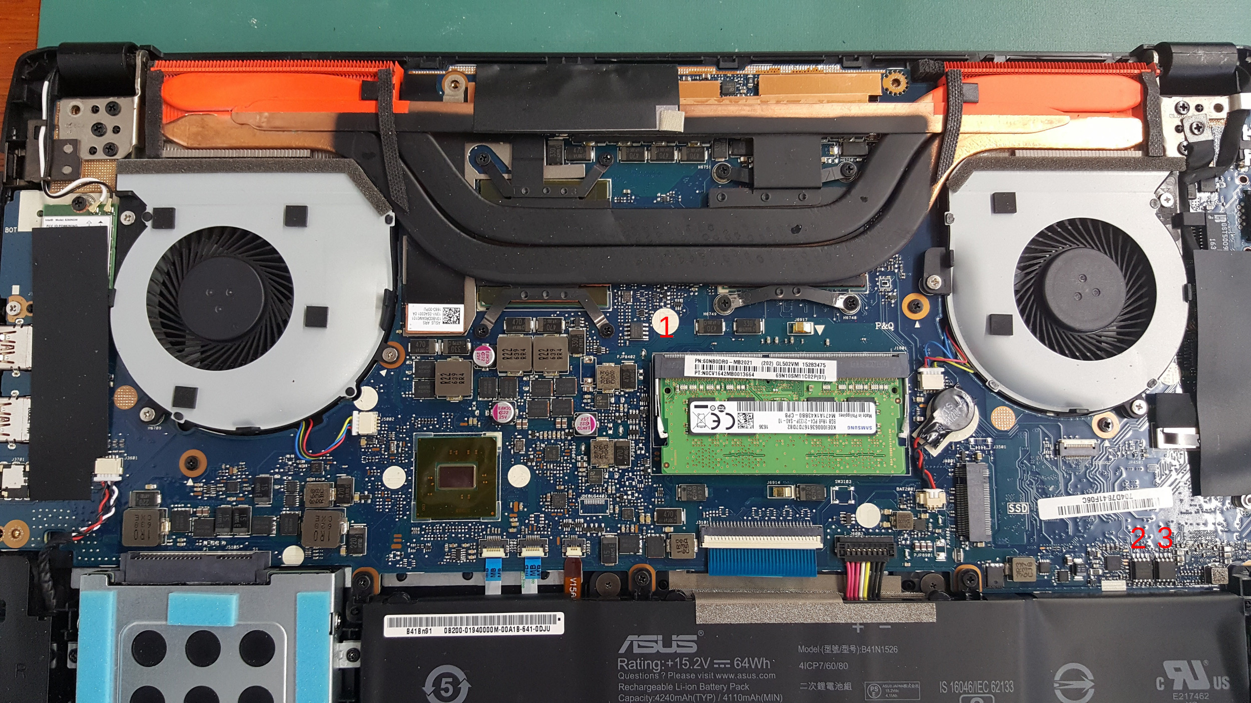

    HI,
    Looking for bios image for the GL502VM (NOT the GL502VMK).
    Also, I'm a bit puzzled, there are 3 serial flash chips on this motherboard. Which one(s) are the bios?

    Re: Asus ROG GL502VM G502VM Bios
    Mainboard name, and revision
      GL502VM
      Rev 2.0
        try this
          Thank, I will do try.
          Onlly one chip is 64Mb so no confusion after all.
          Any idea what are the other two 8Mb chips? ... just curious.
            Try to replace only W25Q64 , if not , let me know to search for all
            tell me the name of other 2 cip
              The two other chips are W25Q80.
              One of your files was the correct bios file. Thank you!
              But I still have weird blue screens in Windows 10. On the other hand, Ubuntu seems to run without problems. Will try to reinstall Win10.

                See if the hard drive operating system is legacy or uefi ,
                  Originally posted by JLCurve
                  HI,
                  hey was just wondering what number(in your photo) was the correct chip
