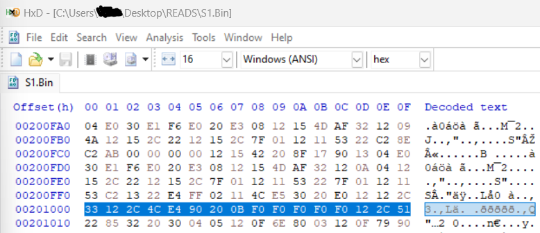

                Offset 201000 , scancode https://www.win.tue.nl/~aeb/linux/kbd/scancodes-1.html

                  #29
                  Originally posted by SMDFlea
                  According to your link, that would be Keypresses:
                  07 = Key 6
                  03 = Key 2
                  30 = Key B
                  0B = Key 0
                  22 = Key G
                  02 = Key 1
                  2F = Key V
                  08 = Key 7
                  60 = ???
                  What stands 0x60 for? I tried different variations, no success so far. Its a detachable Lenovo Keyboard, German layout, no number block
                  • Joho
                    • Oct 2010
                    • 24
                    #30
                    Originally posted by Joho
                    Success!
                    I managed to get the password, first byte is the length, last byte is checksum.
                    Thanks to all of you!

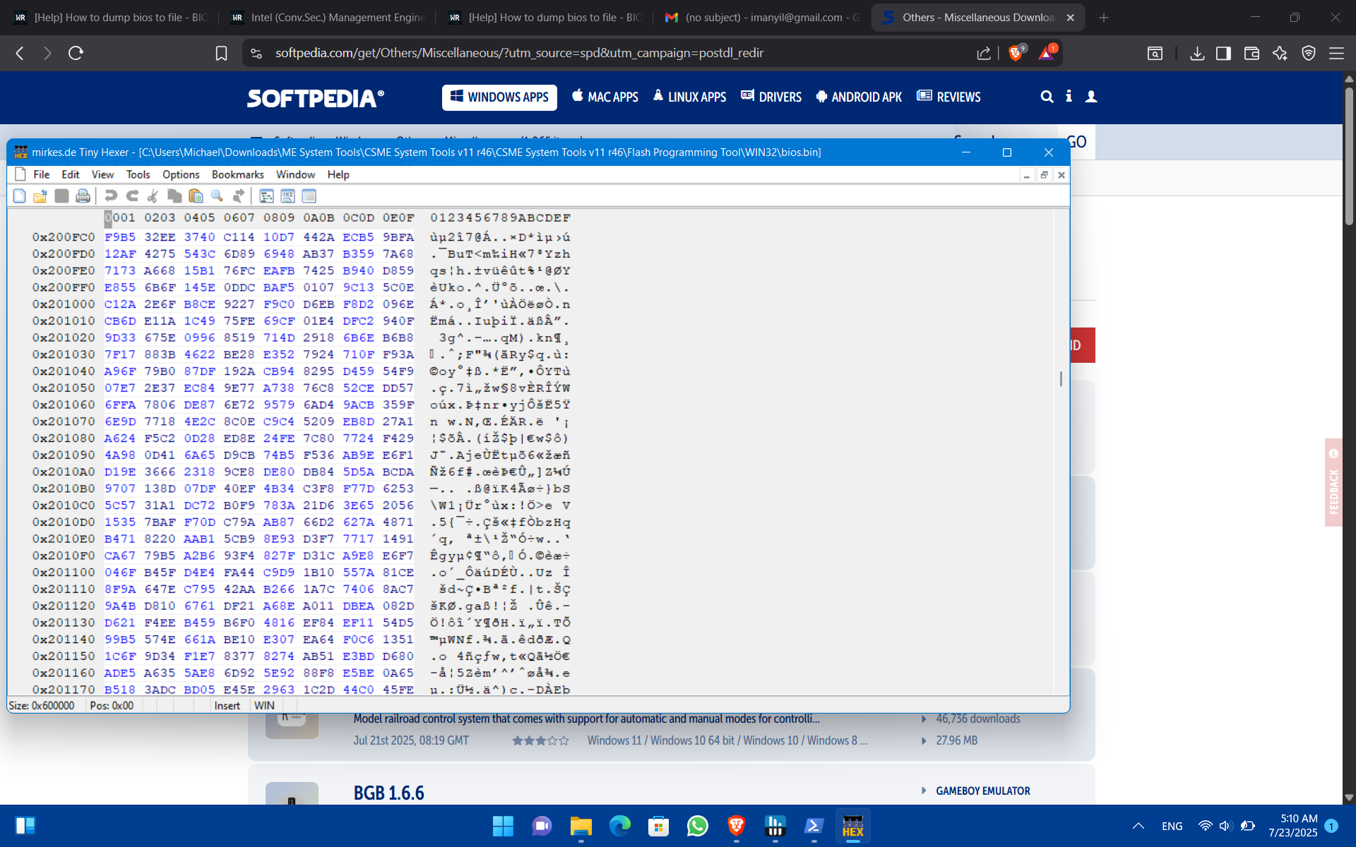

                                #36
                                Ok thank you.
                                I think i have dumped the bios file now.
                                What is the tool in screen shoots above that dumps the hex addresses?
                                It appears that InnoExtractor wan's a manufacturer's .exe file to extract the bios from it..

                                  #37
                                  OK Tiny Hexer, found it.
                                  Is it possible to extract the pass key from here?

                                    How did you make the backup. Post your backup

                                      #39
                                      I'll attach my dump just in case as well..
                                      FPTW.exe -bios -d bios.bin
