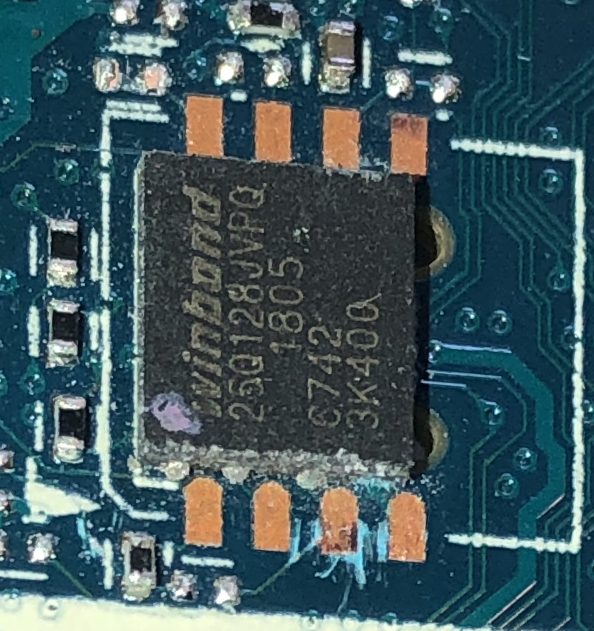

                      #70
                      Re: hp elitebook 840 g4 need password unlock
                      I've attached a picture of the chip ... does this look correct ?

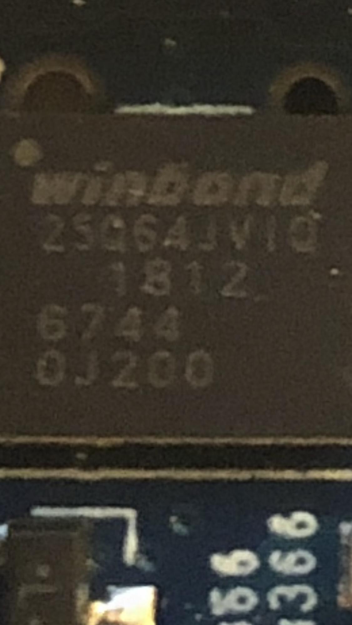

                              • RethoricalCheese
                                • Mar 2013
                                • 1519
                                • Estonia
                                #75
                                If you want to read HP eeproms onboard with a clip you need to first unplug battery. Plug charger. Turn on laptop (go to F1 screen or bios, doesnt matter). Turn off laptop but keep charger plugged in. And now connect your clip and programmer. This way it almost always works fine.
                                But the one you sent a pic of is not correct. It is the other one with 128 written on it, not 64.

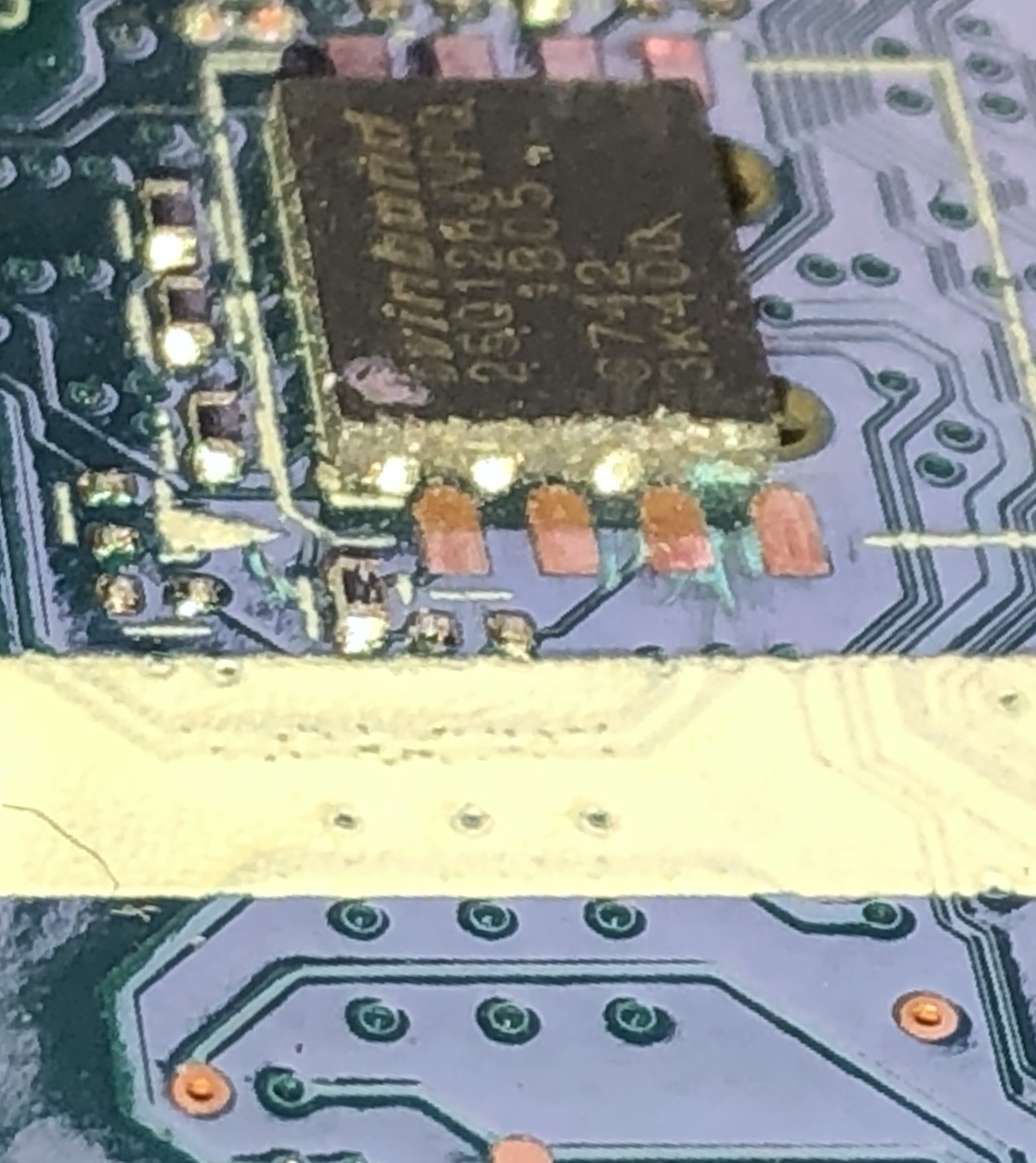

                                  #76
                                  I'm obviously new to all this and doing things the wrong way.
                                  The clip I'm trying to use is attached to a Raspberry PI - I thought that gave it all the power it needed ?
                                  In the hope of getting to the bios chip a bit better I've removed the motherboard.
                                  I've take pictures of the chip - I've no idea how to get a clip on this so contact is made correctly and unsure whether I can heat gun the chip off the board.
                                  Has anyone any experience of dealing with a similar chip ?
                                    Either you need to unsolder it or solder wires on the large pads around the chip.

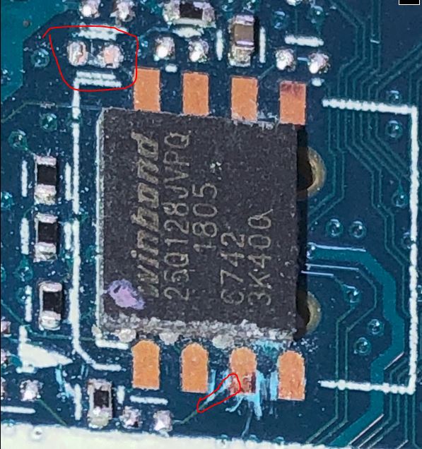

                                      #78
                                      I managed to get it off the motherboard and flashed it using my Pi - unfortunately on reconnecting everything the laptop doesn't turn on - so I guess I've messed something up somewhere.
                                      I may give up.
                                      The power light (the main one on the switch) and the Caps Lock light go off then come on again in a cycle.
                                      I've had a hunt for whether this means something but am find mixed answers.
                                        • 22275
                                        #79
                                        It looks like you`ve knocked a part off the board.Check the traces as well for continuity,you might have cut through one of them.

                                          #80
                                          I'll have a look - there's a strong possibility the bios chip isn't sat quite in the right place - it just sits on top of the board rather then having legs going through it - so getting it in the right place seems like a bit of hit and miss...
