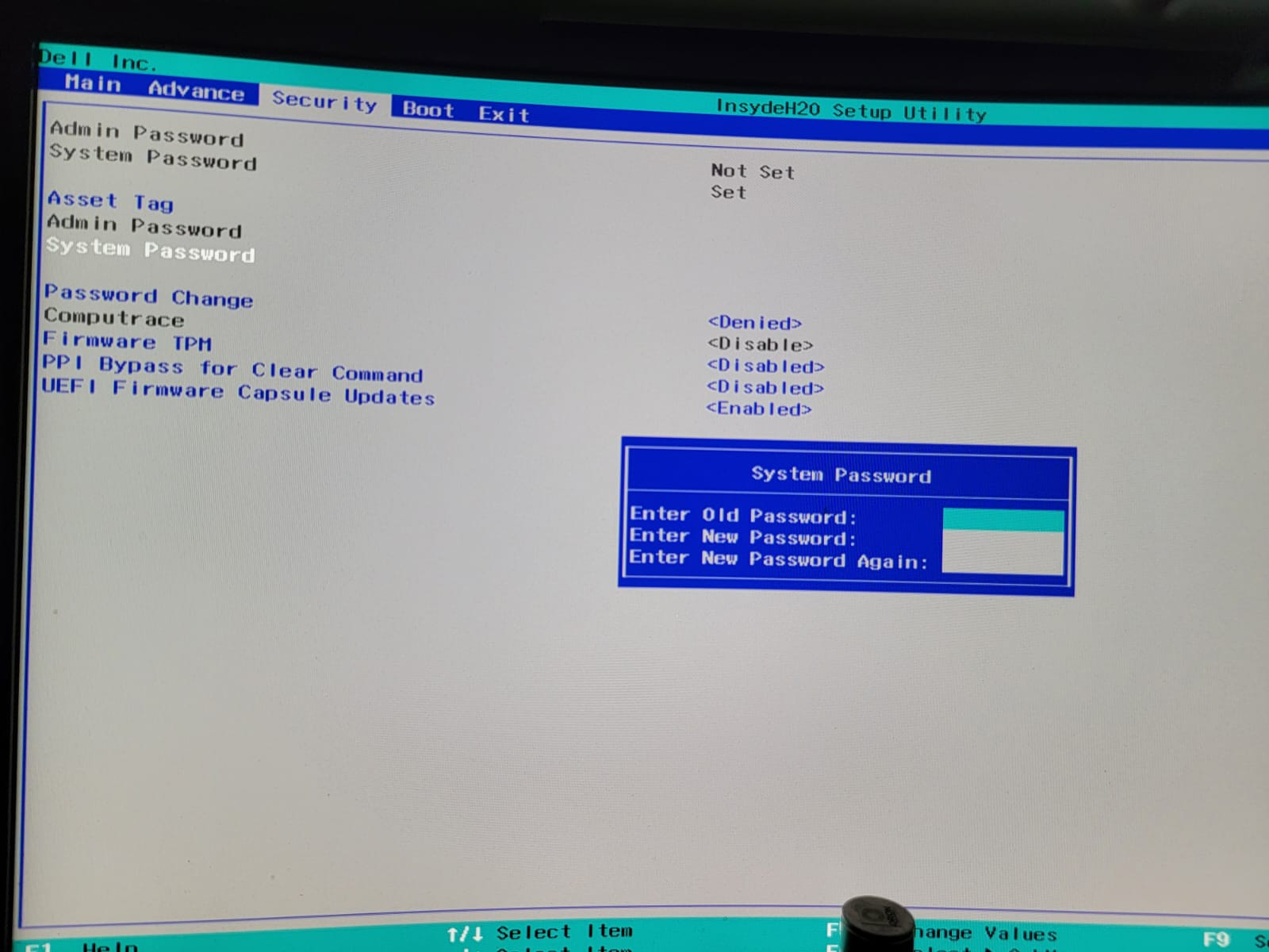

    I have a Inspiron 11 3185, and in the BIOS setup under Security it shows "Locked Setup", which limits pretty much everything in the BIOS. I'm using bios-pw.org to generate the codes for the hash, but they never work for the Locked Setup password. The codes generated for the System password and the HDD password work fine, but the code for the Locked Setup password always fails. I don't understand, if it works for the first two, why is it not working for the Locked Setup p/w? Since I can't disable it, anytime I reboot, even after a Windows update, I have to go through the hassle of generating the codes for the System and HDD p/ws.
    One of the hash code examples given for Dell is -595B, but when I append it to my hash and generate the code, it says it's for Fujitsu-Siemens hexdigits, not a Dell model. Is this normal? The only way I can get the codes to work for the System and HDD is to append my Dell Service Taq code, which it then detects as a Dell Latitude 3540, which is still not my Inspiron 11 3185, but it works for the System and HDD passwords.
    I would love to just call Dell and resolve this, but they want to charge me $30 just to give me a code. Seriously, couldn't Dell just as easily provide a way for owners to verify their ownership online, allowing a verified user to simply enter their lock code, and thus receive their unlock code.

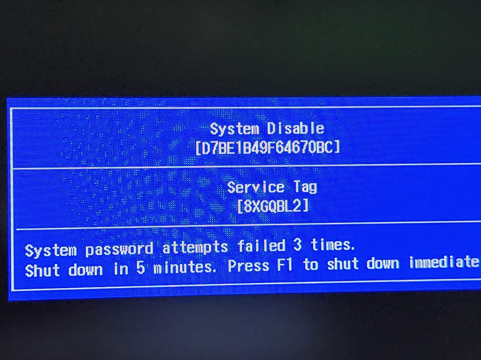

      Hello, could you unlock, try with Hash Code and it doesn't work
        What's the code, upload screenshot?

          Re: Locked Setup Fails to Unlock with Correct Password - Inspiron 11 3185
          here!
            here!
            Password = 60560264
              The code works to enter the BIOS, but when I try to unlock the System Password it does not accept the code, when I restart the computer it locks again and does not accept the code they gave me...

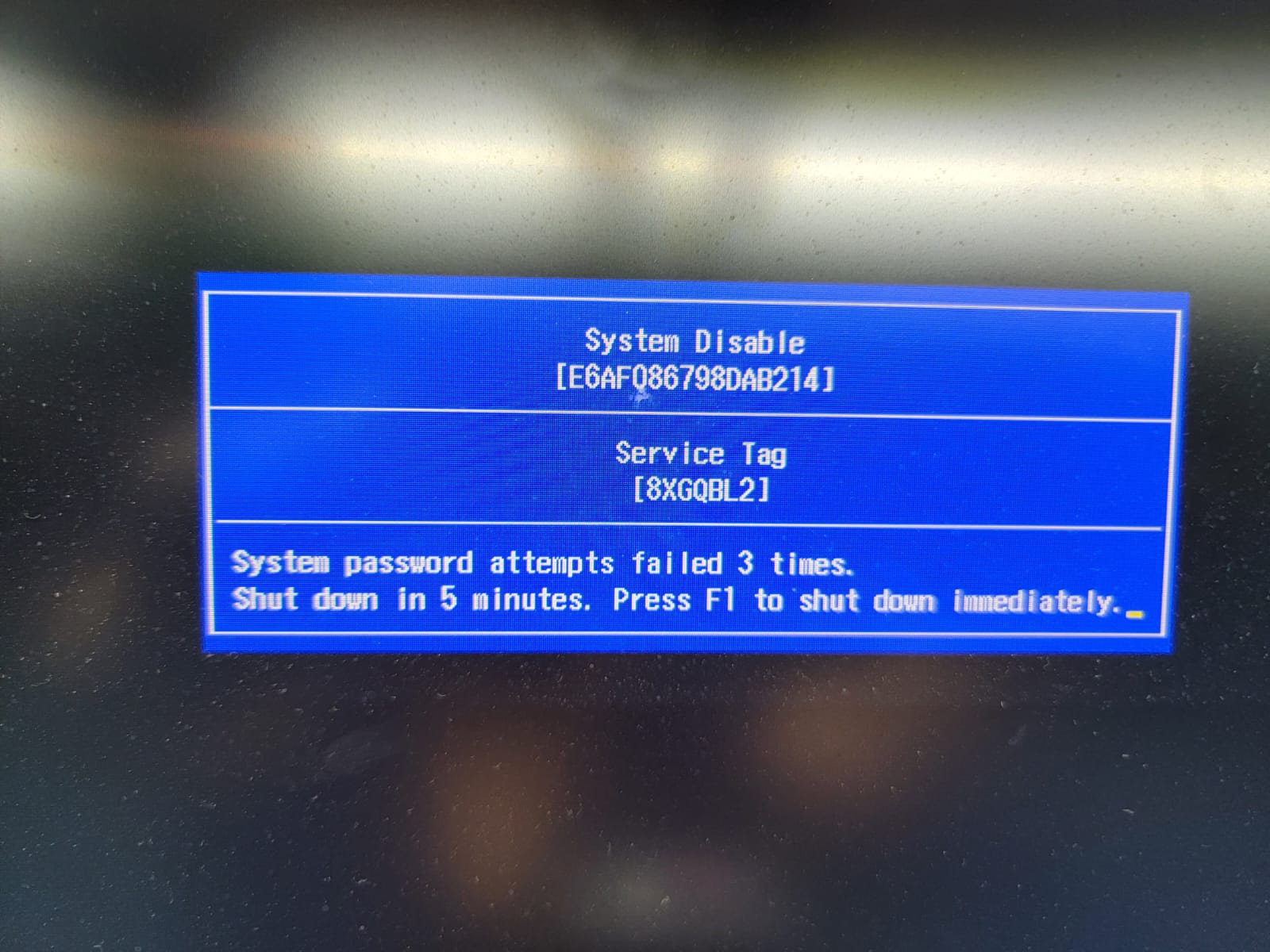

                try 70887185
                your bios shows Service Tag HS7XBL2
                  At a password prompt screen to enter the bios input the password, press and hold left CTRL key down and press ENTER key twice (CTRL-ENTER-ENTER).
                  try 70887185
                  Yes, this password is correct for the new system disable code.
                    thank you very much it worked with holding the left CTRL key and pressing the ENTER key twice (CTRL-ENTER-ENTER).
                      You're welcome.
                      Now do yourself a favor and read the "BIOS guides, methods, resources and tools" thread to avoid wasting my (and your) time on your next request, because this key sequence is mentioned there.
