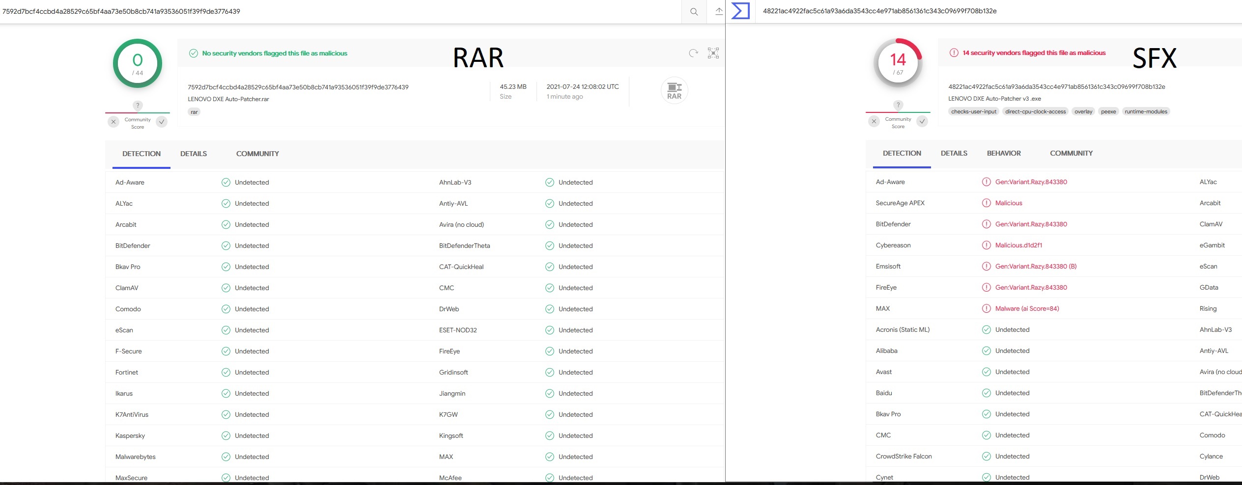

                  I think I understood. I have a problem with Winrar's SFX archives.
                  This is detected as malware in SFX, while just in rar, it's ok.
                  the problem is not detected by all antivirus.
                  On Google, there are many posts about this problem.
                  I don't know how to solve this problem. too bad for SFX, just do CMD otherwise.
                  Who tried my file??
                  I haven't had any feedback yet it has been downloaded about fifty times.

                      #1430
                      Re: Remove_SMM... UEFI.
                      This is detected as malware in SFX ......
                      So i changed the version of winrar which triggers the antivirus so now to old winrar 3.11.
                      I also alleviating python and removing unnecessary files.
                      also reduces splash screen time.
                      Files scanned with VIRUSTOTAL.com, it's OK now.
                      The archive goes to 20MB at 6MB with the new version.
                      Still only for Windows 10 32 / 64bits users
                      scan virus here : https://www.virustotal.com/gui/file/...3897/detection
