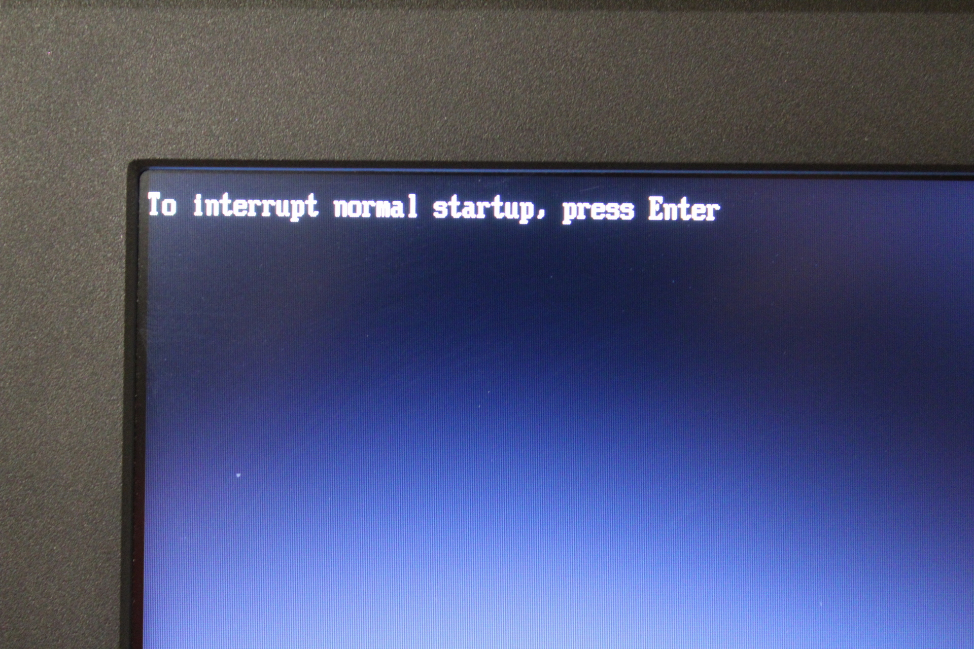

          Maybe someone can help me.
          I have a Lenovo T550 with a Macronix MX25L12873L BIOS chip.
          I created a BIOS dump using autopatcher.
          Reading, writing, no problem.
          When I start the notebook I hear 5x beeps 5x beeps and only see "to interrupt normal startup press enter" that was it. Enter does not work.
          Maybe someone can edit the original dump to make it work.
          The same Lenovo T550 with Winbond chip is no problem.
          Here is the original dump.
          Many Thanks
