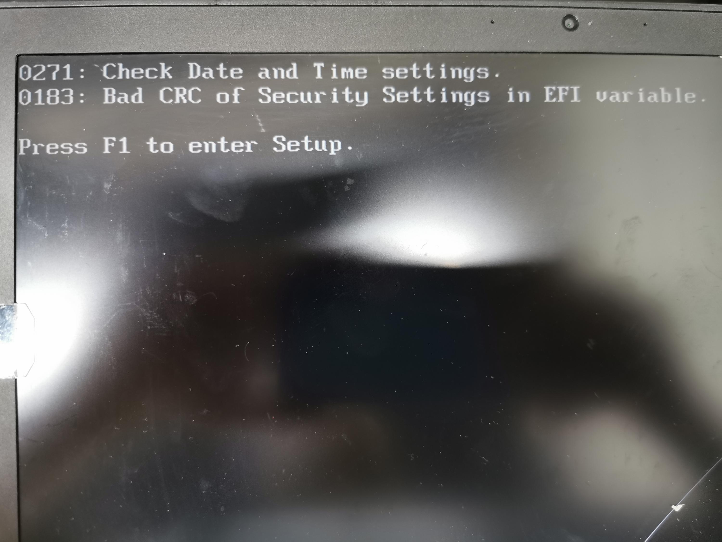

      Originally posted by aldopc
      Try this how it went with the x1 carbon patch
      not working
      it stuck ,look to pics in attachments

        #843
        Re: Remove_SMM... UEFI.
        Originally posted by daasco
        not working
        try this file and valid with any key

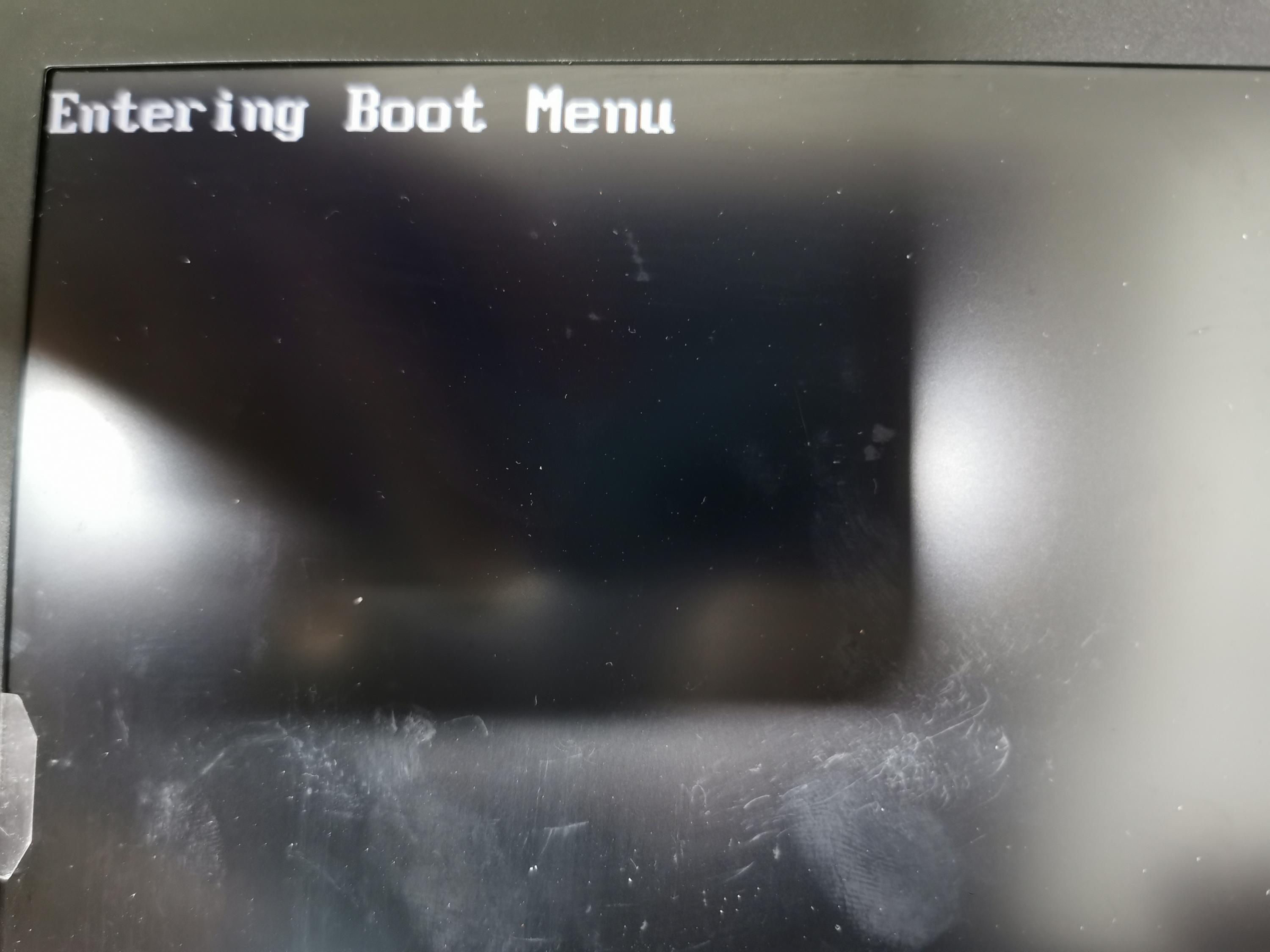

              same as before WITH NEW SCREEN

                #847
                same as before
                1. Remove The Battery CMOS . Also make sure laptop's main battery is out and disconnect the internal front battery if used (many new Lenovo may have an internal battery, the black box) by removing its connector from the motherboard. It is important that the laptop will have NO The main Battery attached and the NO Battery CMOS .
                2. Insert other LOCK HDD OR SSD M.2 ( by the way use another laptop set up password lock HDD and remember your password )
                3. ReFlash BIOS with patched file
                4. The First Step Let Press Down and Still Keep Little Switch ( picture attached ) long time and The Second Step Let Plug in the AC adapter and wait for a few seconds, the laptop will start by itself (if not, press the Power button and start it). You may hear some beeps then you will see the Lenovo splash image, press F1 to get the SVP password prompt and enter "1234" for SVP and press Enter. Next page will showing "Press any key..". Wait about 10 to 12 seconds before pressing any Key. Next it will display the warning message and the laptop hardware ID. Do not disconnect the AC during this process!

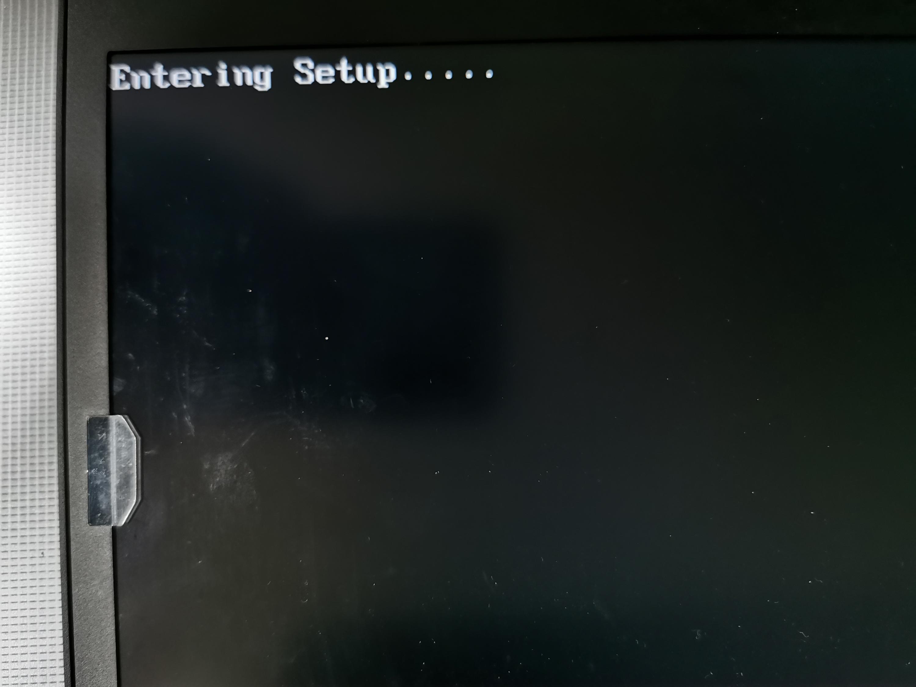

                    1. Remove the battery cmos . Also make sure laptop's main battery is out and disconnect the internal front battery if used (many new lenovo may have an internal battery, the black box) by removing its connector from the motherboard. It is important that the laptop will have no the main battery attached and the no battery cmos .
                    2. Insert other lock hdd or ssd m.2 ( by the way use another laptop set up password lock hdd and remember your password )
                    3. Reflash bios with patched file
                    4. The first step let press down and still keep little switch ( picture attached ) long time and the second step let plug in the ac adapter and wait for a few seconds, the laptop will start by itself (if not, press the power button and start it). You may hear some beeps then you will see the lenovo splash image, press f1 to get the svp password prompt and enter "1234" for svp and press enter. Next page will showing "press any key..". Wait about 10 to 12 seconds before pressing any key. Next it will display the warning message and the laptop hardware id. Do not disconnect the ac during this process!
                    i did all steps you mentioned and i press 1234 and hardware id appeared after pressing enter i wait for moment message appear that security reset
                    and pressed power button then again on but laptop stuck
                    you can see the picture
                    thank you

                      #850
                      thank you
                      KEY :1234567
                      . Now you need to press Space twice
                      . You can now power off the lenovo and reflash the original dump

                          #852
                          Originally posted by Ghamidi
                          I DID AND ITS WORKED
                          THANK YOU SO MUCH
