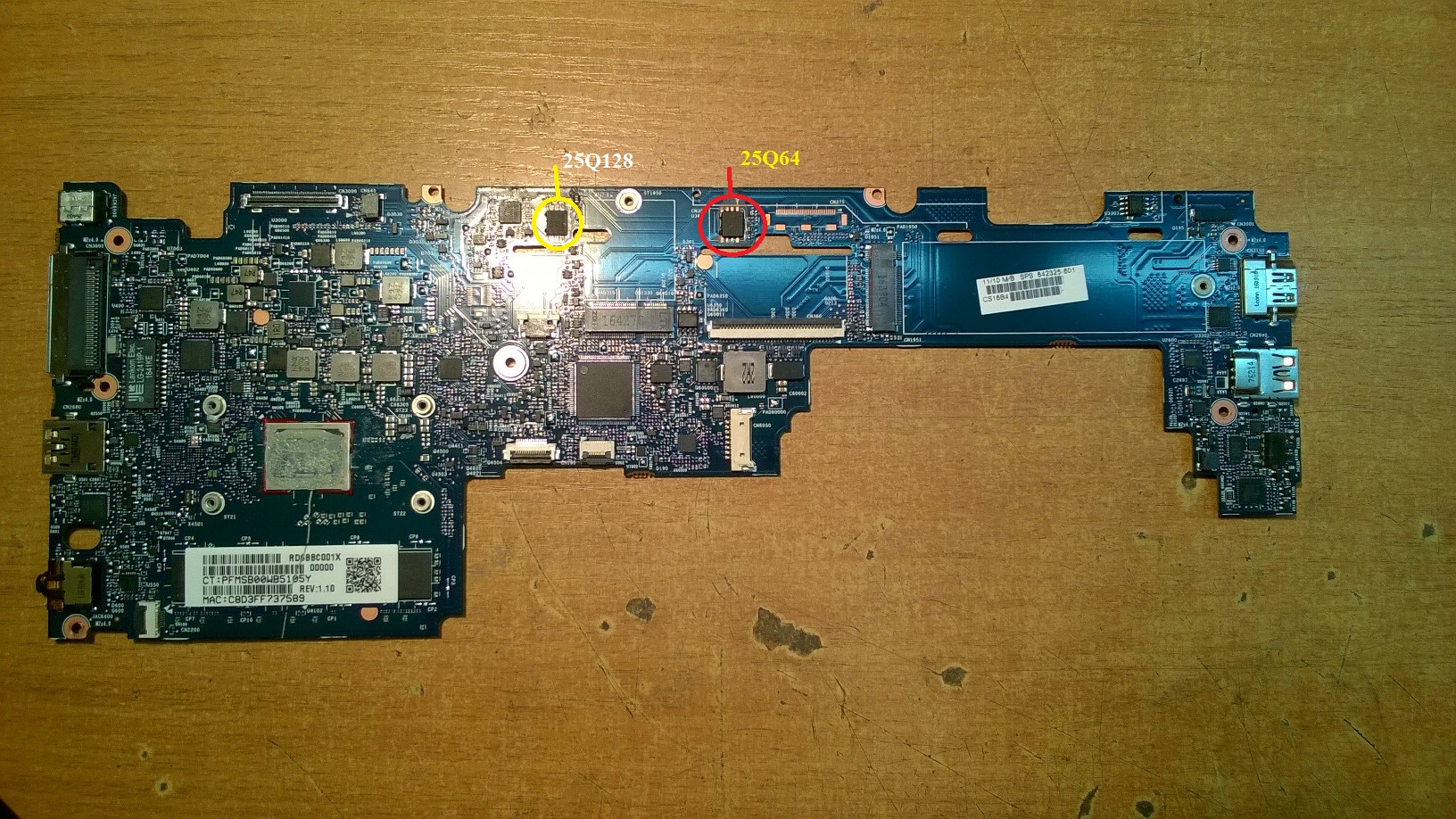

    Hi everyone, is there any of you have the bios for this motherboard?
    i need both EC and PCH, please help, Thanks

    the board part number is 6050a2736001-mb-a01
    very desperate here, anyone please help

      Re: HP Folio 1030 G1 Bios needed, please help..
      read your eproms and post here i might be able to help

          sorry for taking too long, i'm totally new and need to order the programmer..
          I've tried to check with EUFI tool, it turns out to be quite a mess and doesn't appeared to be a correct bios file, i was comparing it with another laptop's bios file which has proper structure imo.
          Anyway, here is the bin file dumped from 25Q64 chip

                do you also have the 25q64 dump?
                here is my 25q128fv (just realized it was 16MB)
                        Here i attached the board picture with the eprom location and my mess up 25Q64 dump
                          does anyone have the schematic of this board? i'm curios with the 25q64's function on this machine, thanks
                            is there anyone with access to this site for downloading the dump?
                            the file size seems to be containing more than 16MB dump
