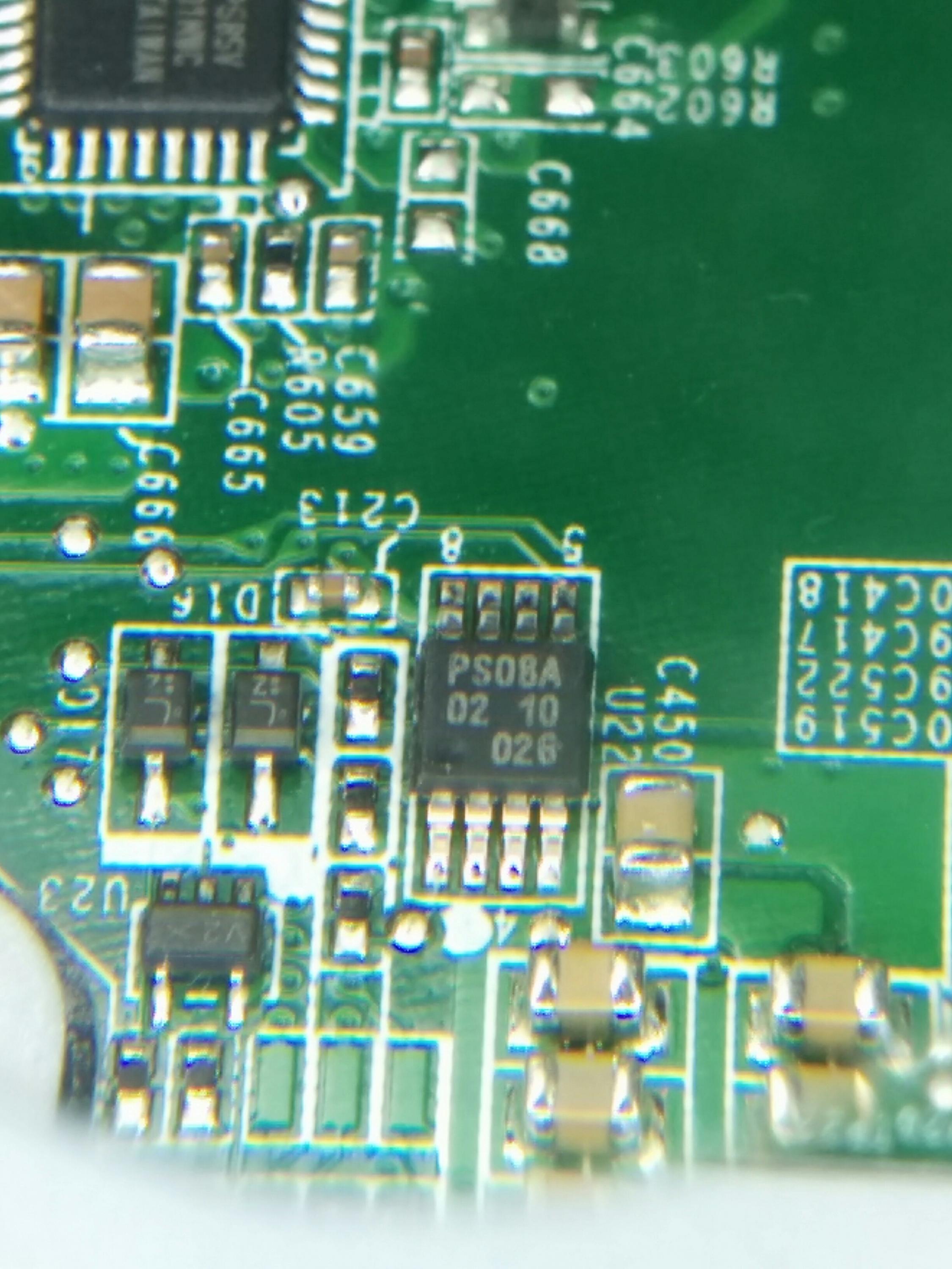

    The client wanted to dust off this old laptop of his, wanted new OS installed but has a master password on the bios which he totally forgot. I'd like to either rewrite the bios in the hopes of removing the pass so I can install new OS. Or maybe someone knows how to generate a master pass?
    Lenovo Think Pad, Tye 0301-GVG, have the S/N too if needed.
    Product ID: 0301GVG
    MB model: DAGC6AMB8F0 REV: F
    TY!

      Lenovo thinkpad laptop bios password store in eeprom chip.find p24s08 and lo8.IF FIND REPLY ME I SEND VIDEO MAYBE HELP FULL.

        Only managed to find the following chip. Nothing about lo8.

          yes i think he is.SCL AND SDA 5,6 PIN.HERE IS LINKS ITS WORKING TRY AND REPLY.
          https://www.youtube.com/watch?v=FW-RLkzjAS8

            Yes, after a few tries I managed to get it right. Thanks for the help.
