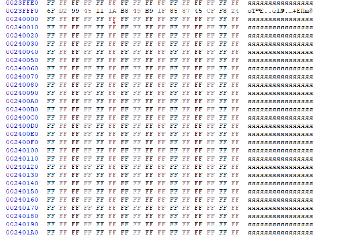

    After connect dc all voltages are present for 3sec, sometime 1 sec, sometimes nothing. I dont know if is bios problem but iam posting original bios.
    motherboard is x540sa rev:2.1
    • Mazorca
      • Jan 2017
      • 463
      Re: Asus x540s bios
      Your DMI region can't be found, nor the windows keys, are you sure this is your original? The BIOS Region from UEFITool extracted from your BIN file and Asus Update are identical. Anyway, try this file.
      • baddjavo
        • Jun 2018
        • 88
        • Serbia
        Re: Asus x540s bios
        Laptop came to me for repair, dunno if someone else changed bios. I took bios using ch341a black directly from chip. Tried your new bin and same results. After dc plug-in one led lit, then other one, two times, after that nothing happens.
