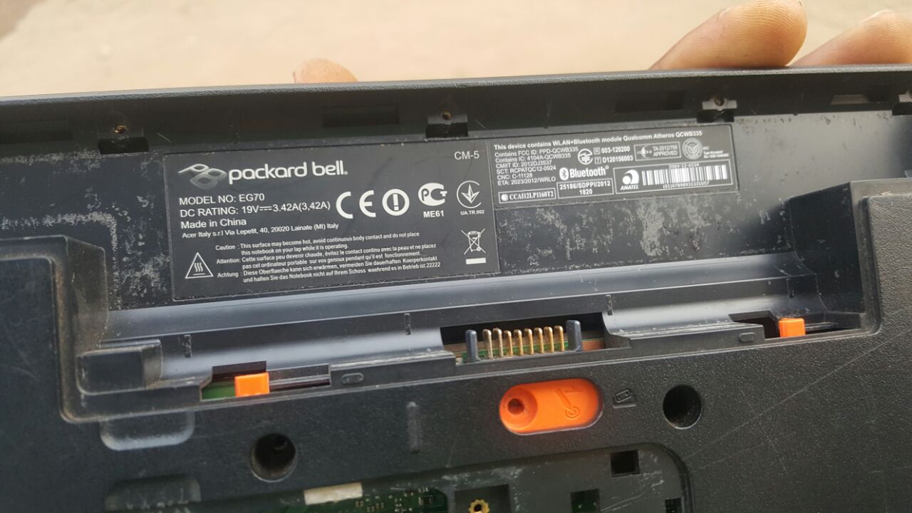

      Packard Bell EG70
      EN LE11BZ
      2 bios

        Re: Packard Bell EG70 bios dunp needed
        thanks bro Ala borbe your bios is different.
        HannStart J
        MV-4 E89382
        94V-0
        this is the old backup of my mother board

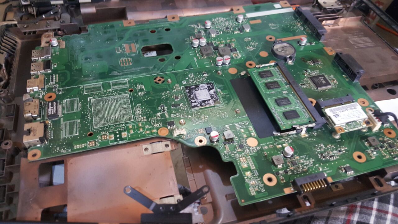

              thanks bro ala-borbe is on but all of the Usb port is not working....please have you some solution of this blem? thanks
                chipset reflow?

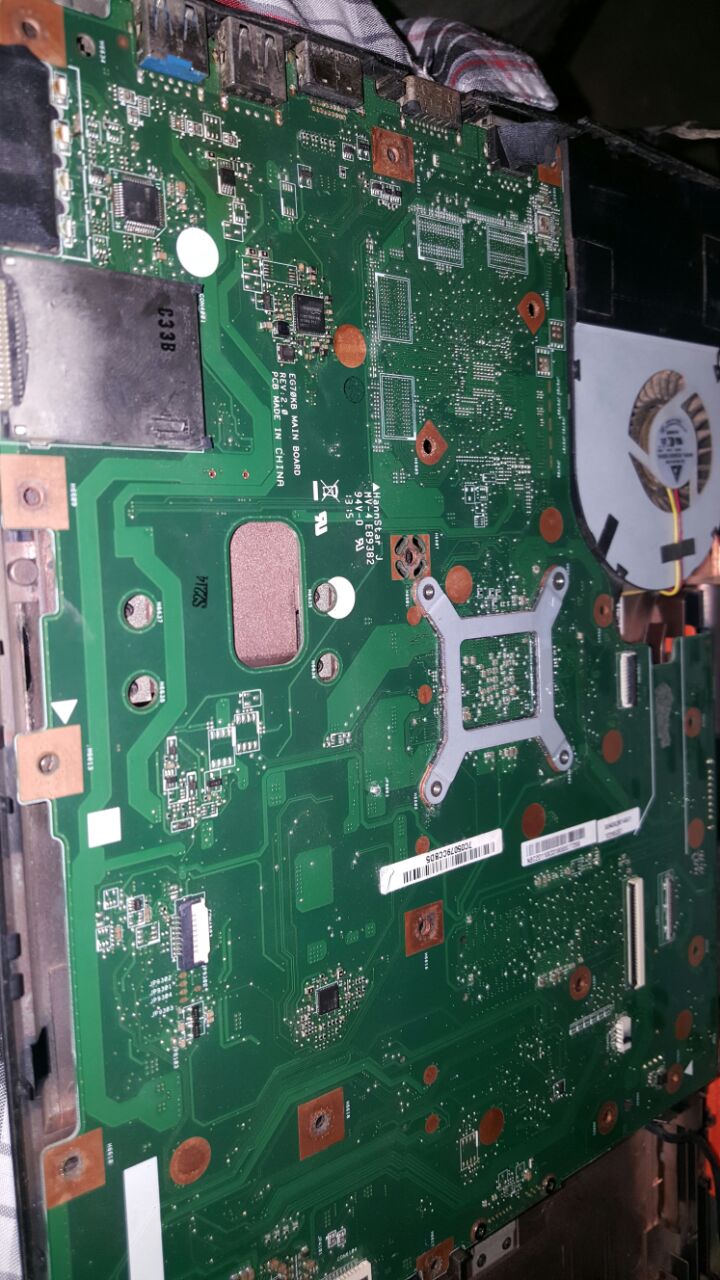

                    Please bro this is the image of motherboard...
                      For the usb check the 5V on usb port.
                      If this tension is not present check the usb power chip, if is present probably a chipset issue. If you have the schematic post it
