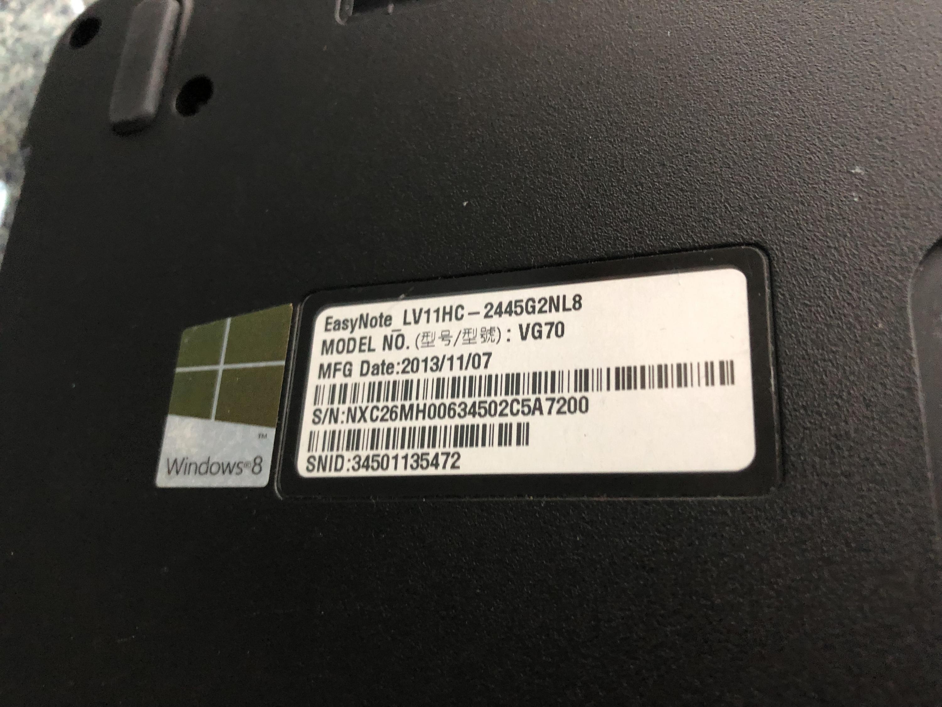

    Post the full laptop model number,serial number

      • Verlengsnoer
        • Sep 2016
        • 110
        • Netherlands
        Re: Packard bell lv11hc bios repair
        added photo as attachment

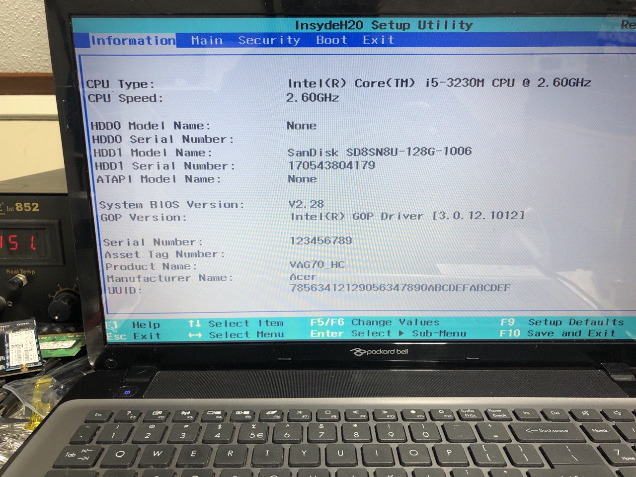

            • Verlengsnoer
              • Sep 2016
              • 110
              • Netherlands
              Originally posted by hoaca388
              Try
              thanks, but still got acer logo on packerd bell laptop, well.. the housing is packard bell, the mainboards are just te same, only thing is the keyboard layout arent the same.
              tested both, but both got acer logo.
              greetings

                • Verlengsnoer
                  • Sep 2016
                  • 110
                  • Netherlands
                  Strange, the Packard bell 2.28 file I downloaded from the Packard bell support site.
                  hmm thats interessting then, will flash again, but think its still gonna show a acer logo
                  edit: yup it still shows a acer logo
                  • Verlengsnoer
                    • Sep 2016
                    • 110
                    • Netherlands
                    after reflash still acer, when i go to the bios it says manufacturer Acer,
                    and its your file
                    • hoaca388
                      Badcaps
                      • Jan 2022
                      • 12333
                      and its your file
                      That shows the credibility of this manufacturer. They take the original bios of another company for their products. I don't know if Acer and Packard bell are related.
                      • Verlengsnoer
                        • Sep 2016
                        • 110
                        • Netherlands
                        yes packard bell and acer are 1 company, only diffent housings and different keyboard layouts, the acer bioses works on pb, and pb bioses works on acer
                        • piernov
                          • Jan 2016
                          • 4439
                          • France
                          Clean BIOS will usually default to Acer branding. Branding can be edited with AcerDMI.
