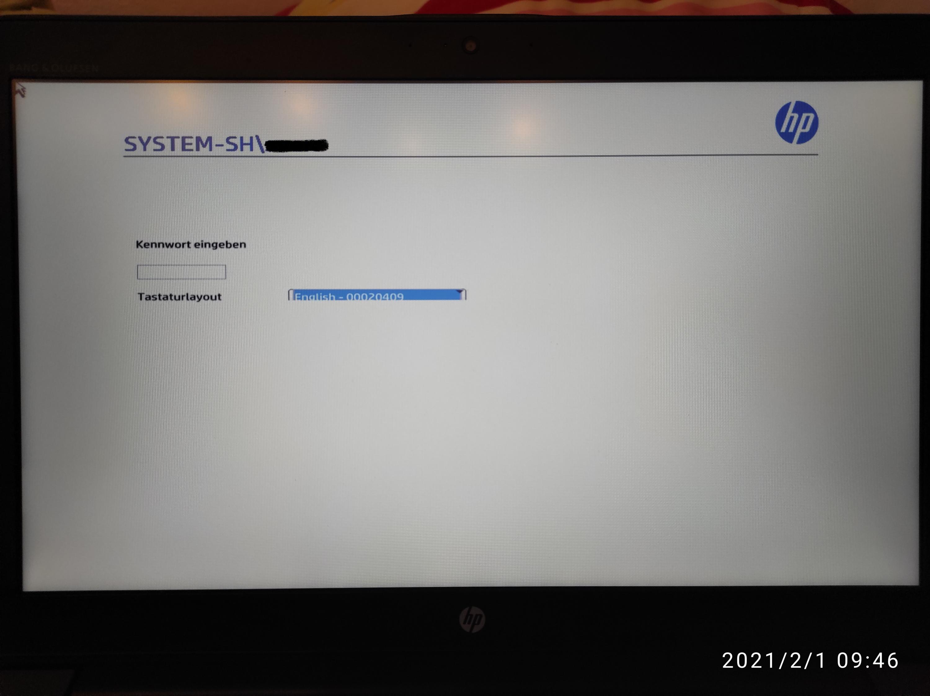

                              My HP Zbook 15 G3 asks for a user and password right after starting the notebook (see attachment).
                              I got into this state through a security software from HP (HP Client Security Manager).
                              - Would it also work theoretically that I restore an already reopened BIOS where the password has already been removed again or is there a problem and it must be my own BIOS?
                              I feel the same as many before in the forum. Despite proof of purchase and HP software being to blame for the problem, HP only offers to replace the motherboard for just under 400 euros.
                              The possibility to generate a SCT.BIN file (HP does not make since mid 2019) is simply not offered (with it you could reset the internal BIOS passwords. datie is searched with a certain key combination from a USB stick).

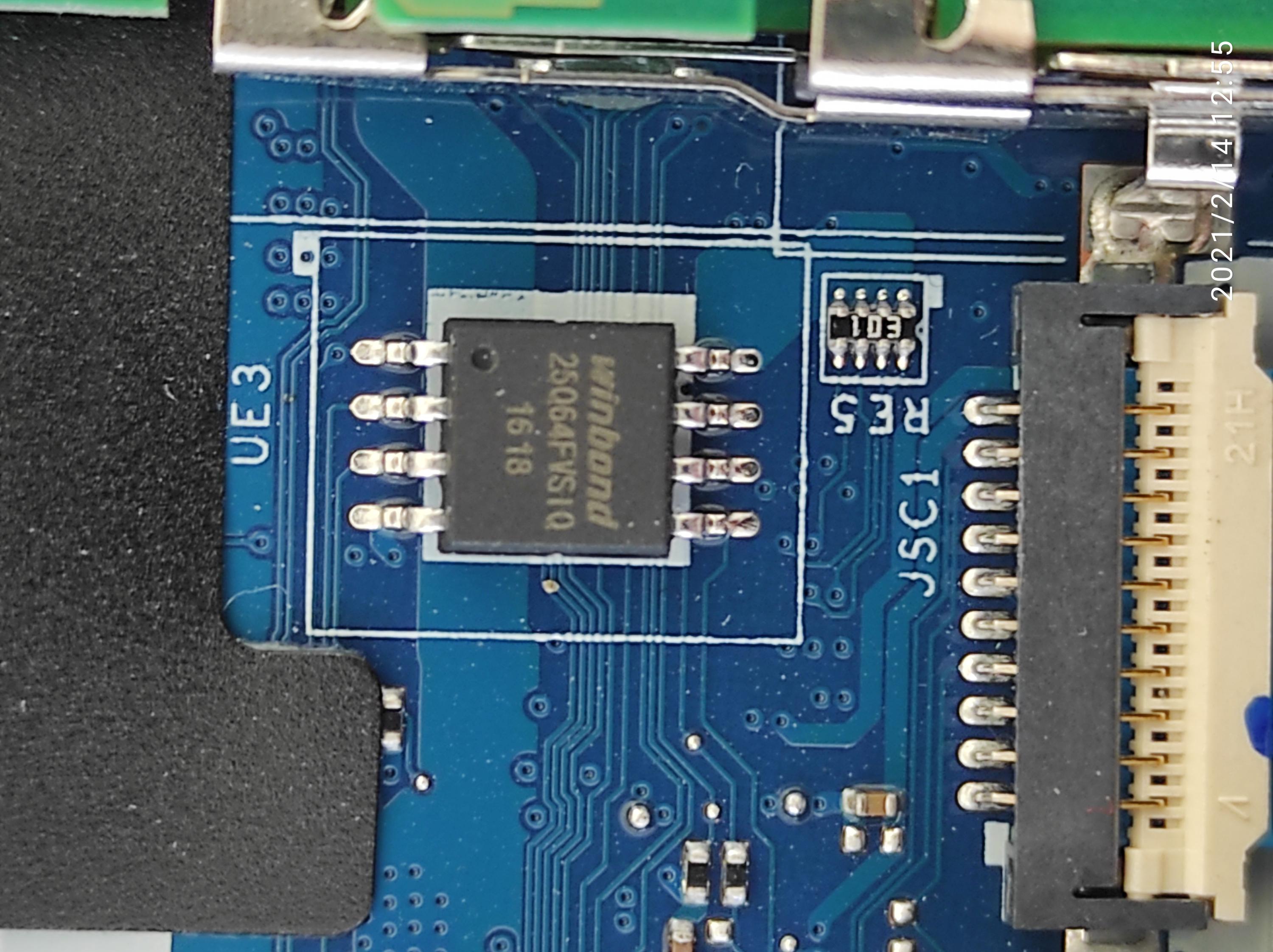

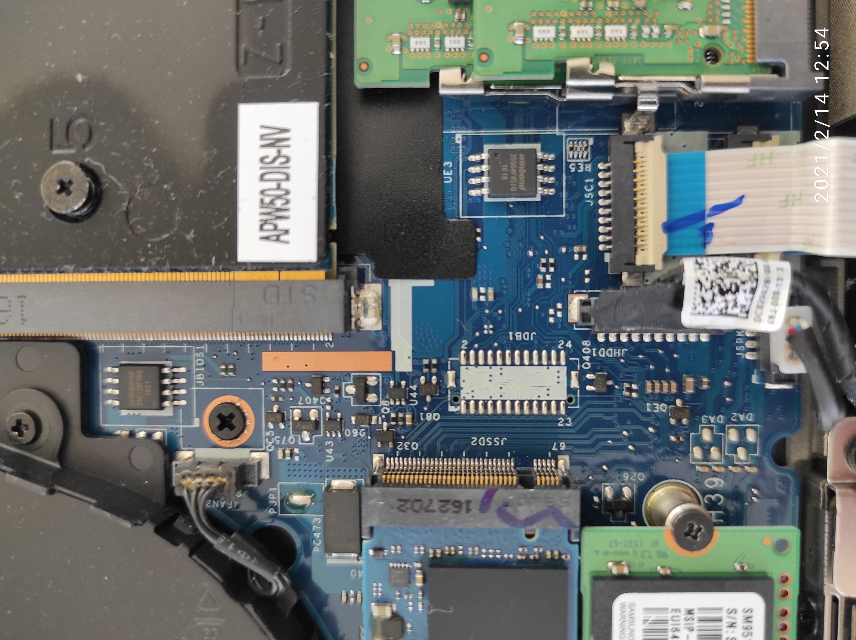

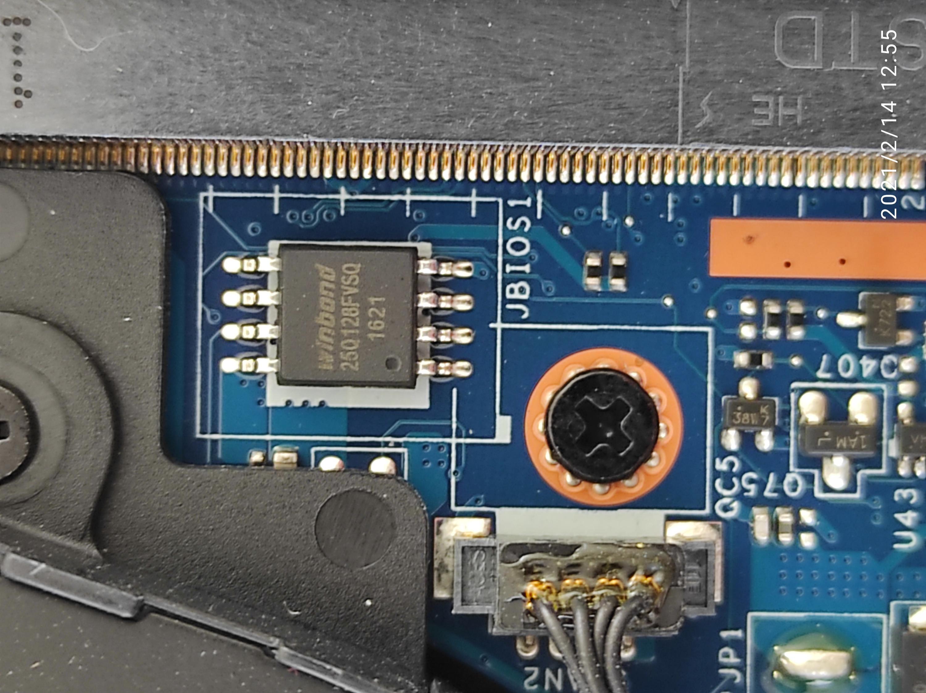

                                      EEpromer arrived yesterday (thanks to Amazon) (Type: CH341A - Link:https://www.amazon.de/gp/product/B07...?ie=UTF8&psc=1).
                                      I am still looking for the appropriate software for the EEpromer and am trying to classify the 5V - 3.3V and am considering whether I should modify the Epromer (with two small changes it only has 3.3 V on all connections). I have also read many times that it worked like this (reading and writing the BIOS) without changing the epromer and the voltage. If anyone who has already done it has a tip for me, please let me know.
                                      I found two Winbond chips on the mainboard (see pictures). The question is which one is the right one? My guess is the chip with the name "BIOS" underneath, but the question is what the other chip is for.
                                      Should I disconnect the internal battery and the CMOS battery when reading and writing or does it matter?
                                      Thanks for your help and support in advance.
                                      Kind Regards
                                      Ronald

                                        #39
                                        Re: Request ZBook 15-G3 Bios Dump
                                        Kind Regards
                                        Ronald
                                        remove the internal battery for any operation in the laptop, so as not to accidentally make any short, you can also remove the bios battery ... post only the contents of the 25Q128FV chip ...
