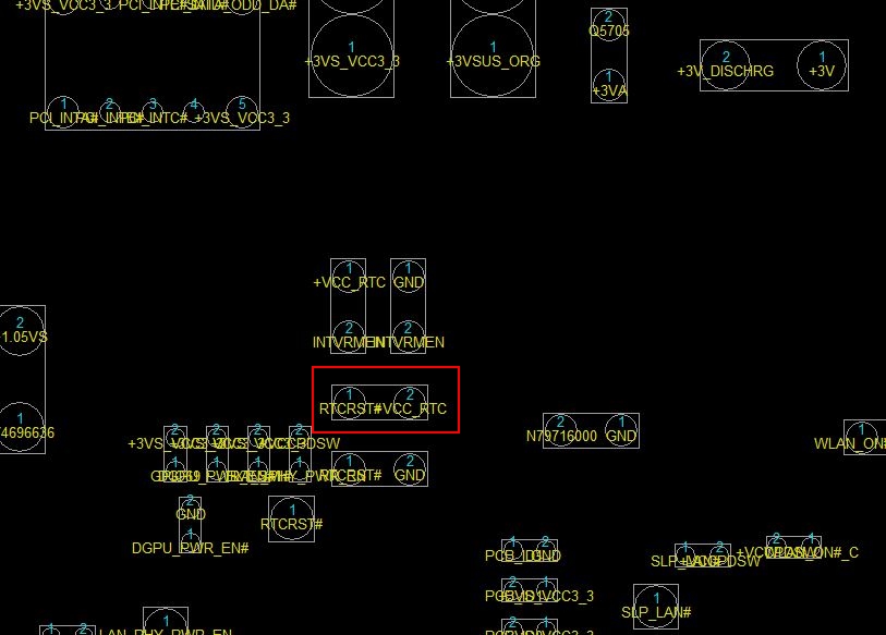

    Every time I turn on the laptop, appears the bios screen, after a bios replacement for one time , pushing the esc key, I see the properly boot devices
    but after, every time I start up the system appears the bios screen and with esc key appears only "setup" .
    It's possible an issue with ite IT8585E ?
    Someone has a knowledge about this problem ?
  • jasko_jacker
    • Oct 2014
    • 1140
    • italy
    Re: Asus n550j bios issue ?
    Finally solve this issue, in this case I find a bad resistor .
