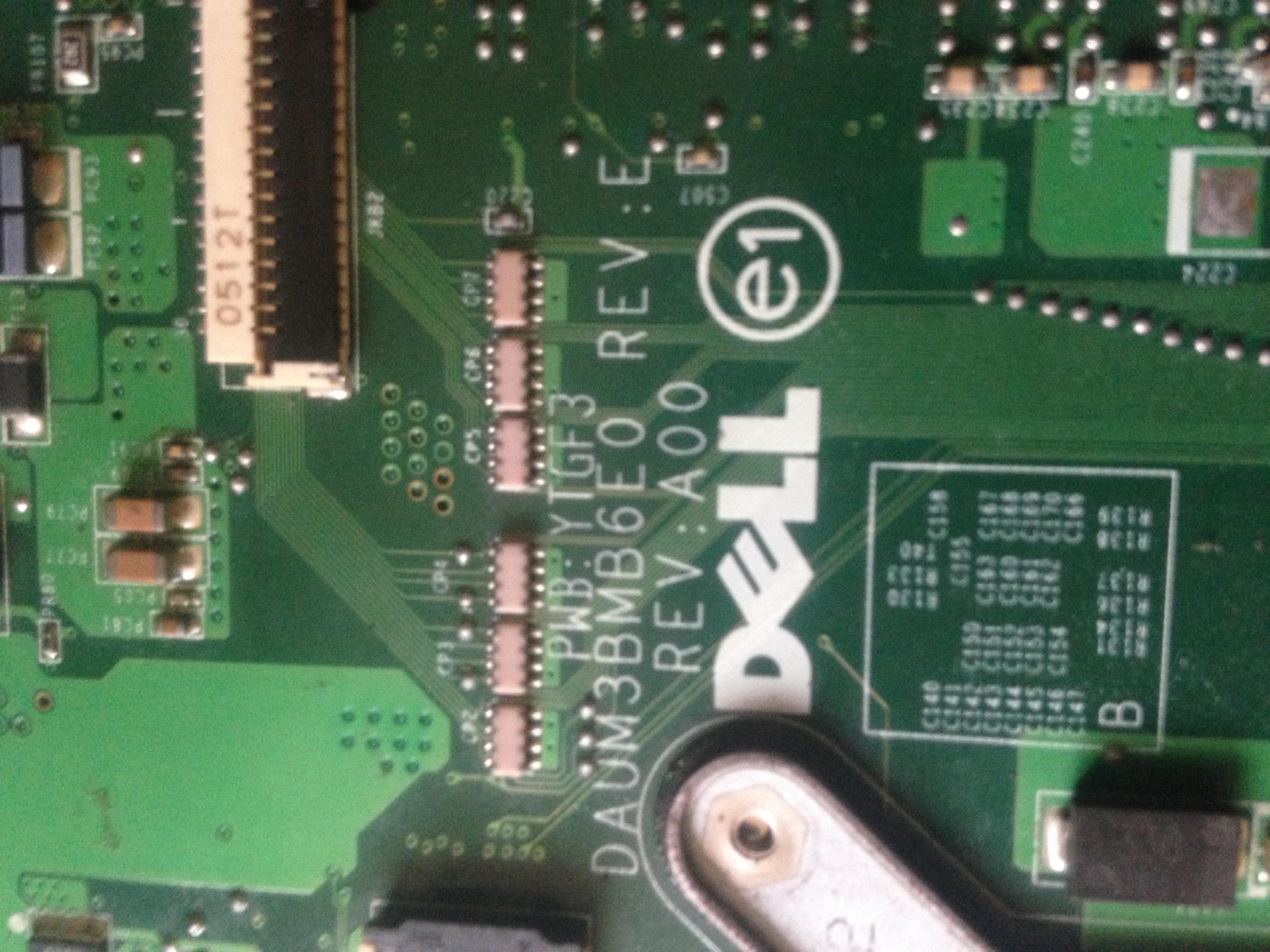

    Hi everyone I need a working bios dump file for this model please
    Motherboard id: DAUM3BMB6E0 REV E/REV:A00
    Please attached image of board
    2bios chip thos model
    W25Q32BV
    W25X80AV
    Thanks in advance

    Re: Dell inspiron 1564 bios needed
    Anyone please help i need working bios for this model please

                      I flashed the bios still the same not working 3v and 5v and 19v is present and also there is voltage on the bios chip.The problem is when i plugged in the charger without batter led light comes on and then goes off but when i plugged in the battery and plugged in the charger lights comes up and goes off and comes off steady but when i pressed the power button lights blinking but the fan is not spinning.when i measured the power button shows 5v. any idea please help me
                        so this does not seem an only bios issue.
                        there may be a short or missing signal too.

                          I still not resolve this issue here it is I measured on maxim 8731ae voltages PINS: black probe to the ground
                            It shows that MAX8731A is not working.
                            Does the laptop turn on without battery?
                            If not, you have to measure voltages on ITE8502E pins.

                              thanks for the response laptop not turn on with battery but the led light steady but cannot turn on
                                I recommend measuring important ITE8502E pins while the battery and other removable parts are removed.
