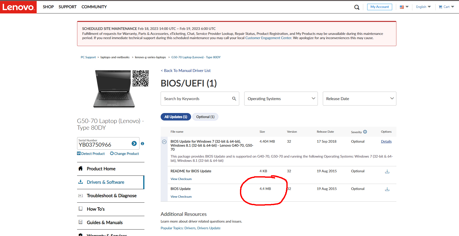

    Lenovo g50-70 need the bios pass cleared
    Hello Guys need the bios pass cleared please
    Lenovo g50-70 (ACLU2 10G2 1i_2014-06-12)
    I attach dump with FPT ver.10.0.30.1072 I see that there is an error 280: Failed to disable write protection for the BIOS space!

      Re: Lenovo g50-70 need the bios pass cleared
      https://www.mediafire.com/file/l4zjg...sults.rar/file
      make a copy of the original bios without errors and post the content of the bios here on the website...
        this is the copy made with Universal BIOS Backup
            the original bios has 8mb, not 4mb... use an SPI programmer to extract the bios content...
                https://www.youtube.com/watch?v=DWWigscuQDY
                I thought it could be done without unsoldering because I'm not capable, the bios that I flashed downloaded from the lenovo site is 4 Mb
                  the original bios of the laptop..., not the update from the website, don't you need us to delete the bios password of your laptop?? we can find the update too..
                    excuse my ignorance, I don't have equipment to solder/unsolder from the motherboard, I can do it in another way..I'm telling you this because in another forum they asked me for money to do it with software like H2OUVE or Flash Programming Tool. Version: 10.0.30.1054 ,but I think the spirit of the forum is to help each other without asking for money
                      I can't help you without bios...but maybe someone else can...

                        LENOVO G50-70 Bios Password
                        i hope i'll be ok and not against rules with my request.
                        So i have a Lenovo G50-70 , S/N : YB08544882, MB model : ACLU1/ACLU2 Rev 1.0 with Bios Password locked.
                        I try with autopatcher and the result is : "Dump.bin is corrupted or does not contain a valid dump".
                        I think my model isn't compatible and some skills missing me to remove the password by myself.
                        Can someone help me to do that please?

                          Re: LENOVO G50-70 Bios Password
                          Thank you very much.
                          use this bios (thanks to @peste) and write DMI with Lenovo Maintenance Utility - I don't know where DMI area is to transfer it.
                            Thank you very much. I'll try to find how and where is the DMI area. If someone else can help, that will be fantastic !
                              Search for LENV . 6A0000 - 6A1FFF (Length 2000)
