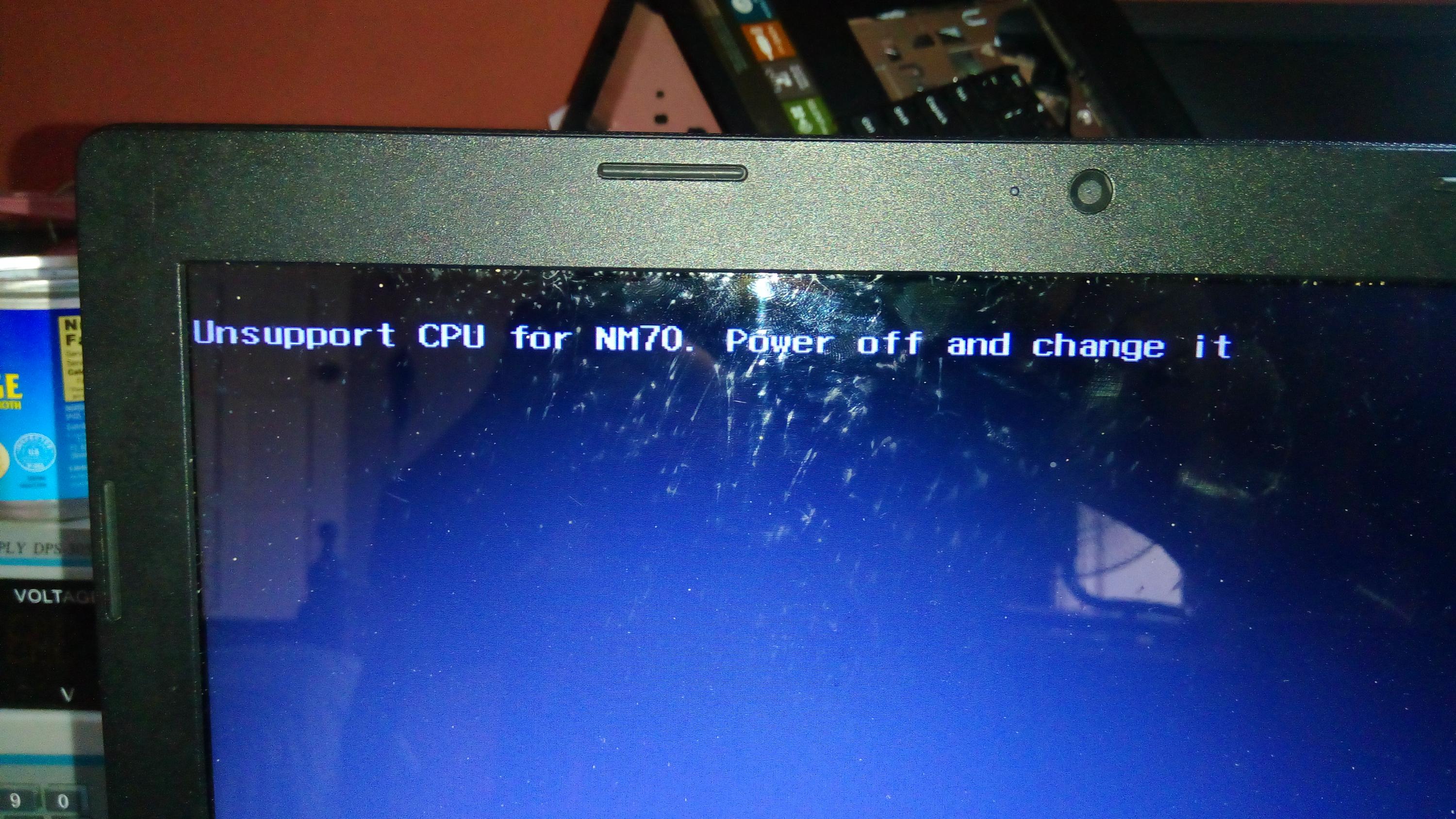

    The unit has power with no display
    i have downloaded bios dump from here for lenovo g500 got display but current processor is not supported.

        What do you mean with "current processor is not supported"?
          Re: Need Help with Lenovo G400 BIOS
          it has an error that says the current processor on is not matched on the uploaded bios dump.
          i took lenovo G500 when i looked at the specs gave me i3
          but this laptop has entry level processor
          will attach the picture in a moment

                Here is what I meant earlier about the error after uploading g500 BIOS dump

                  gcomputers,
                  your dump did not worked.
                  alaborbe knows how to edit ME region...
                  i bet he can do something with mine.
                  if theres someone who has a working bios dump,
                  please upload.
                  thanks in advance

                    G500 had and an entry level configuration that comes with the Intel® Celeron® Processor 1005M.

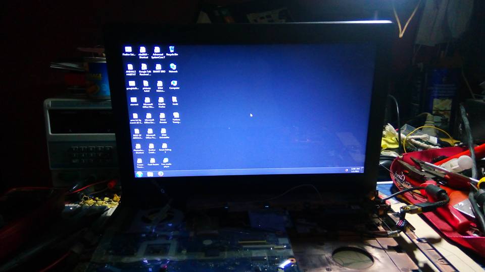

                      thanks atsio...
                      a friend gave me a copy of LA-9631P and worked...
                      here it is
                      thanks to all who responded in this thread
