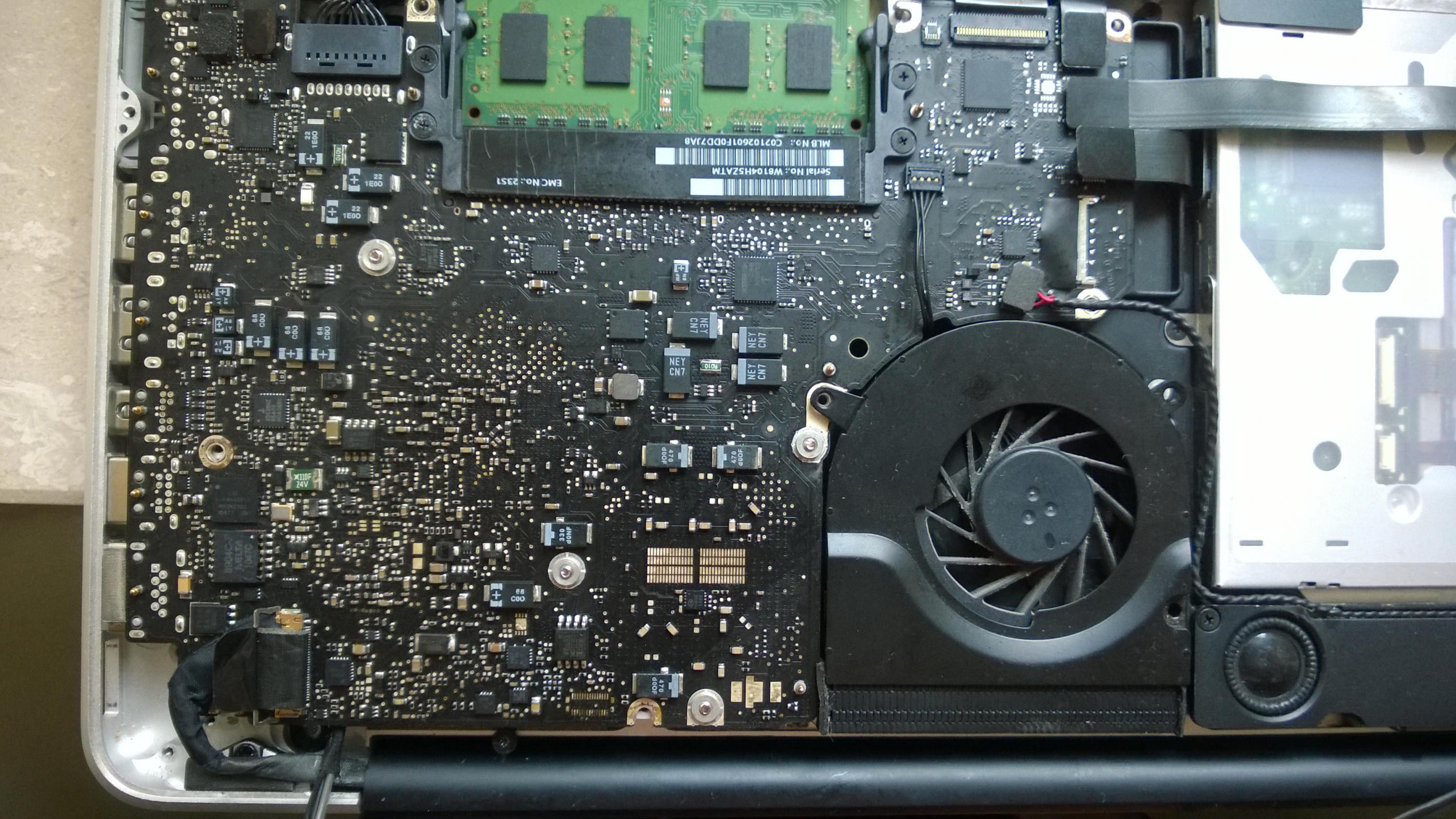

    hi, i need this bios dump for a macbook pro 13 inch that doesnt power on at all. tryed another bios and fan spin but no display and since there was not reported the mainboard code but only model, i need specifically a bios dump for 820-2879 with that mainboard layout.

          Re: macbook pro 13 inch a1278 820-2879 Bios dump
          update about that macbook:
          with bios on it pc power on then off almost immediately. if i remove bios chip, pc stay on with no post, but at least is running. if i put back bios in it it is doing the same all the time...
                dell if with bios attached still not turning on , there is no good communication between smc and bios . do you have osciloscope ?
                  i dont :S and smc is totally reballed....
                      i know.... when pc is powered off and bios chip is removed i have volt 3.3 on pins 1-3-8
                      if i power it on also without bios chip i have voltage on pins 1-3-7-8.
                        3 7 and8 are 3.3 vcc lines so that ok , pin 1 2 5 6 are command pins TX RX , does are the one you need to test . but does only with osciloscope , or try something like replacing bios chip and insert new rom
                              chek pin 7 on schematic , to see if its normal to drop to 0 volts
                                when bios is present it drop, otherwise it didnt.
                                looks like it's related to gpu..... maybe gpu need new bga instead of just a reballing. for now ive removed smc and will put another one just to be sure it's not an smc problem.
                                any good source for mcp89-mz-a2 seller that sell new bga ?
                                gc didnt have any new but just second hand.
