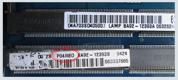

                Would anyone have the dump or bin file for a np300e5c-a09us scala3-15-17crv BA41-01979A.
                There is absolutely no other way for me to repair this bios besides a programmer. Any and all help would be appreciated and thank you in advance.

                    Hello khaahk,
                    Yes I did however these are the incorrect bios files. The bios I need will end in RAP, more specifically P02RAP.bin .... I do however appreciate the response.

                      Care to explain? What difference does it make how the file is named?

                        Re: Samsung NP300 Bios
                        same laptop different platform, different motherboard
                          ala_borbe is correct, they are not the same, I have tried them to to ensure (praying) but no dice. The good news is, I did find the bios.bin file, the bad news= the error report from the programmer claims the file is to long! I can't figure out why. I have flashed the exact chip with an 8mb bios file with no error. This bios file reads 8mb however I get the error message "file is too long"? Is there something included in the file that I'm missing that can be removed? If so, it's extremely small. HELPERS? anyone? Thanks in advance.
                            if you can post you backup file, dump from your epprom, not working one and that "too long" file i might be able to help
                            and can you tell bios version previous to the update?

                              Thanks,
                              I don't have a backup file, I'm actually comparing the bios file to a random 8mb bios file. That's actually why I needed the bios, without it the laptop is useless. The previous owner decided he knew best, he and a cohort decided to wipe the chip after a bad bios flash. Now I'm trying to get the Laptop bios loaded back in. So I tried several Samsung bios.bin files that were 8mb with no error, this one is 8mb and returns an error. I'm guessing that there is a tiny useless file somewhere that can be deleted. I can provide the file, however, I cannot provide a comparable backup file.
                                  im afraid that without eprom backup it will be hard to rebuild eeprom
                                  i got samsung bios update file, if i had dump maybe i could rebuild it
                                  what are the markings on eeprom??? how big is eeprom???
                                  if its 4mb (16mbit) maybe this file would work but i doubt it

                                    MX25L6405D if my eyesight is correct....
