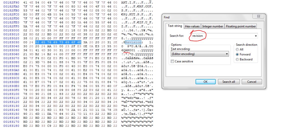

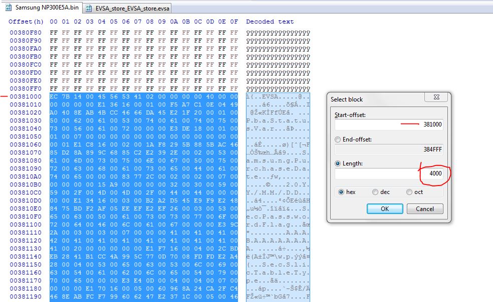

                                      Every samsung bios has a platform ID ,if you open your bios with a hex editor you can find out what yours is by looking for a few key words, SECFID,SEC,SECWUP or $Revision https://www.badcaps.net/forum/showthread.php?t=88206
                                      Use the forum search to look for an 06QA bios (or 07QA,08QA,09QA) with clean ME firmware,if you can`t find one look though all the NP300E5E threads,download each bios and open with a hex editor and search for QA.If you can`t find anything then you should try cleaning the ME region of your bios,if that doesn`t work then download and extract the QA bios update,extract it and merge it with your bios using a hex editor or version 0.27 of UEFITool.The serial number and other DMI will be missing after flashing,if you want to add the serial number (DMI) from your backup use a hex editor,the offset is 381000 (length 4000) or use UEFITool and extract the EVSA area at 381000h,and copy it into the newly merged bios region.

                                        Thank you so much for your instruction, but i face a problem after do all steps the computer working will every think ok but when i shutdown the computer the screen become black the power button still light, the computer freezing, i can't do force shutdown until i remove battery and charger after that reset BIOS by press power button 20 second then the computer return working

                                          Attached is the bios update exe ,run it and it will update the Micom firmware (EC) ,if it makes no difference then its some other hardware problem.
