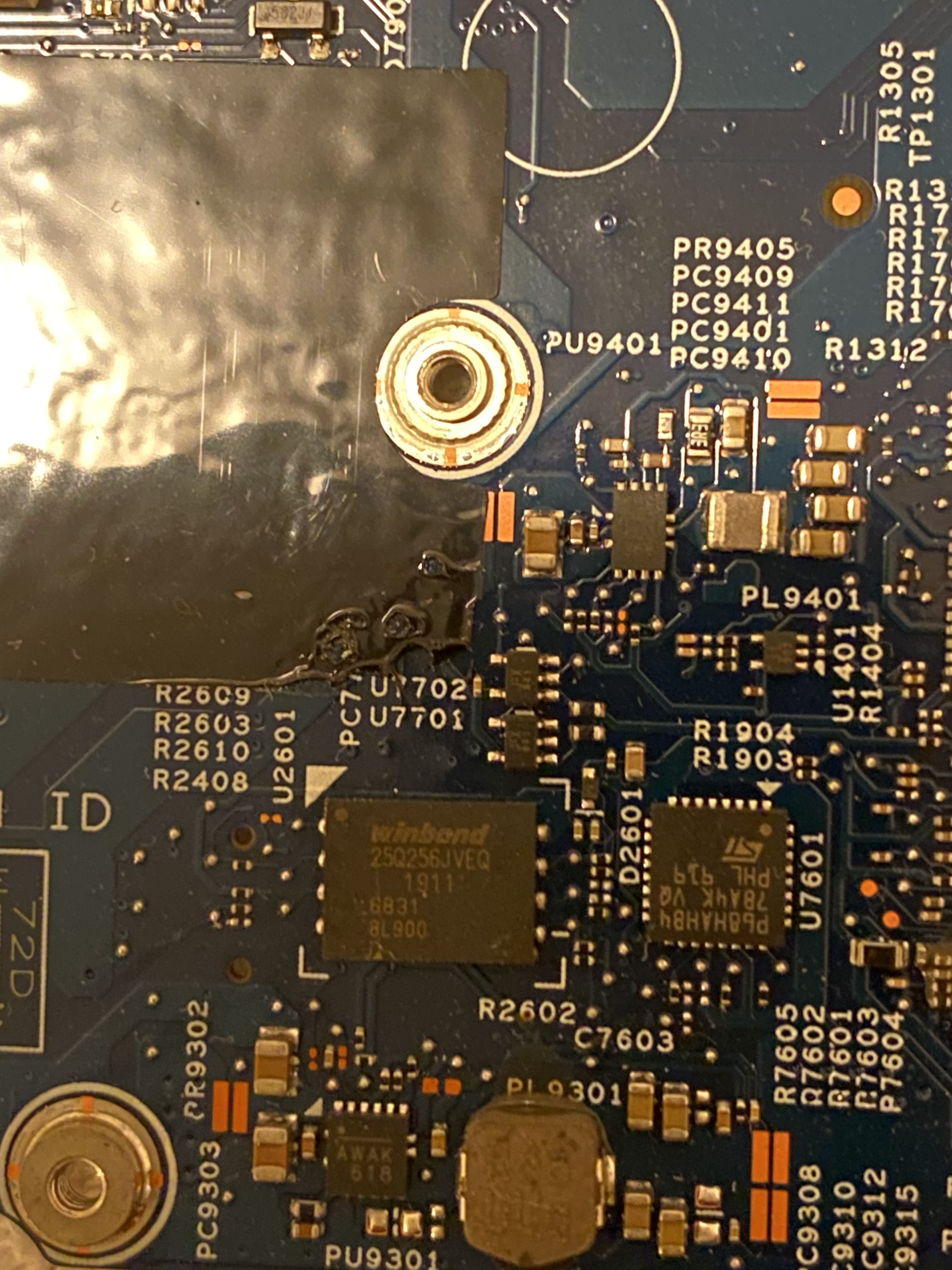

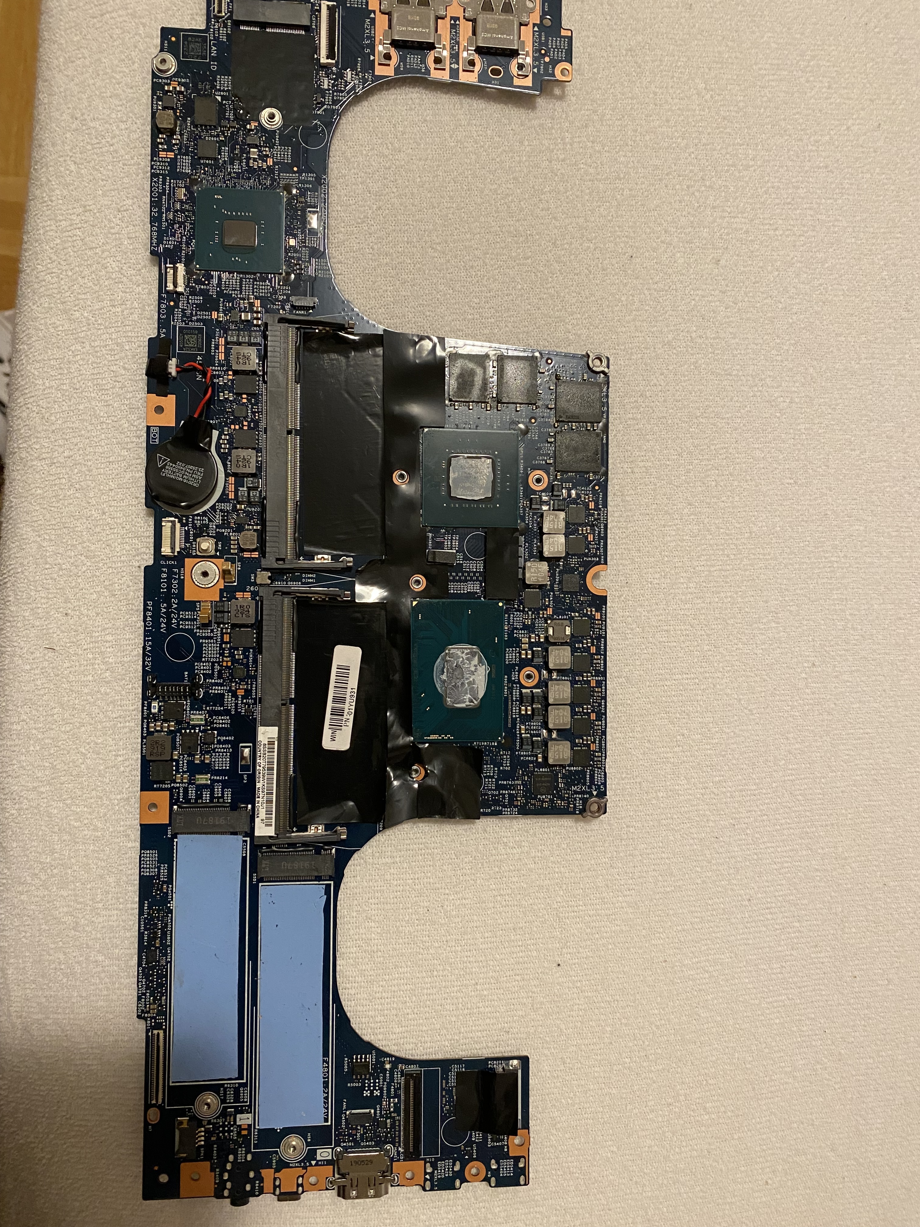

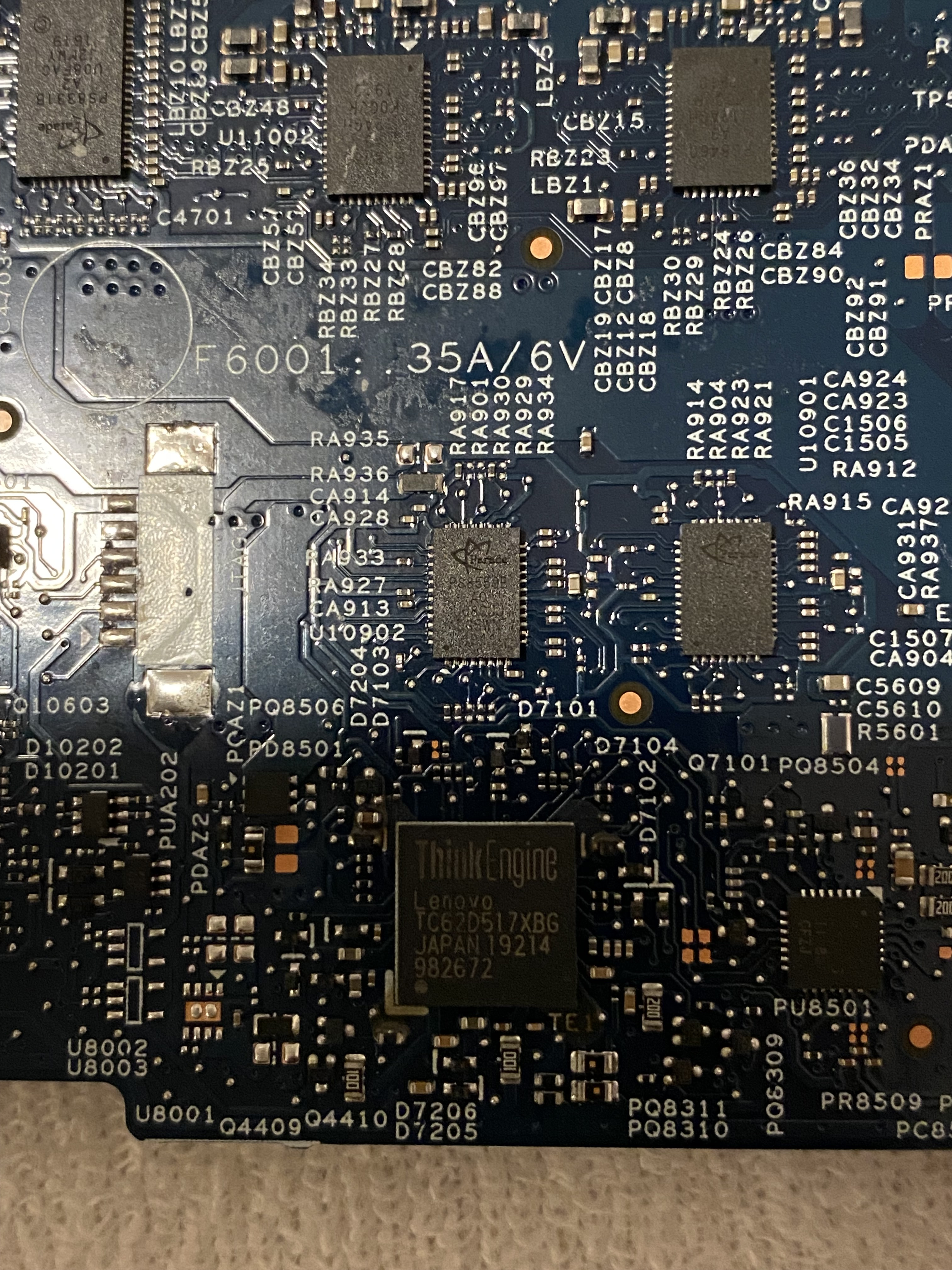

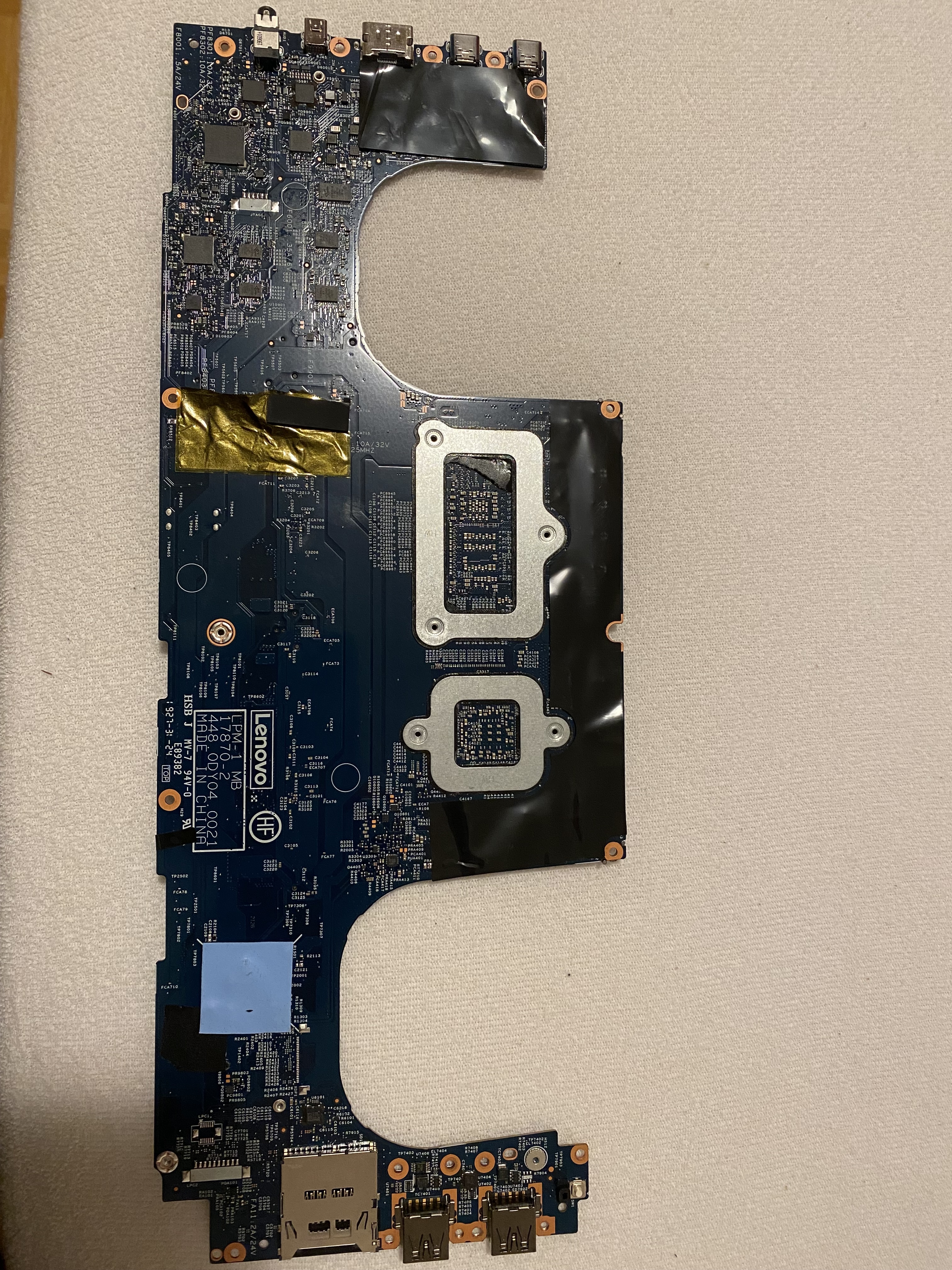

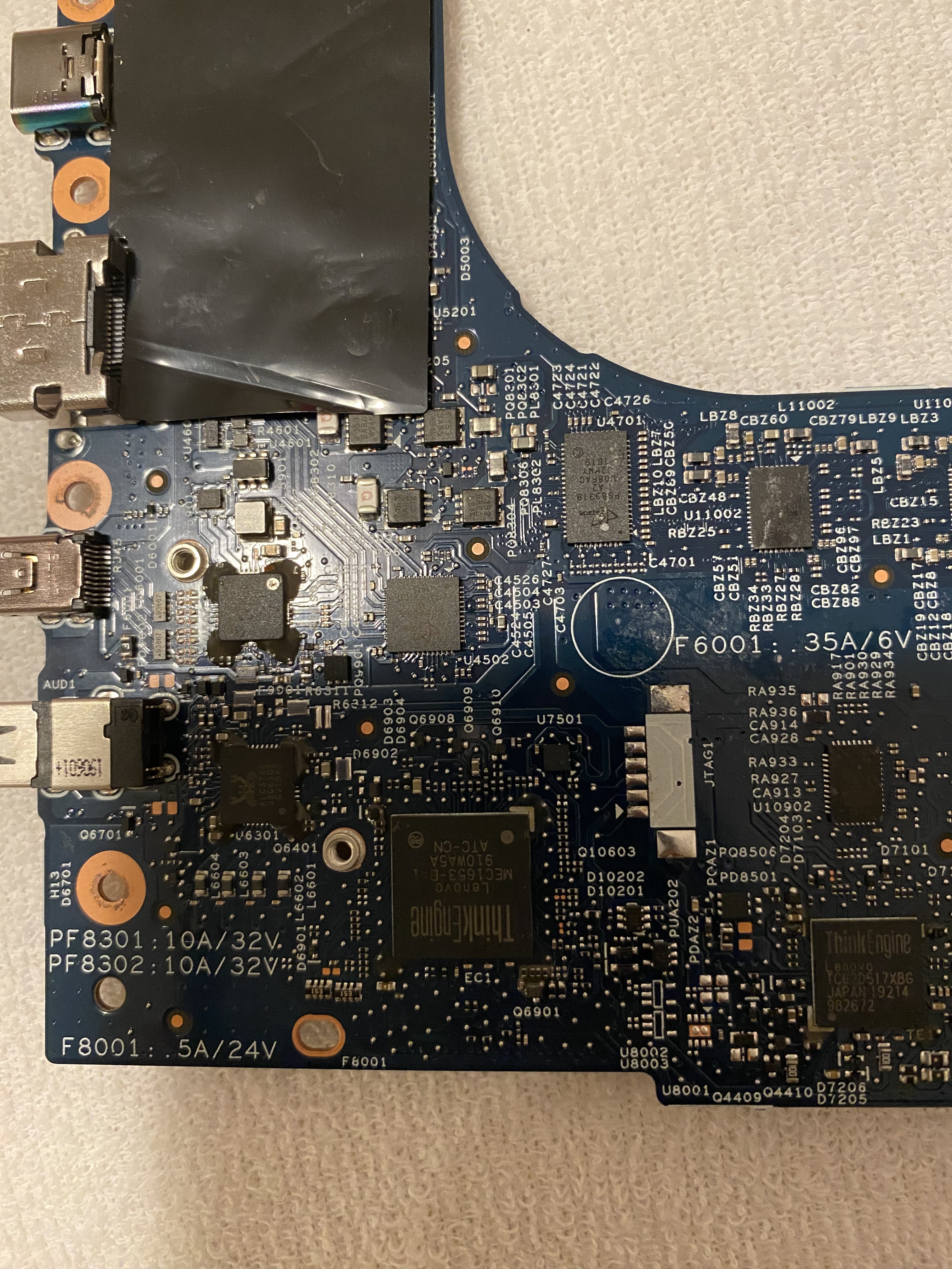

    hello everybody, here is folini from switzerland. as a biginner of this field i just want to know some infos regarding this model. basically i have learned many things from here and mainly i am interested in removing bios password of HP elitebook laptops. now i am bit stucked with this lenovo.before i upload the locked bin file here i want to know which chip do i have to connect my tool and read to remove the bios password?
    laptop model: lenovo thinkpad p1 gen 1
    compliance id: TP00099A
    TYP 20MD-S0HB00
    S/N R9-0TN62H 19/03
    MB LPM-1
    17870-2
    448.0DY04.0021
    HSB J MV-7 94V-0
    E89382
    basically i am doing everything with neo and asprogrammer with ch341a tool and pogo pins. unfortunately i attached here pics of the motherboard and please i kindly request you to help me to find the correct the chip which is included bios password. thanks everyone

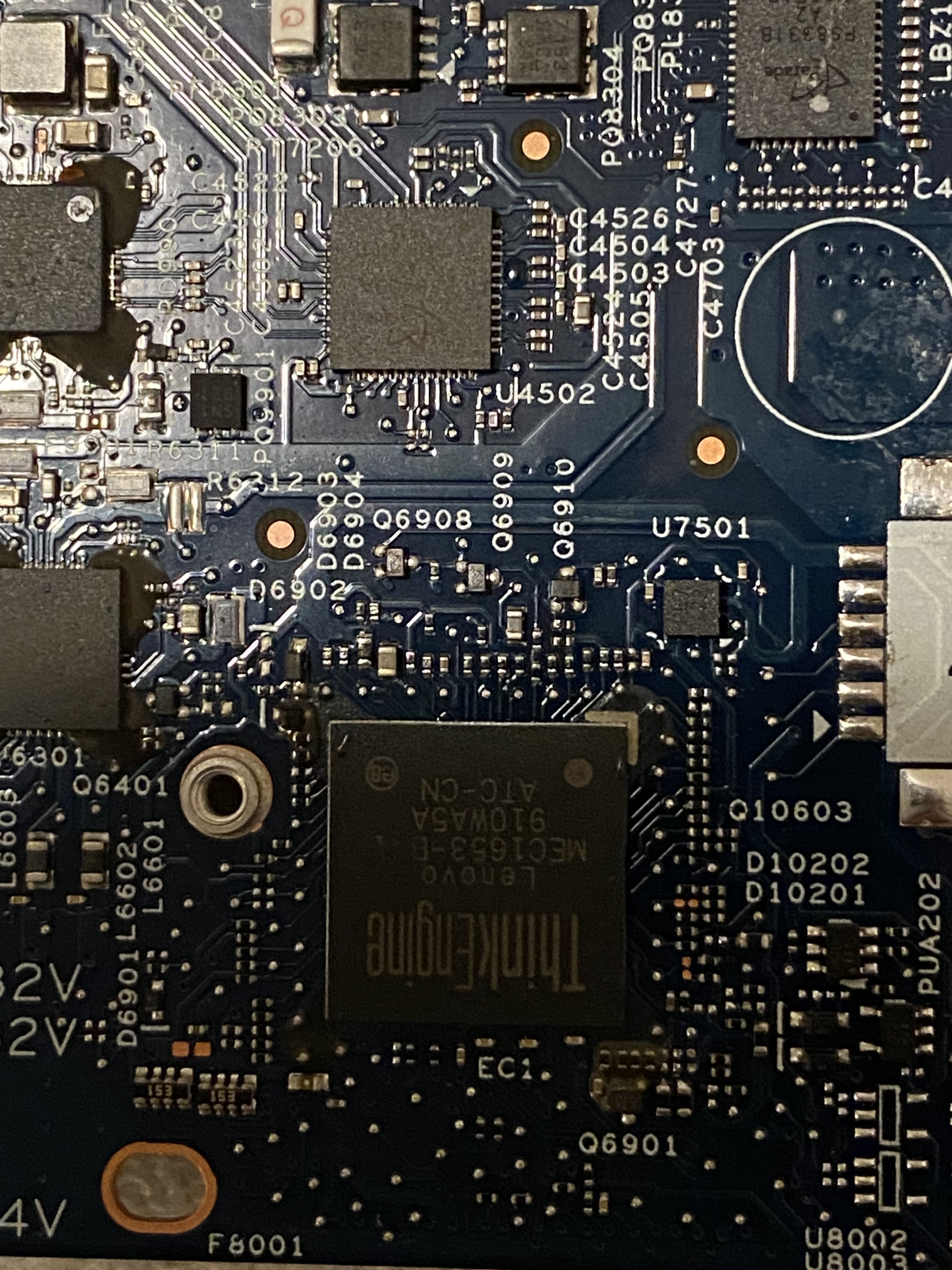

    bios pass is in MEC1653, if you don't have SVOD4 or RT908H you can't read it. You can use Maxpower3 method, described here:

      Ok thanks for your kind response. By the way how do you say directly it’s in that chip? Why could not i identify it? I thought bios password always in the winbond 128MB or 256MB chip.

        Bios patching work on 16 Mo, but 32Mo not Work.
        Password is always in EC Mec/ITE or Nuvoton etc .. on Thinkpad

          Ok thanks a lot. What is mine? 16MB or 32MB?

            Winbond 25q256 = 32Mo

                LPC Bypass should work on this. Just the BIOS patch isn't working.
                Look for the LPC1 connector on your motherboard.
                I can't find the schematic for your model.
                And follow the information in the EC BYPASS post.
                Use one of the lad (0,1,2,3) and GND.
