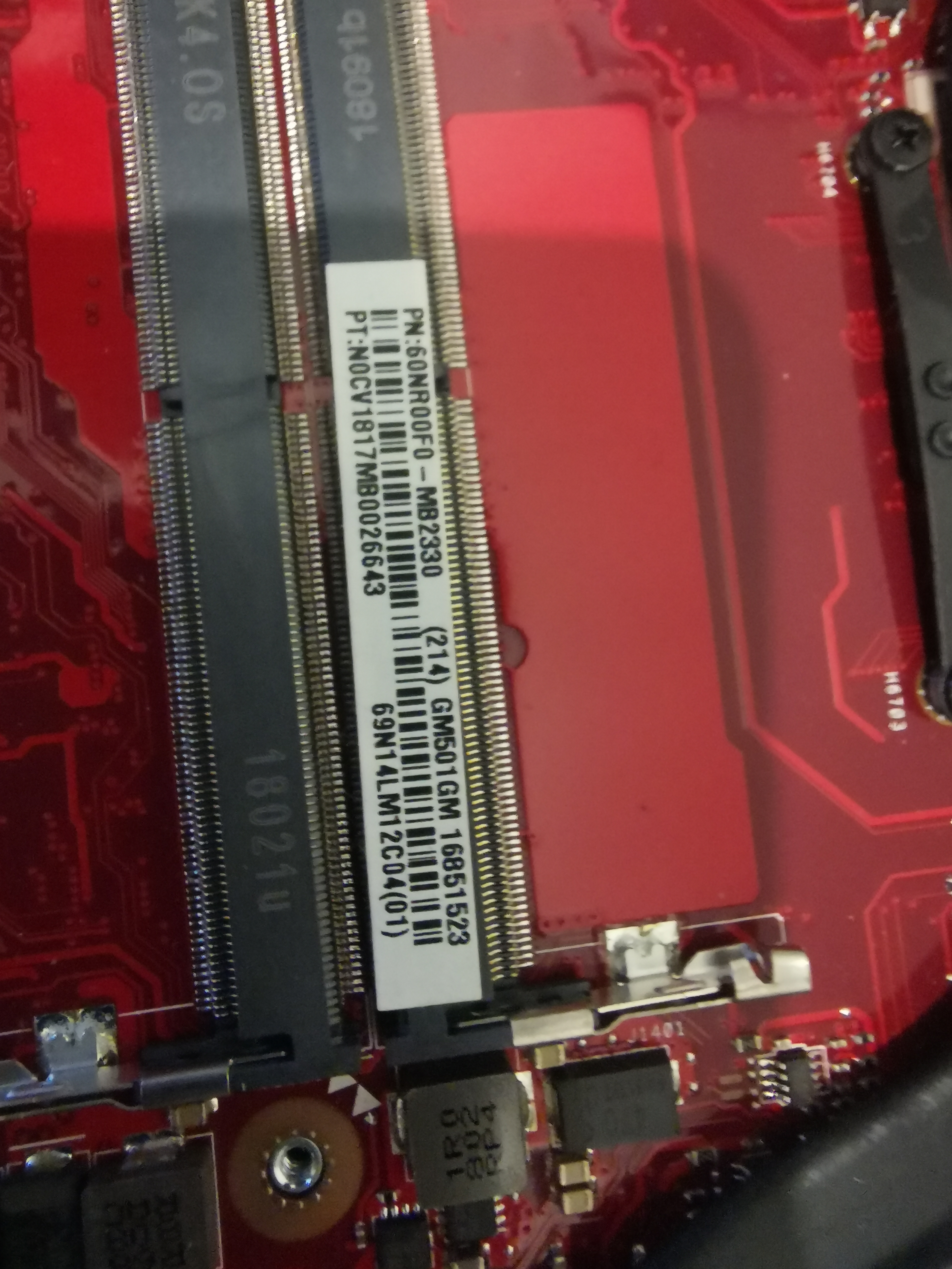

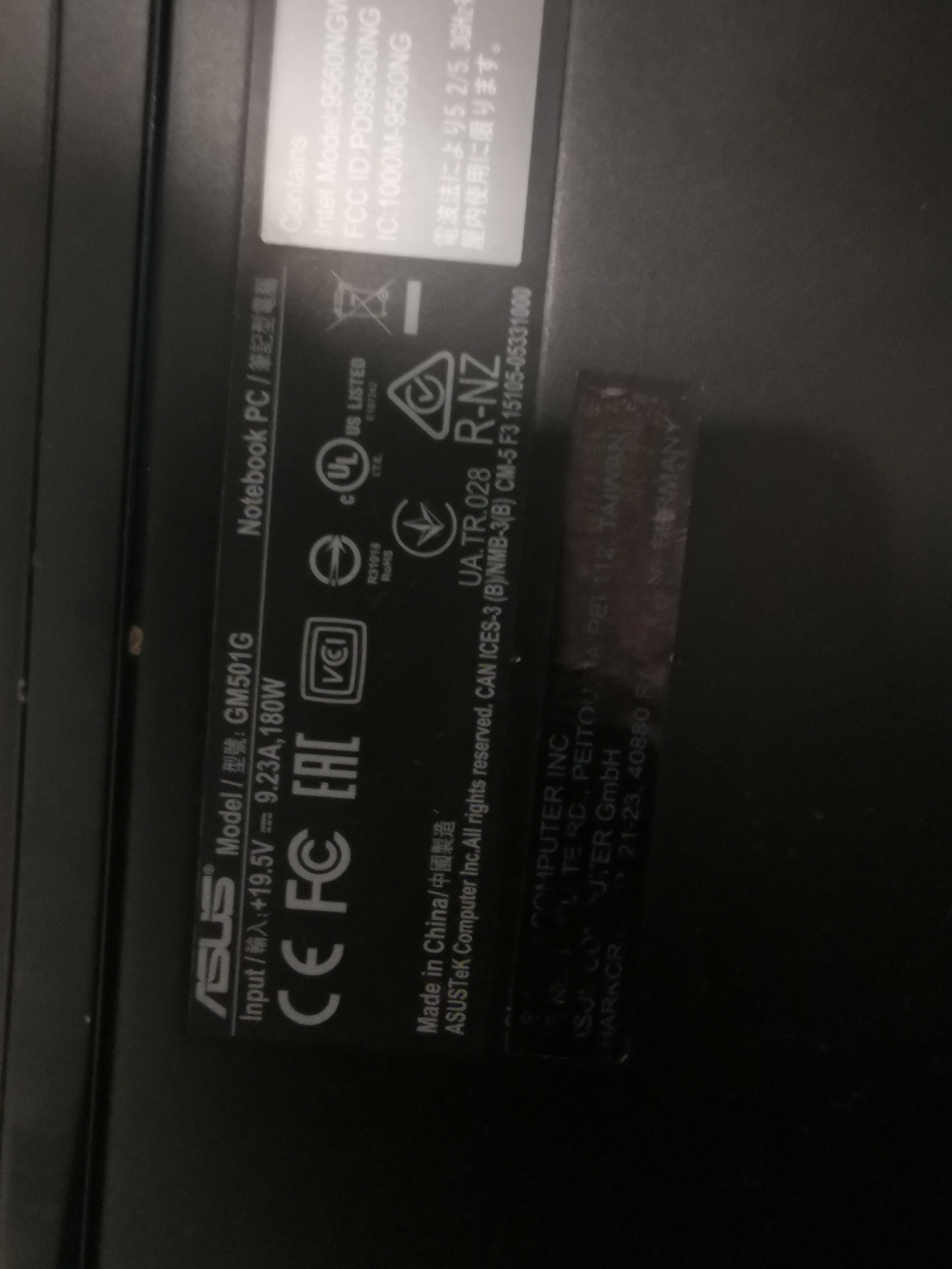

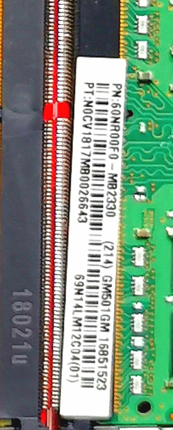

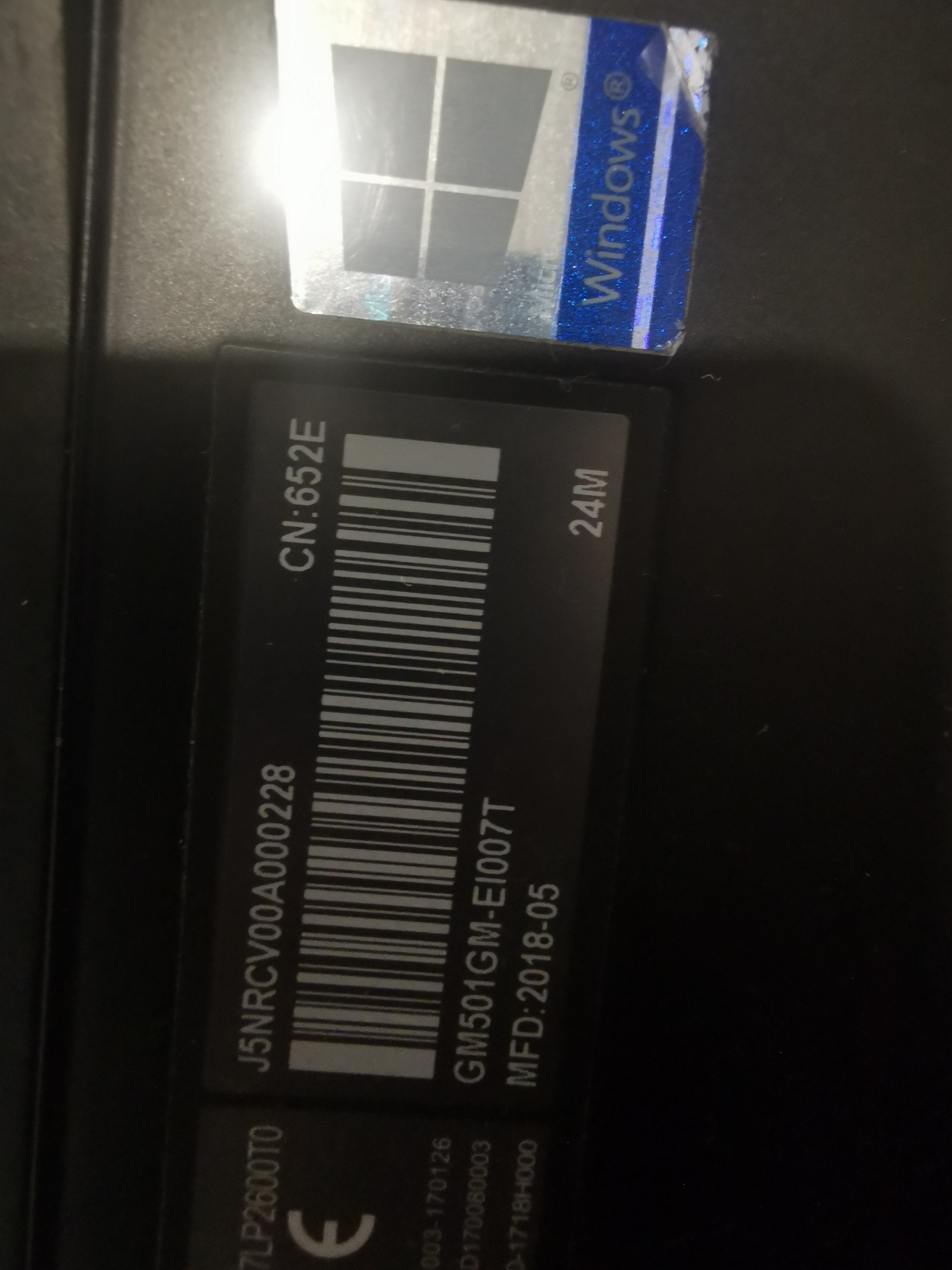

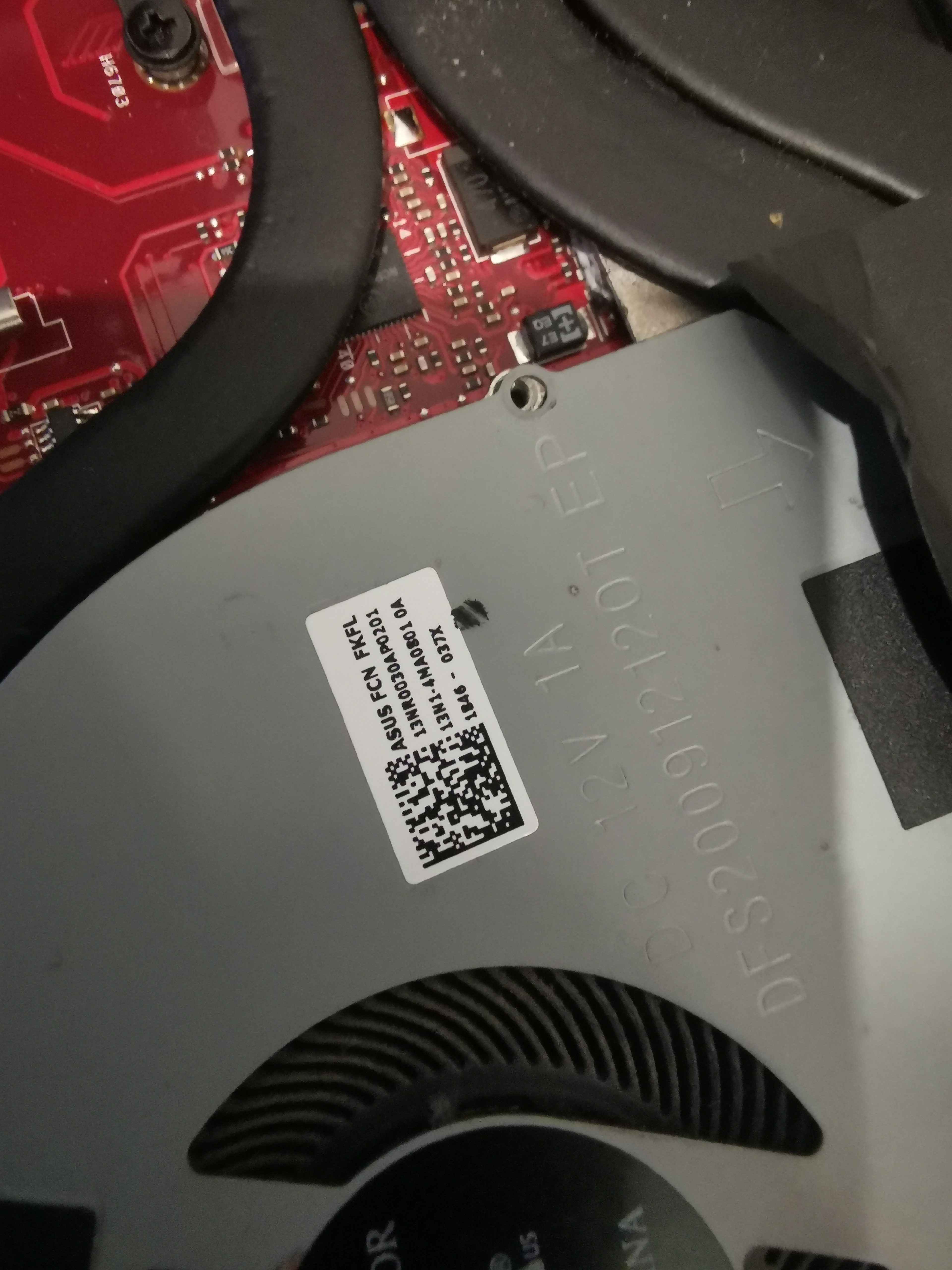

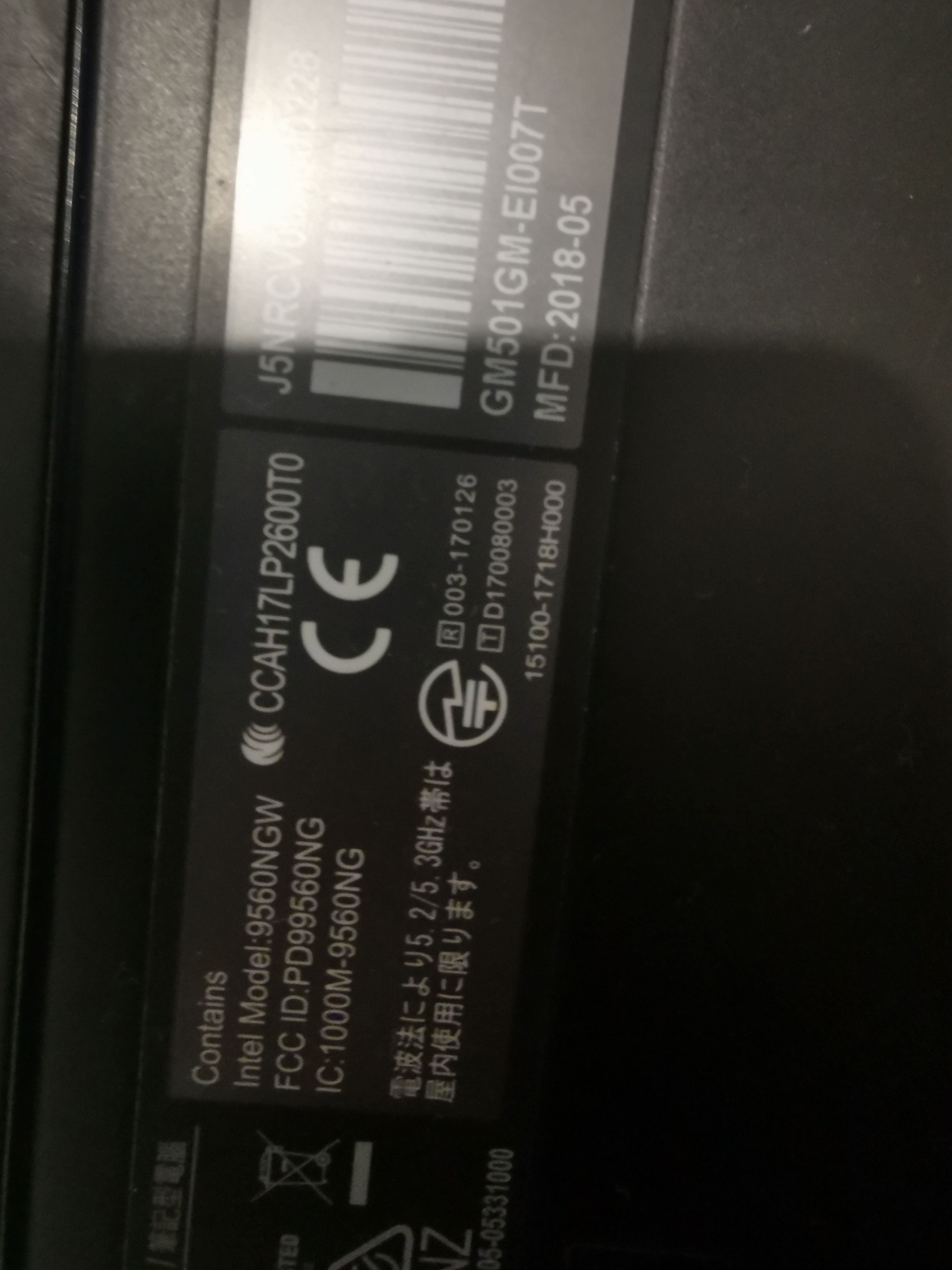

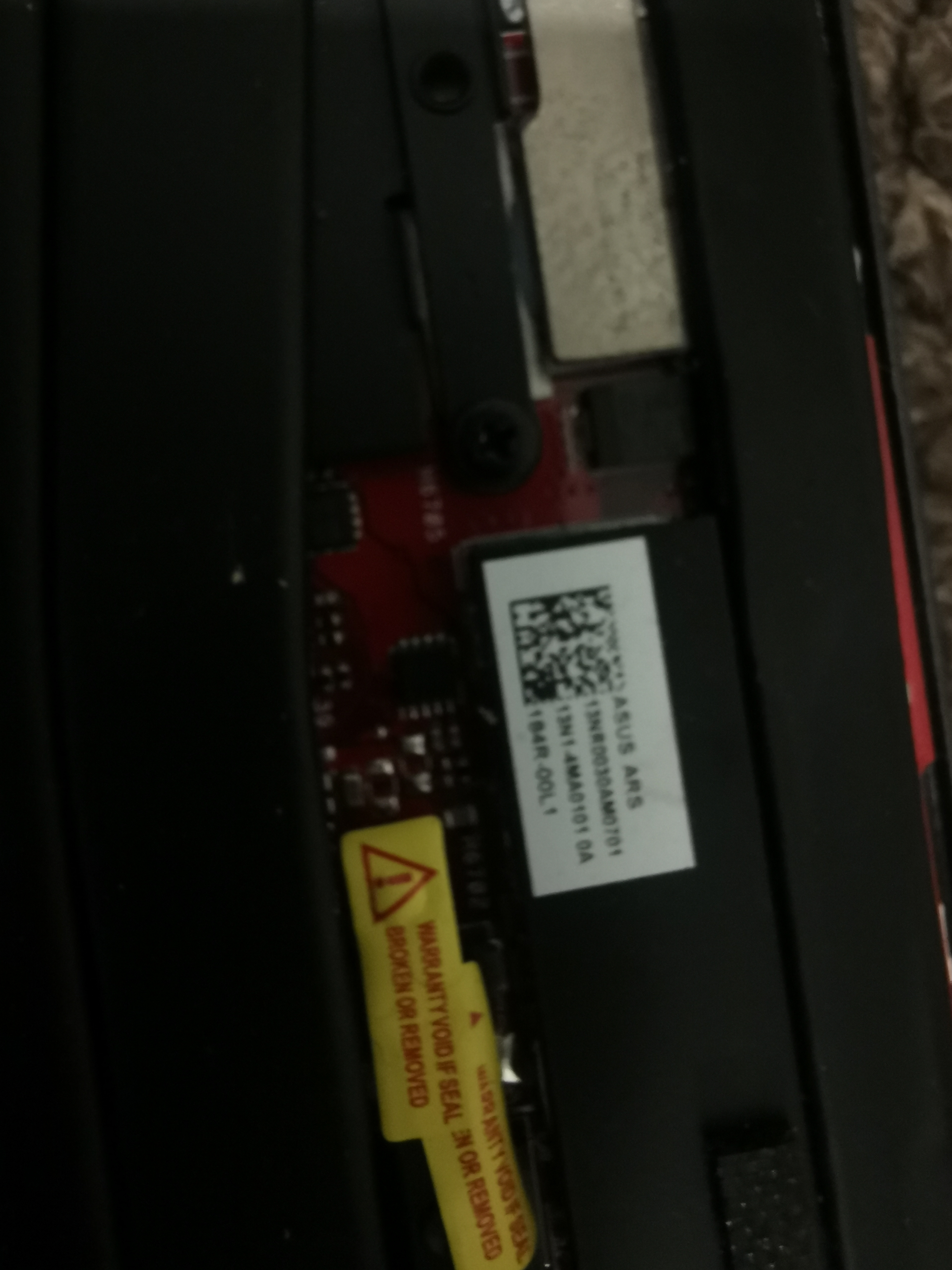

        Take a picture of the QR code and sticker on the RAM slot.
        • Food1244
          • Jun 2025
          • 8
          • United Kingdom
          Attatched is the ram slot sticker
          • Food1244
            • Jun 2025
            • 8
            • United Kingdom
            These are all the stickers
            • hoaca388
              Badcaps
              • Jan 2022
              • 11717
              ROG Zephyrus M_GM501GM
              • Food1244
                • Jun 2025
                • 8
                • United Kingdom
                This worked!! Thank you!!
